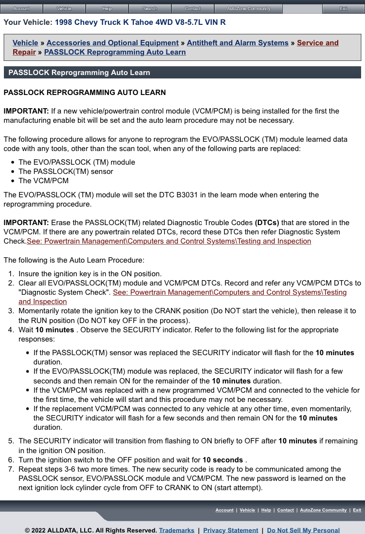

A Tech2 or similar hi end scanner would verify a theft shutdown or correct operation with the corresponding codes. Where do you live? several members here have Tech2's willing to help.
Going by memory here, but I think the Passlock codes are B#### and may require a higher-end scanner to access. I use a knock-off tech2 on mine and know you can get them from it; I don’t think that they were in the same menu hierarchy as the regular P codes. If the Passlock is killing the injectors, it should store a code.
Technically, you’re supposed to clear the codes before trying the relearn, but here’s the procedure in case you don’t have it.
A quick fuel pressure check wouldn’t hurt (spec is 60-66 psi key on engine off) and it should hold within, say, five pounds for a few minutes after turning it off.

...Based on the VATS pdf, it looks like my truck is uses Passlock. I followed the VATS relearning procedure several times with no change.
I always thought PassLock was just the name of that particular version of GM's VATS. "VATS" is just the universal, all-encompassing term used for all of GM's anti-theft systems (PASSKey-1, PASSKey-2, PassLock I, PassLock II, etc.).
If you've ever considered getting this thing tuned, you could have VATS disabled as part of that. You might wanna look into that versus the cost of a replacement module. Get more bang for your buck.
Disabling VATS in the tune would allow the engine to run (assuming this is your problem). But, a fault with VATS might keep the "SECURITY" light illuminated on the cluster. You could just remove the light (LED?) or cut one of the legs if it's soldered to a PCB.

I appreciate the information. I've read the relearn process, but not in that much detail. I've tried it several times with no success. I replaced the fuel pump Saturday so I think I have good fuel pressure, but I'll have a gauge Sunday. I'm starting to understand why none of these threads are ever fully resolved. This is like some crazy snipe hunt. Every time I think I'm on to something the plot twists and the hole gets deeper. I heard back from the guy that rebuilds Passlock modules and he said if it was bad the security light should stay on and mine doesn't. I found a new ignition cylinder that can be keyed to my existing keys, but after talking to them, apparently the cylinder only contains the magnet and the hall effect sensor is in the ignition lock housing. At this point I think I'm going to take a step back and figure out how to test everything else possible before just buying stuff. It's looking like it's actually pretty hard to fully eliminate or bypass the whole Passlock system. I laughed when I read about people actually scrapping otherwise healthy trucks because of this, but I'm starting to get it:cool:.

This is all still pretty confusing to me. I'd never even heard of VATS before your post Monday. I think you're right that all the versions of VATS are sort of under the same umbrella. Even though my system (Passlock) doesn't use a chip or resistor key like PK/2,3, if I'm understanding it correctly, the system shuts off the fuel injectors until the ignition switch tells the system it's been turned has been turned by a real key. I saw that the system could be turned off in a tune. I don't actually need it tuned for what I do, but who are some recommended tuners and what does it typically cost? I guess before I look into that option I want to be sure my ignition switch is sending good key information to the rest of the system. Thankfully I don't have to drive it right now so I can afford to take a step back and do more testing before waste more money on things that may not be the problem. I really appreciate all the suggestions and feedback.
