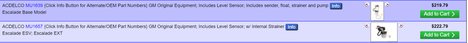

Looking on rockauto, there's 2 ACdelco pumps.

That shouldn't matter as long as it's for the correct year and motor? Right?
52,949
It must matter or there would only be one part. Of course, if you’d rather order the one for a different model than yours and wait until your tank is out before finding out if it works or not go ahead. Not trying to sound like an ass but there is no reason to order the wrong part for your rig when it’s basically the same price. If a part is listed as application specific, there’s always a reason. No use taking chances.

Helped a buddy do his barn door GMC fuel pump. He used a local part house special. It was dead in a year. It was a Cali truck so straps were ok. Time consuming if it’s your 1st go at it and you deff want an empty tank.
Use the oe pump or you’ll be doing it 2x. Don’t use a pump that your trucks not spec’d for. The tanks ARE different by volume and especially height. You don’t want a fuel float designed for a higher/lower tank or one that can flop around because it’s too short to press on the bottom of the tank.
