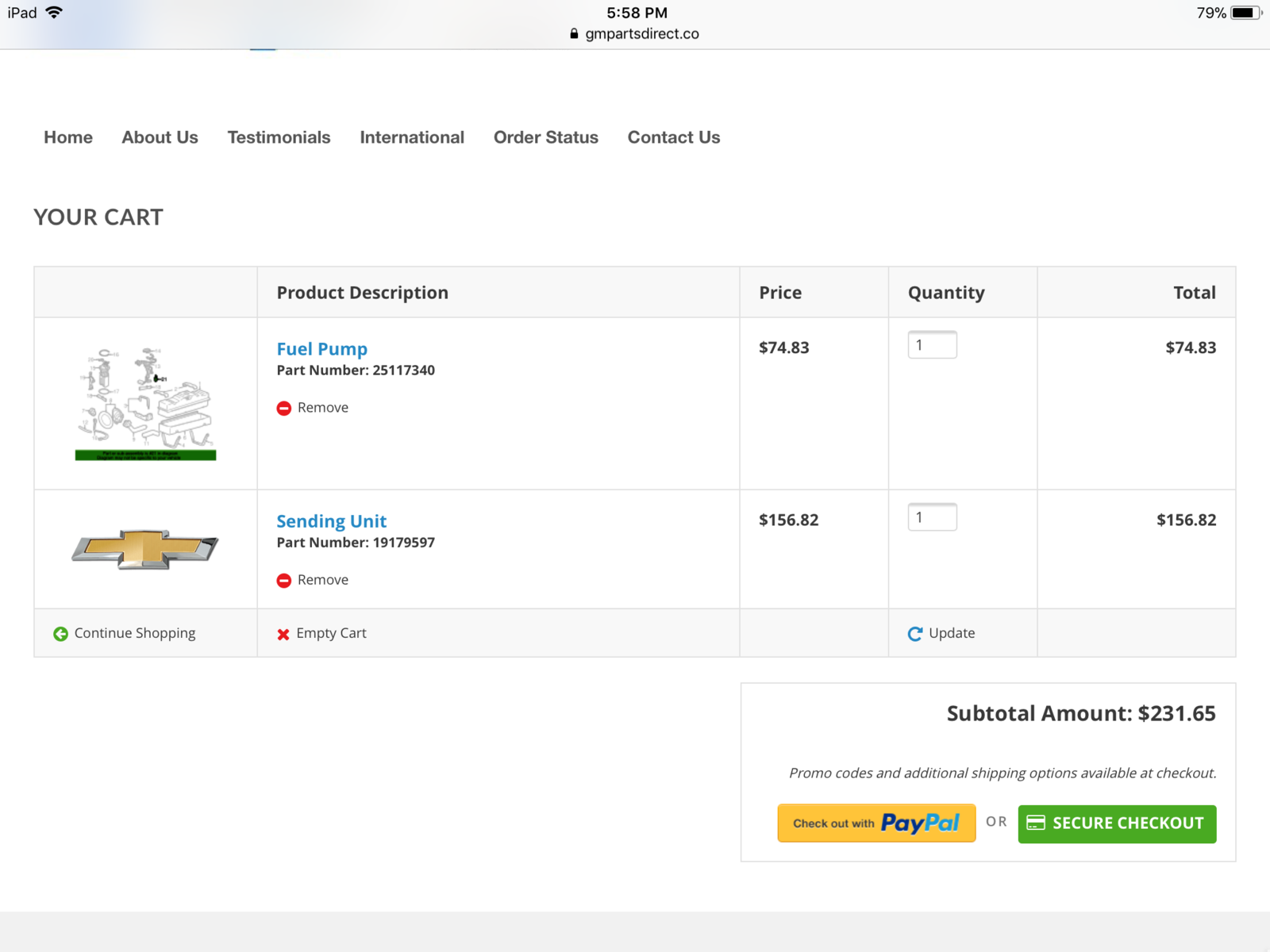

Depends on your situation when you see the prices for an OEM pump you may consider an auto store pump. People do buy them and they get some years out of them.
Ha! Yes, definitely. $300 does make one want to look for alternatives.
