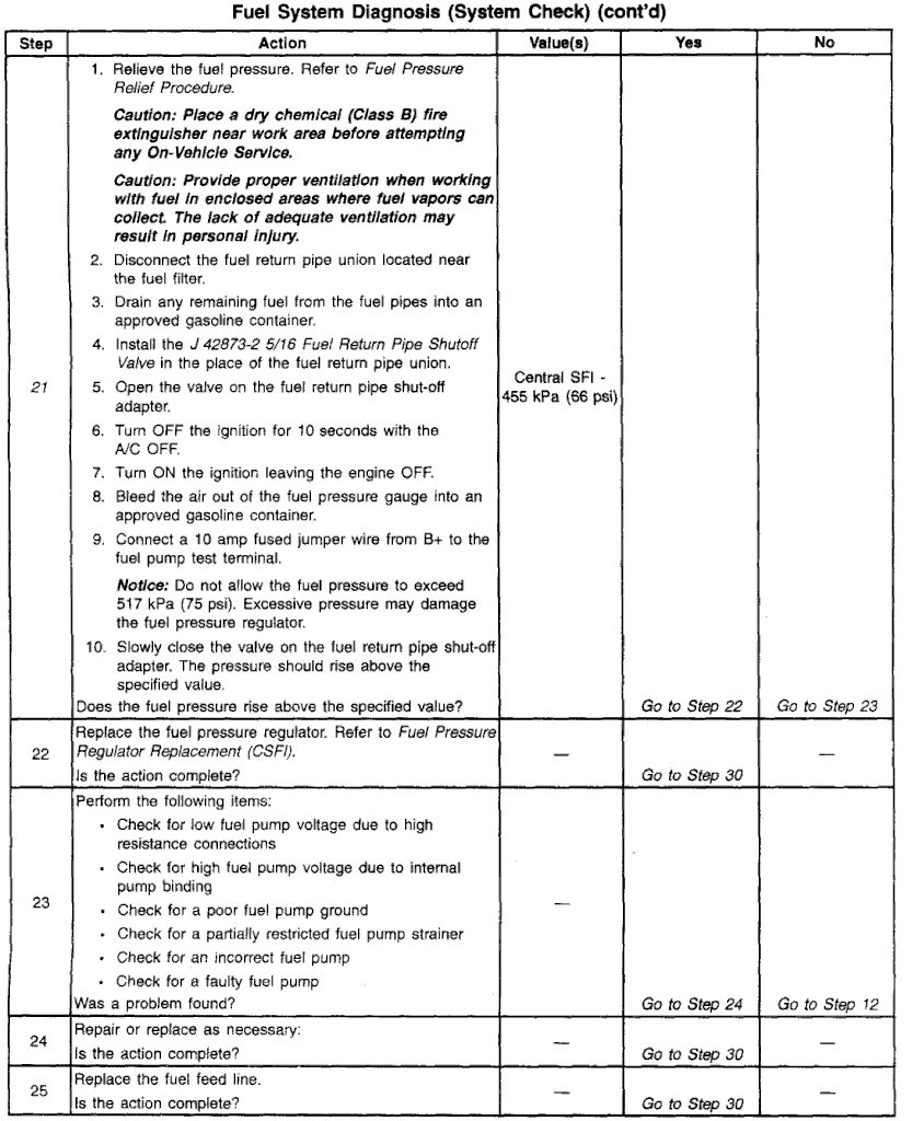

Hi All,
It's been awhile since I've come back to this, but the truck has been running fine since I worked on it last year.
...That is until today.
Cranks, but no start. Cannot hear fuel pump whine at key-on...no fuel pressure. I think it finally gave up the ghost. The fuel pump relay checks out on the bench, and the terminals in the fuse box are all getting power when they need it. Fuse is fine. I can tap on the tank, but can't get it to start humming. I think it's all hummed-out. Not feeling the love.
Overall, not a bad life for what I think is a stock pump (more than 146k), so I'm going to start the hunt for a new one.
My question...what's the favorite brand of replacement? Should I pony up for an OEM, or is there an aftermarket pump out there that is giving good service? I've heard Airtex, along with many of the brands sold at AutoZone, O'Reilly, and other places are junk and to avoid them.
Thanks!

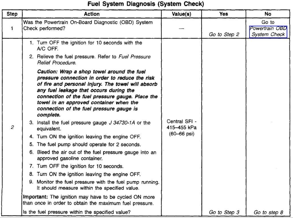

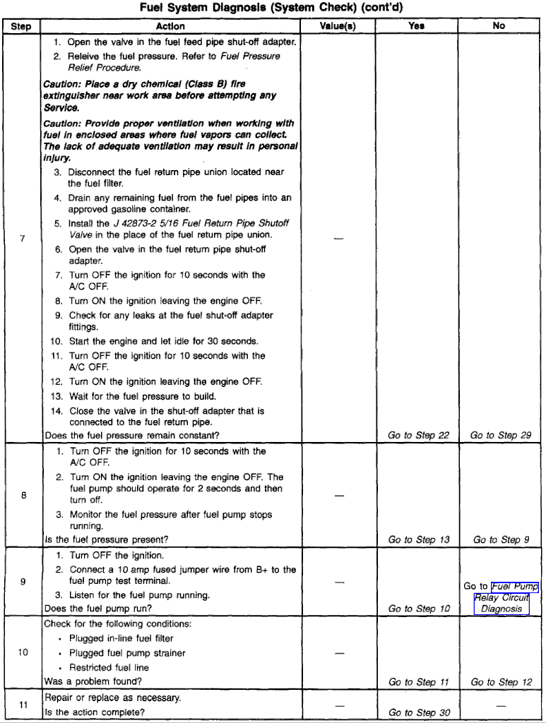

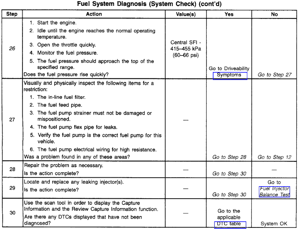

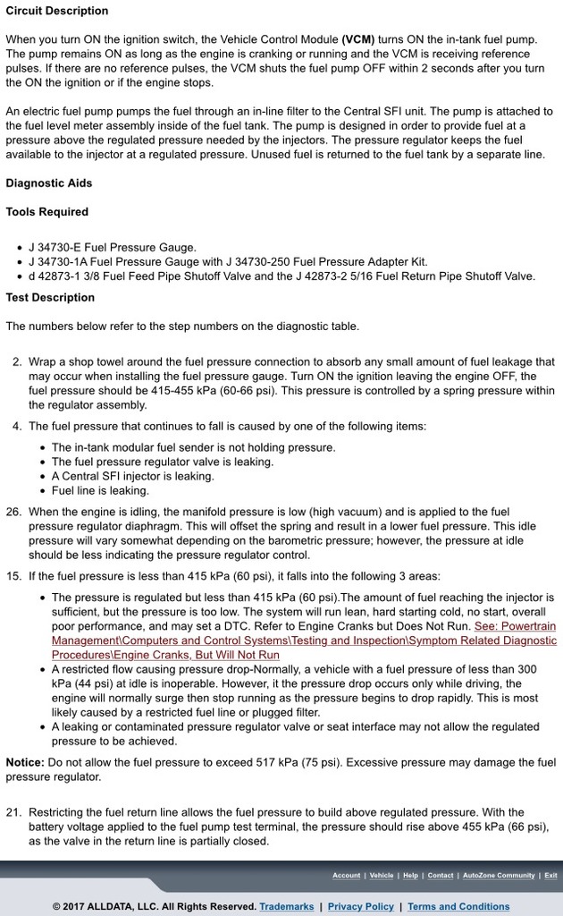

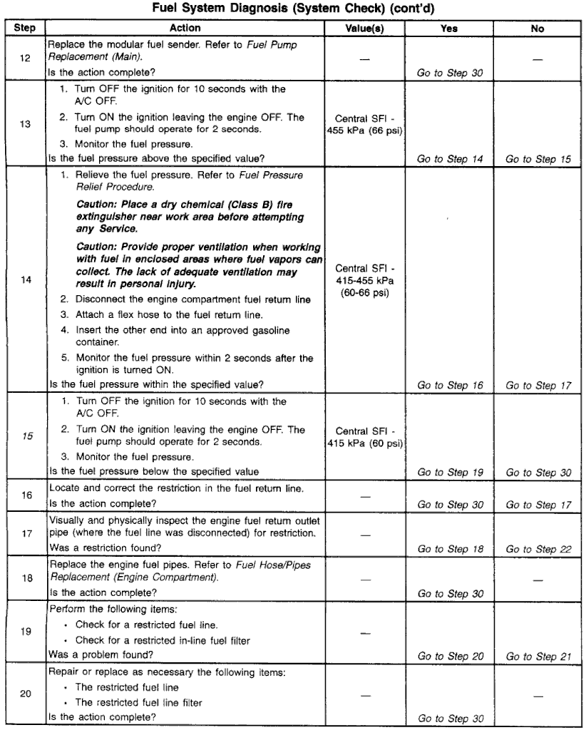

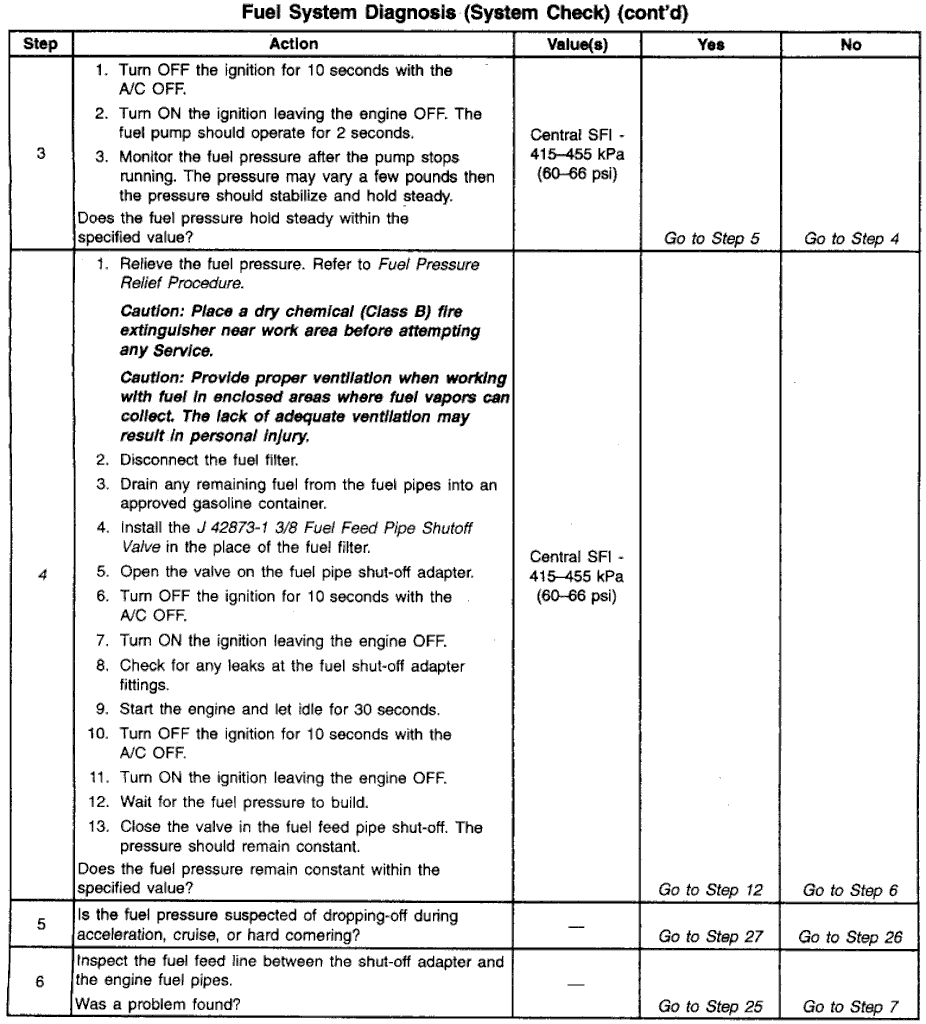

Hey All,
I think I'm going to have a little time to chisel on this problem this weekend.
I probably won't have enough time to drop the tank, but may have enough to pop the upper intake and have a look. Still, that's a major pain, so I'm thinking of some other tests I can run before I get extreme. I'm planning to look at the plugs, the cap and rotor, and check for vacuum leaks. I might even grab the pressure gauge and do another leak-down just to verify what I saw the first time.
I've read that a vacuum leak can cause the fuel pressure regulator to misbehave, and cause the engine to run rich. If I have a vacuum leak, it's not severe enough to make it run super bad (yet). Not throwing codes or mis-firing. Seems to run OK. Still gets around 15 mpg, so mileage hasn't suffered much. Occasionally idles a little rough if I've been driving on the highway and stop at a light, but then seems to straighten out, sometimes by the next stop light.
I'm still running rich, though. Sooty coating on the inside of my tailpipe. I can clean it out, and it's back in a few days. I can smell the richness in the exhaust, and I'm thinking I'm going to end up trashing my catalytic converter(s) if I let this continue.
I can also smell gas in the intake plenum when I remove the air intake and sniff down in the throttle. I did a quick leak-down test, but pressure stays solid when engine is killed, so is it possible that the gas smell could be a by-product of a vacuum leak somewhere? Also, is it possible for a fuel pressure regulator to 'sort of' fail? Meaning it would not leak down quickly, but could still be leaking enough fuel in the intake to cause the engine to run rich, but not rich enough to throw codes?
I'm thinking I need to attack this 'rich' issue before worrying too much about the fuel pump.
I'm in that weird no-man's-land where the truck isn't really running all that bad, but I know something is wrong.
Any more ideas?
Thanks folks!
