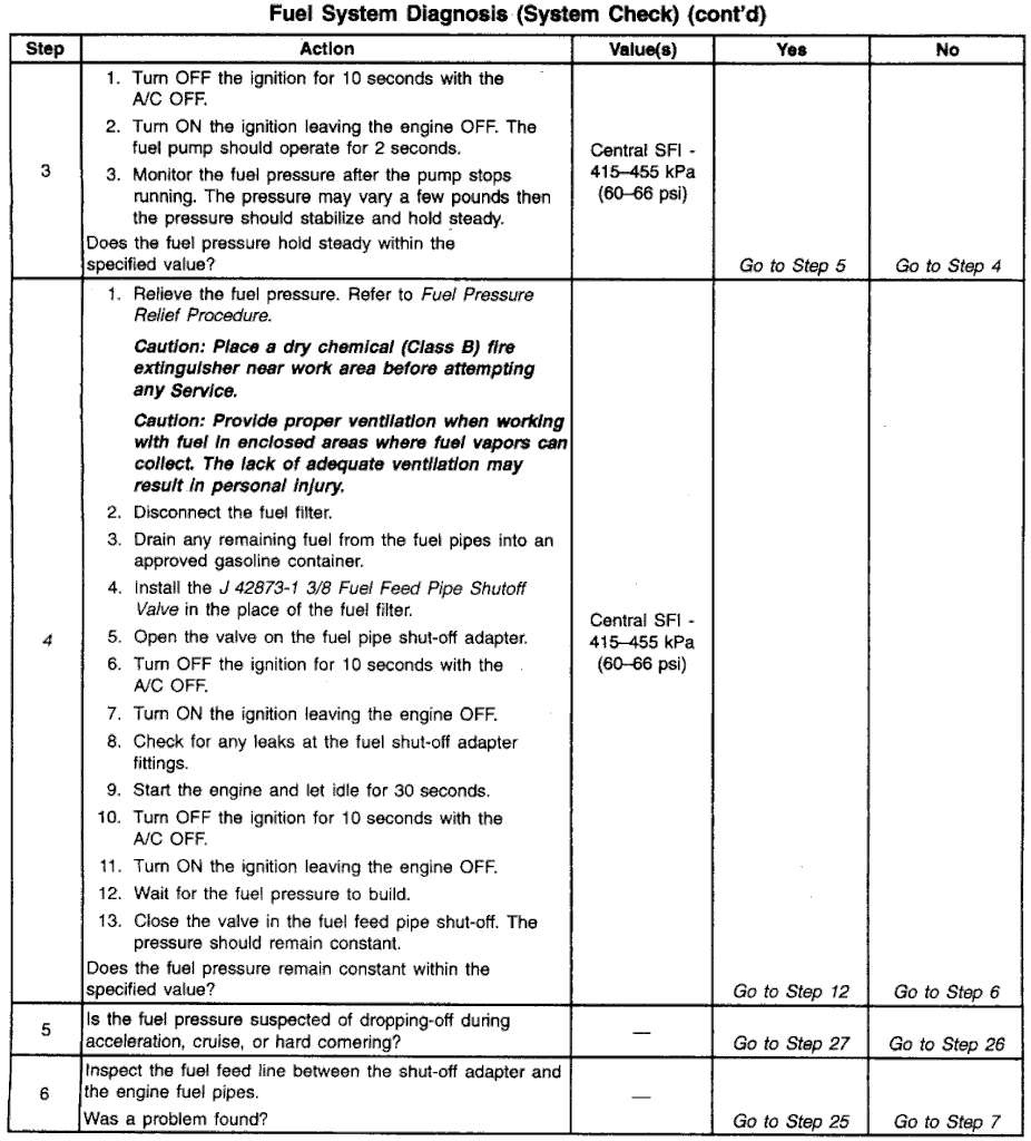

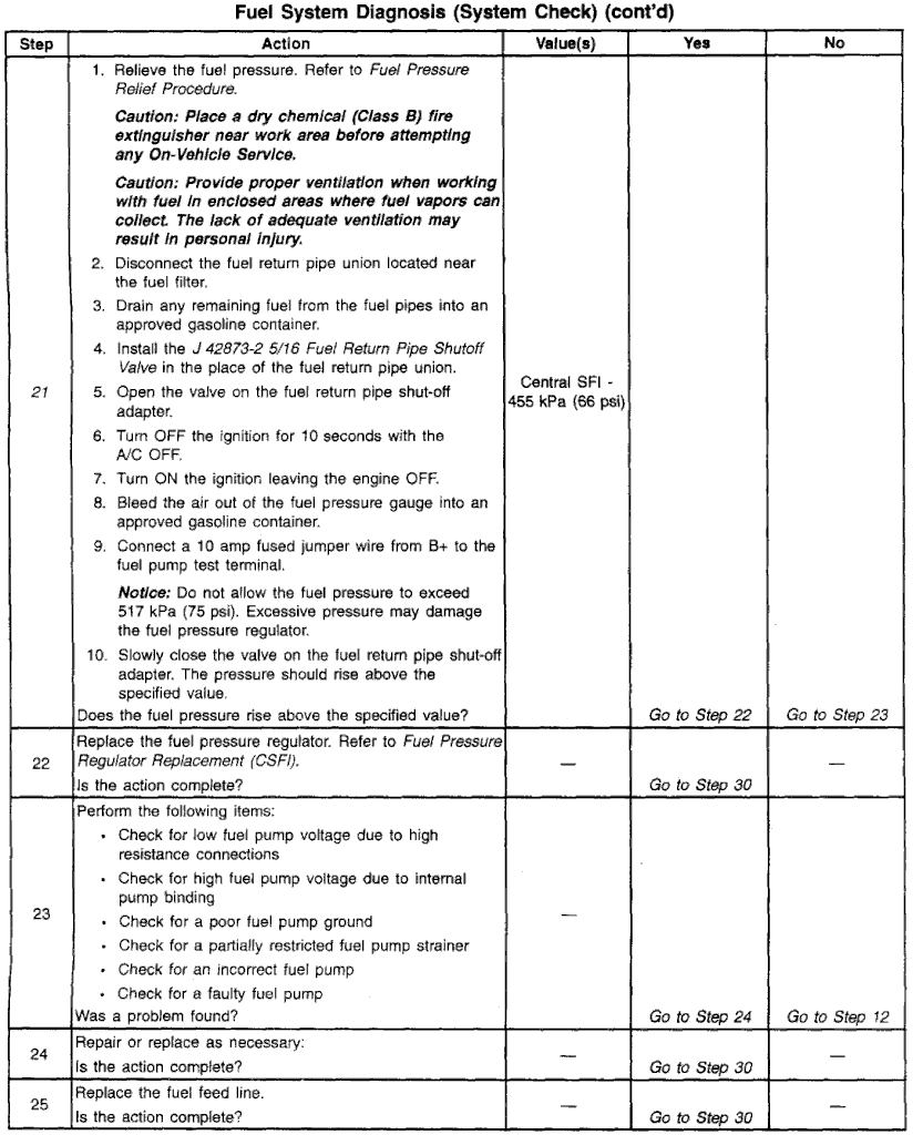

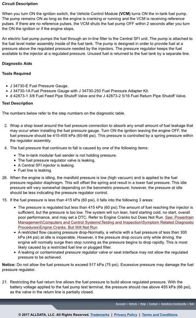

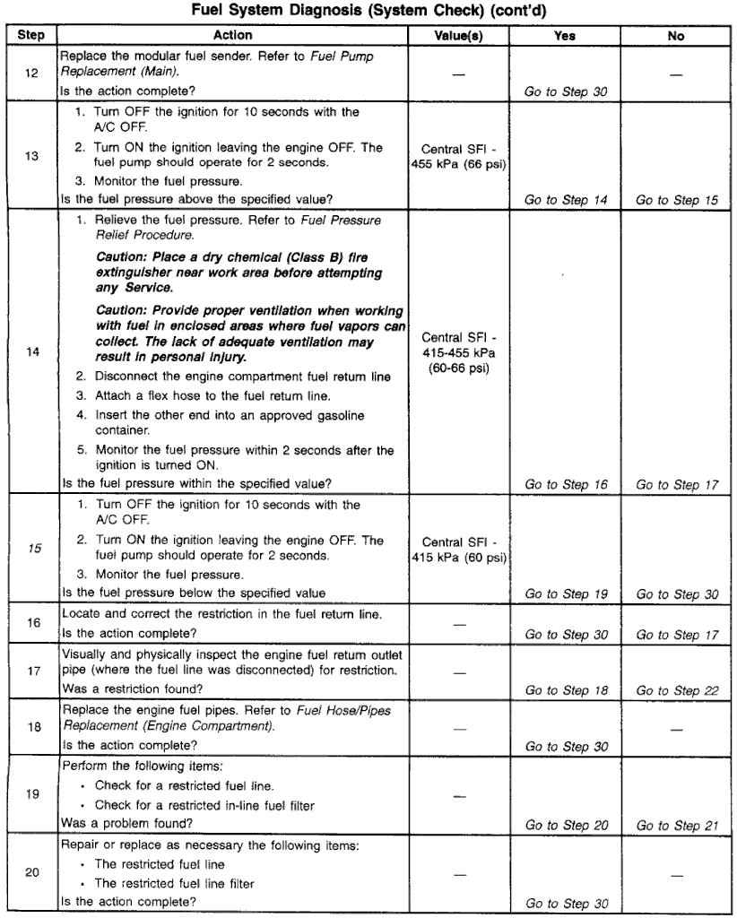

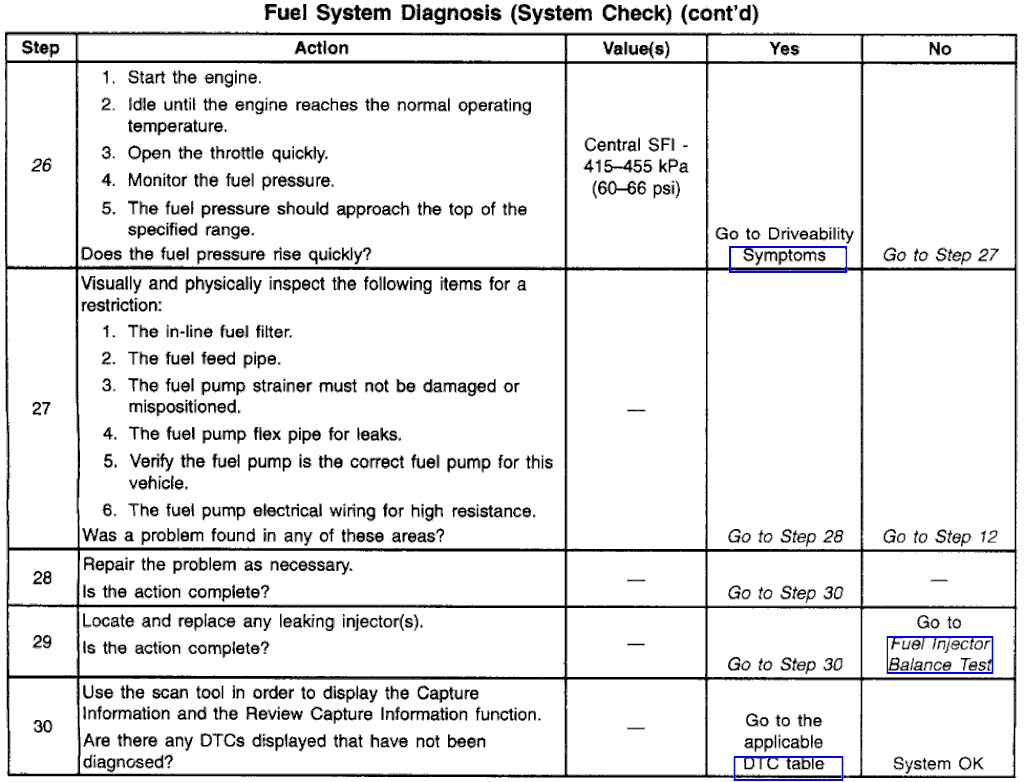

The specs are for it to be higher, so it could be a restriction causing the pressure drop. Aside from replacing the fuel filter, there are ways to check the pressure closer to the pump but you'd probably need to install a temporary isolation valve and gauge fitting.
I have the factory test procedure if you'd like it.
Hi east302, yeah, I'd like to see that procedure! Thanks for sharing
