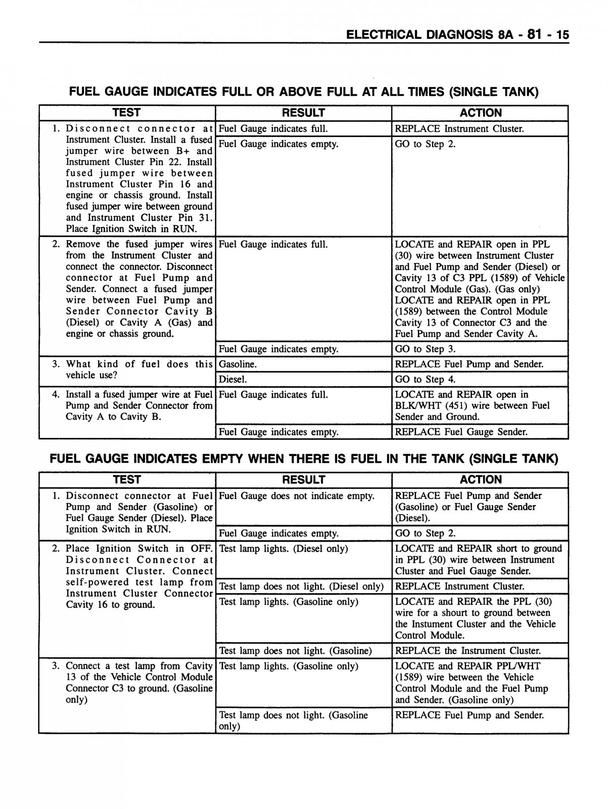

My fuel gauge in my 2-door 1999 Tahoe stopped working. I reads full no matter what. I am quite sure it is the gauge because I just replaced the fuel pump / sender unit a couple of years ago with a high quality Napa unit. And when I slam the door, sometimes it will read correctly briefly.
I have searched multiple sites and cannot find a replacement gauge (preferably OEM GM) for sale. Anybody else had this problem? I think it's silly to replace the entire gauge cluster.

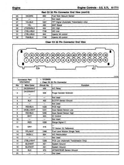

GM diagnostic table for 1998, probably same for 1999:
