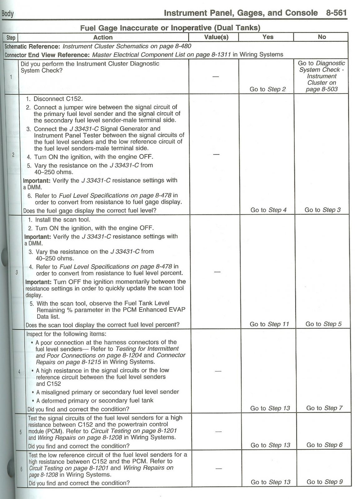

Late reading this. Would this help?

Here's some more info. Not sure if same on '99 model but this info is out of my 2004 shop manual.
This tells you what wire and where to find it to check. Let us know what you did or found out.
