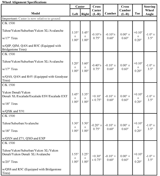

I recently noticed that the tops of my front tires lean in, is this normal for the NNBS suspension? Before the new tires, it was more pronounced but seems less with the new tires. I plan on setting up an alignment check because I noticed the most extreme inside edge of my front tires were worn more than the rest of the tread. Just was curious how much negative camber we are supposed to have. The Tahoe doesn't pull and it tracks straight when I let go of the wheel. Steering still seems tight. I just do not want to be bullsh*tted when I go in.
45,011
You shouldn't have enough camber that you can see. It's obviously too much since the tires are wearing unevenly. An alignment is needed, but can't be properly done if you have worn bushings and/or ball joints.
