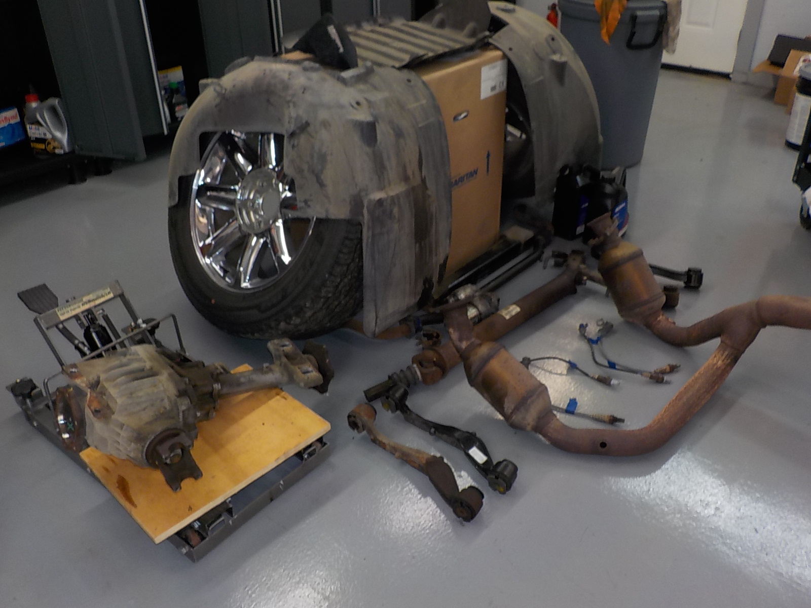

Today I'm doing the frt differential mounts, engine mounts, and tranny mount. Wish me luck.

I have a lift in my garage.
I'm adding to this project: both knock sensors, all 4 O2 sensors, tranny filter and fluid change. I'll send atf sample to a lab for analysis. 40k+ miles and 3+ yrs on the Dexron VI and filter that's coming out.
Today, took the front wheels off, inner fender liners out, sway bar out, front driveshaft out, O2 sensors out, cross member out, exhaust Y lose.
I'll get back at it tomorrow. I have all the mounts, lab test kit, tranny atf, and filter here. The rest of the parts will be here in a couple of days.

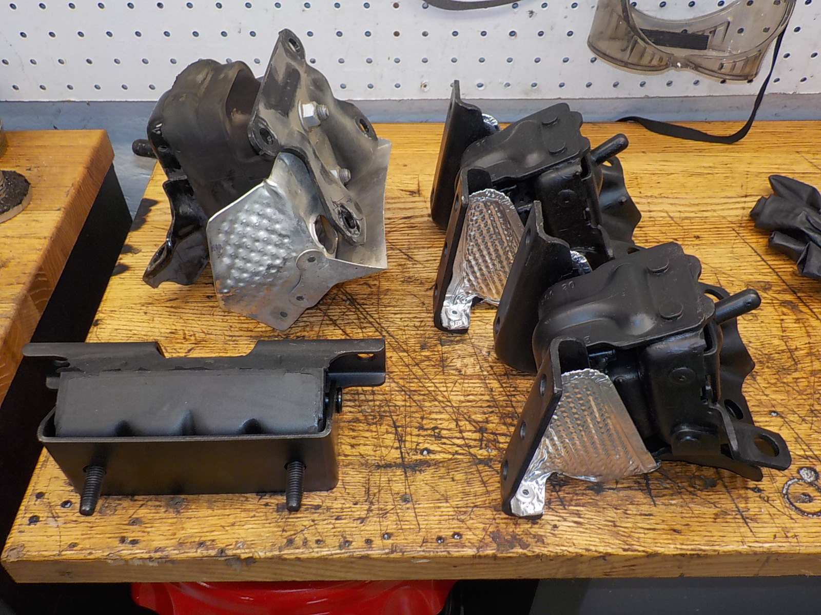

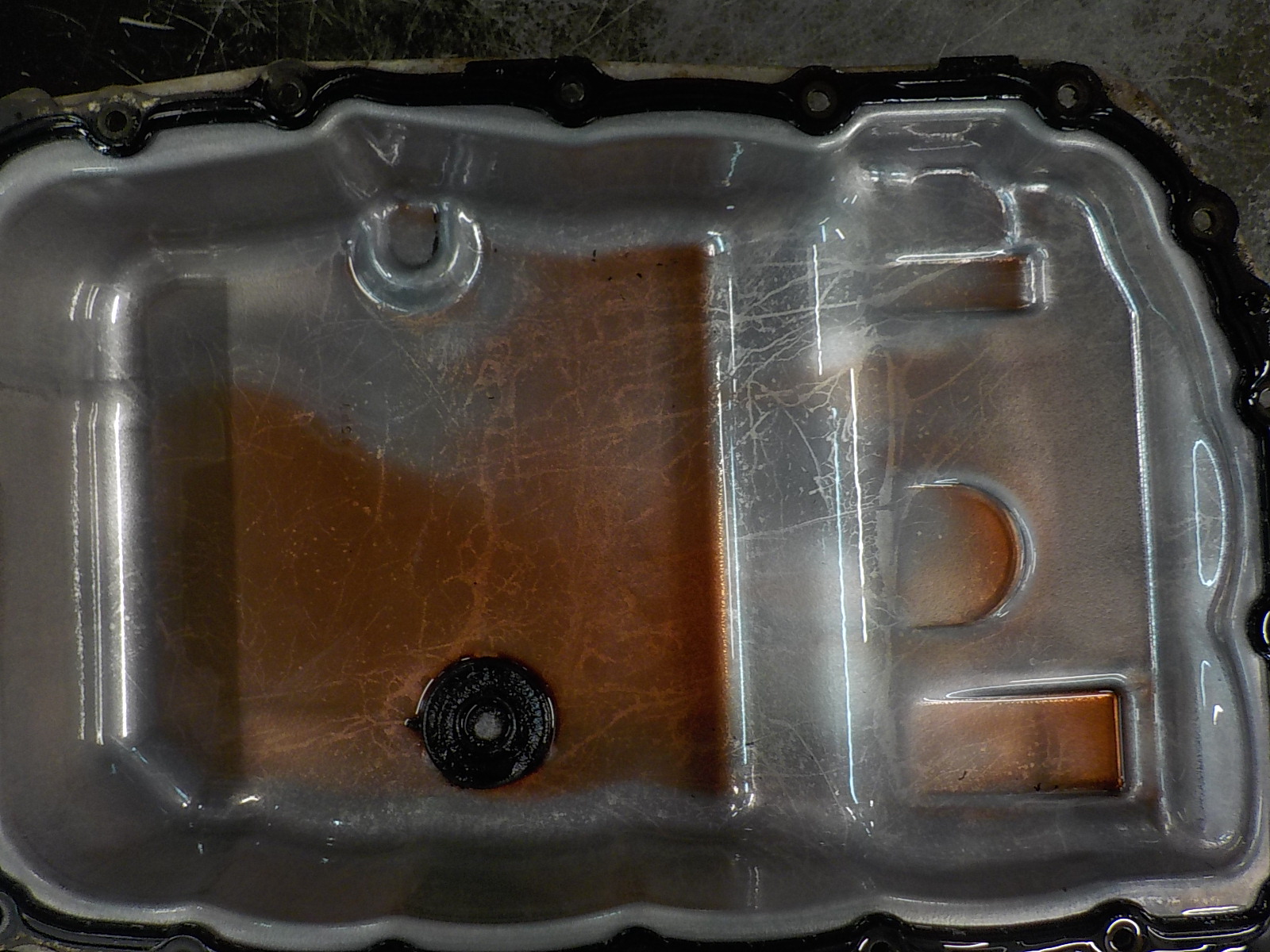

Took the tranny pan off. Cleaned the magnet. Fluid and magnet didn't look bad for 43k miles. That was the last time I had the pan off. Installed the new filter and reinstalled the pan using the ole gasket again.
Took the front differential out and removed the ole differential brackets.

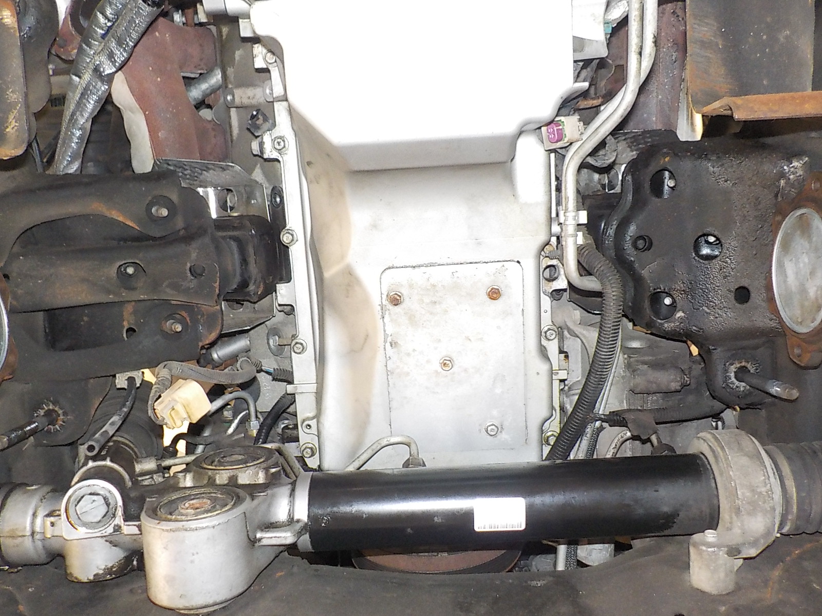

Removed ole driver side engine mount. I didn't have to remove the steering shaft. I did have to remove the knock sensor I'm changing it anyway. Removed the 3 bolts that hold the mount to the frame from above. Removed the 4 bolts that hold it to the block from below. Came out the bottom. Remember I have the exhaust y piple out. Installed new H3 engine mount.
Removed the ole pass side mount. Removed the 3 bolts that hold the mount to the frame from inside the wheel well. Starter and inner ww liner were removed yesterday. Removed the 4 bolts that hold the mount to the block from below. Mount wouldn't come out until I took the mount apart. Set the new H3 mount in place and will bolt'er in tomorrow.

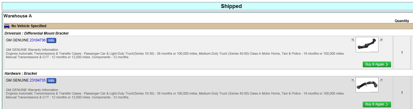

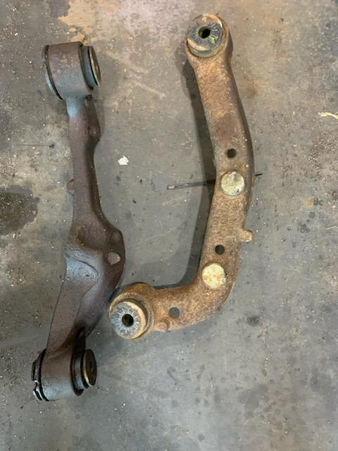

I’ll tag on a little more to the front diff mounts band wagon for those of us with AWD Esky & Denali (All 07/08 mostly all 09-14) and 4WD.
There’s a left & right side diff mount. Pics and part numbers are below from other attached posts. The MOOG are identical to the OEM but only about $50 ea (rock auto) vs $199. Both already have new bushings pressed in.

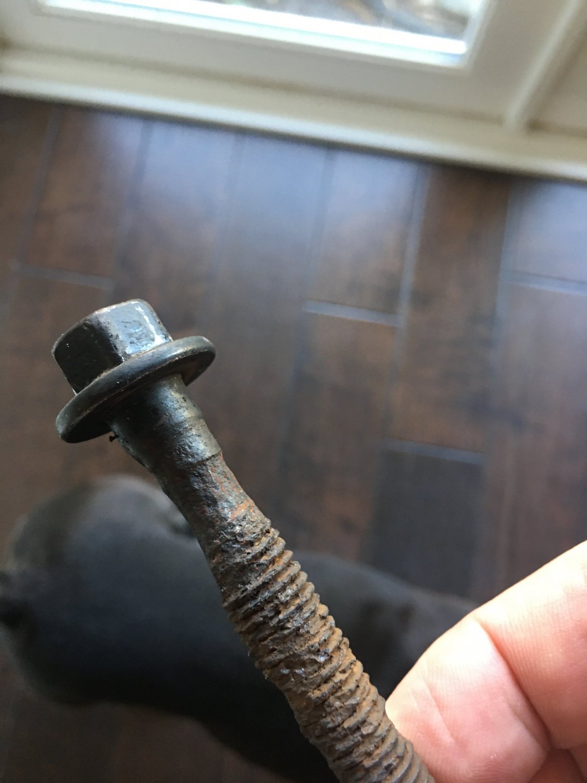

Here’s another pic of a bolt used to attach the front diff mount that runs through the bushing on the end of the mount. When my front diff mounts/bushings were replaced one mount bolt was literally worn down. The play between the worn bushing and its collar make a clunk and eventually would of worn the bolt through.

Good info. I just looked them up on RockAuto for my 2012 and the Moog parts are about $36 each. I'm not finding a part # for the replacement bolts though.
Moog Part #'s that cross reference to the GM #'s you posted
Left RK643171
Right RK643170
