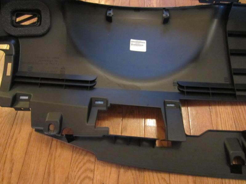

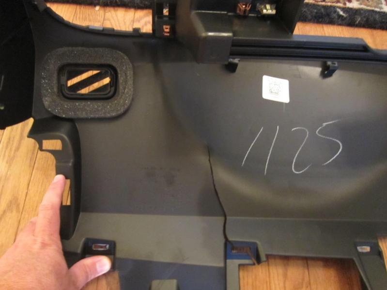

GM definitely knows about the problems and has redesigned the dashes. If you get yours replaced, insist on the redesigned reinforced ones or you'll be in the same boat later.
