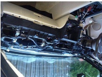

Well, I've been lurking for awhile and finally registered. After trying to ignore it for a year, I finally ordered a replacement dash from my local dealer. Took about an hour to take the old one out and about two hours to put the new one in (taking my time). Tedious, but easy job with just a few tools. After taking it out, I know that a surface repair would not have lasted. the cracks went all the way down to the mounting bolts. I have to imagine over-torqued bolts could have been partially to blame. The new one looks great - no more rattling and squeaking, and luckily, everything still works! While I didn't take many pics, I can put together a simple how-to list. But, if I could do it - you can. All the wiring is easy to undo/reconnect properly and many of the screws are the same size - no worries.

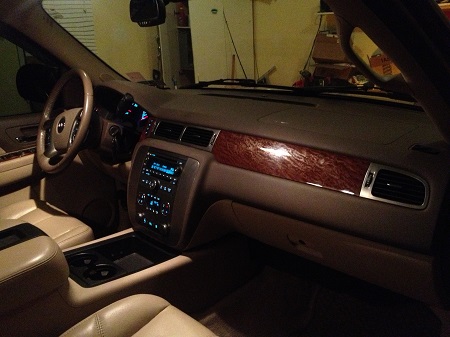

I had knocked my dash dimmer switch with my knee some time ago and had the a/c controls with the labeling rubbed off, so I replaced those while I had everything apart. I also replaced the ambient light sensor for the headlights (in the upper dash panel), which took about two seconds. My old one was not working properly and my lights usually turned on even when it was bright outside - works like it should now. I ordered AC/Delco parts for those via Amazon. It took me about an hour to pull the old one out and about 2 hours to put the new one in. It is amazing how quiet it seems now - no more rattling/squeaking dash.
I attached a few pics to show before/after.
