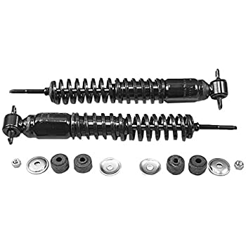

I checked out both JD and Atomic. Atomic is closer to what I’m looking for but not for almost a thousand bucks. I found a similar set of coil over shocks from Monroe for around $90 a pair that go on the rear of another vehicle but I could very easily build an adapter for my lower shock mount and put them under the front of my Yukon. I just didn’t know if anyone knew of a direct bolt on or had done something like that before. I’m wanting to keep my torsion bars and just add the load assist shocks to the front to give it just a little more stiffness and stability and maybe just a little bit of lift.

41E5CB1E-7D43-4C80-8C7A-D291DB6DCF11.png 8BEF84B2-5ADF-43EB-8665-1989000EC1BA.jpeg These are the ones I found. The measurements are almost a perfect match for the front shocks and the upper shock mount is the same. A small bracket would have to be built for the lower one though, but aside from that, they should be a direct fit.8BEF84B2-5ADF-43EB-8665-1989000EC1BA.jpeg
here’s what the factory ones look like

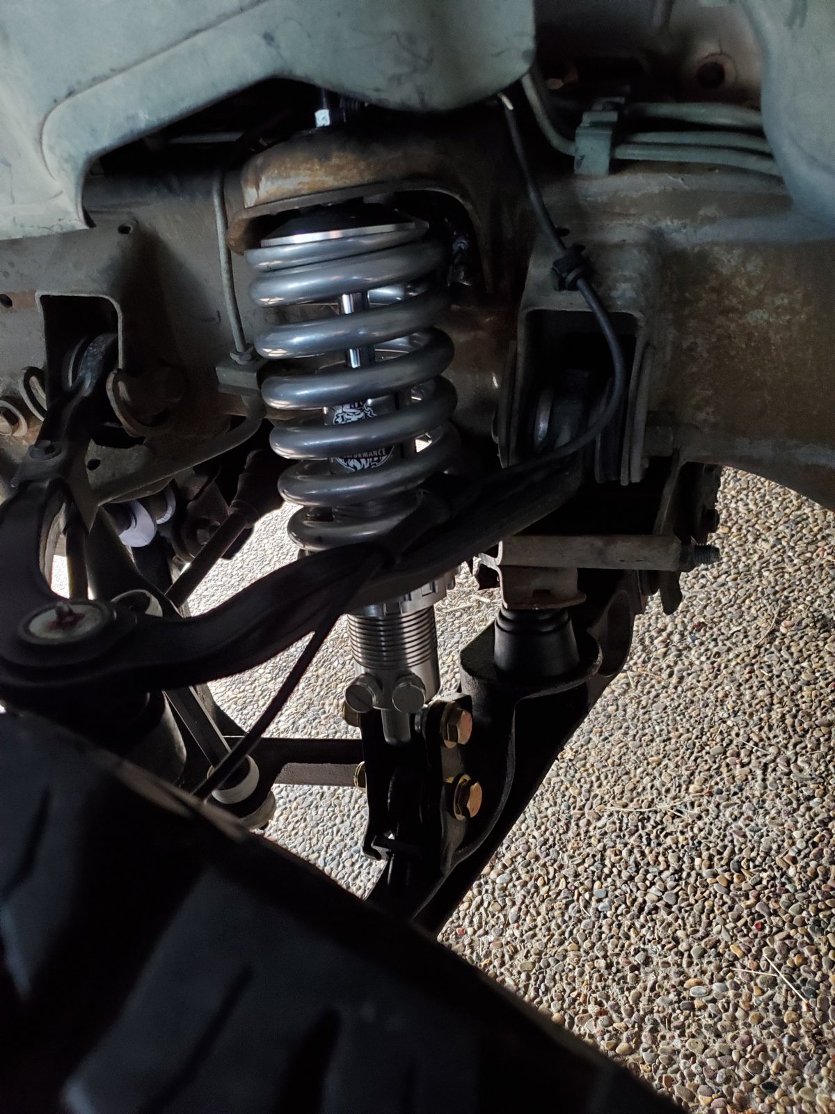

Right now i have these in the front of my 01 tahoe with z71 coil springs in back. very stiff ride great on highway travel but when doing about 30-55 you can feel a little bounce in the front. Ive messed with the rebound and compression rates since they are adjustable but a lot of bad roads where i live (south Texas) so needless to say im going back to torsion bars. if you interested in these let me know they are atomicfab coilover conversion for 01-06 tahoes/yukon, suburban/xl. if not theyll just sit here lol
