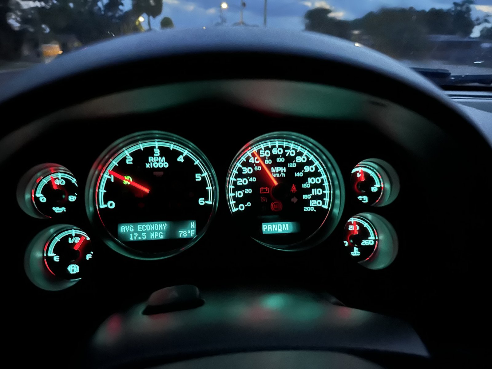

Managed 17.5mpg on the way up and 16.8mpg on the way back after driving around town. Nobody complains about the comfort and ride and with the girls, there is crap everywhere at the end, so a thorough cleaning was needed and the love bugs took some extra time to remove.

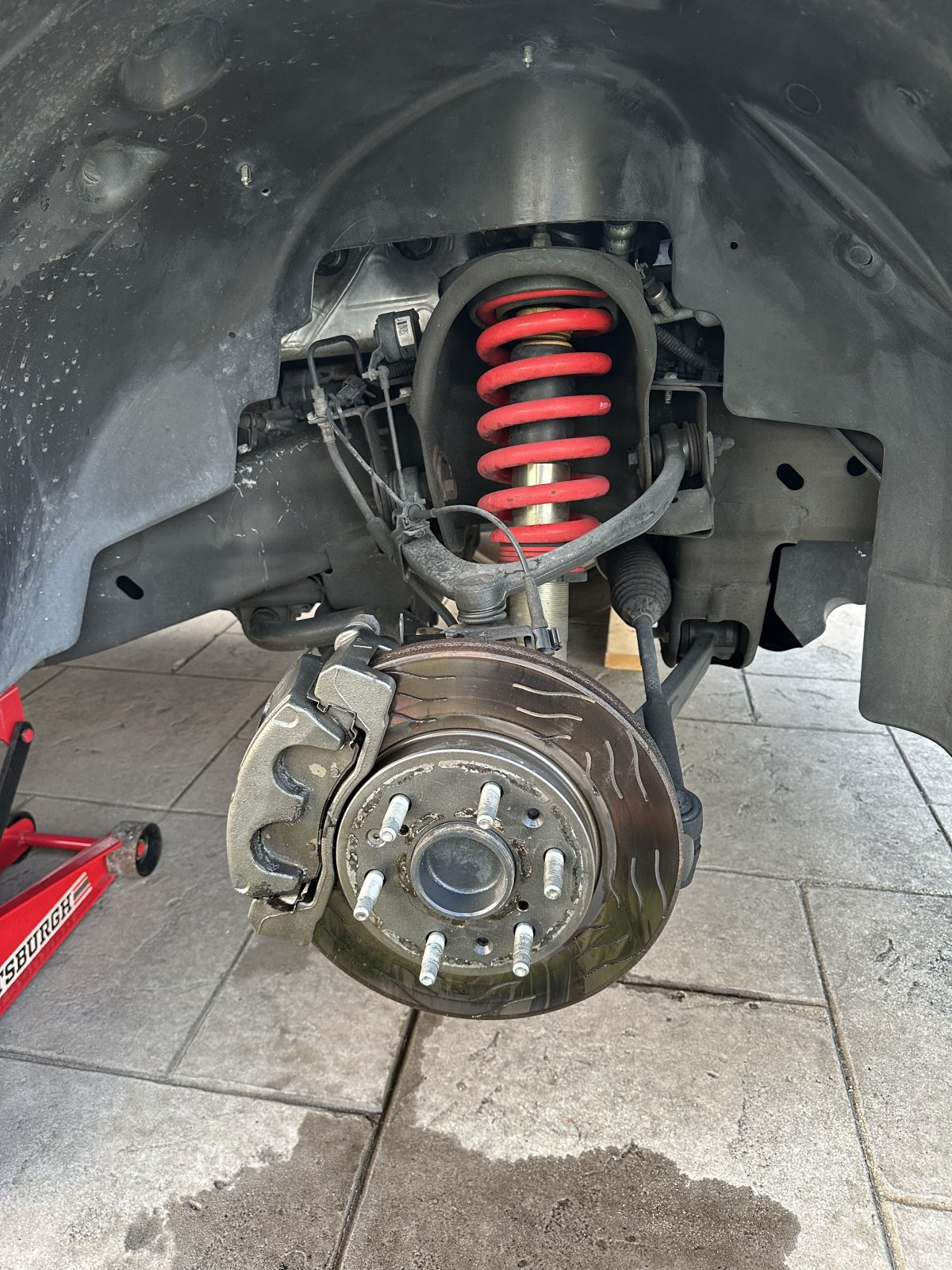

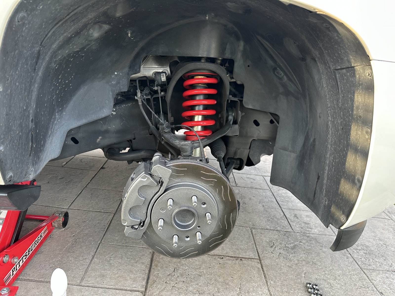

I pulled all the tires and freshened up the rotors and calipers with some new paint and cleaned up the coilovers while I was there too. With all the rain, they are dirty again, but it looked nice for the photo in RED!

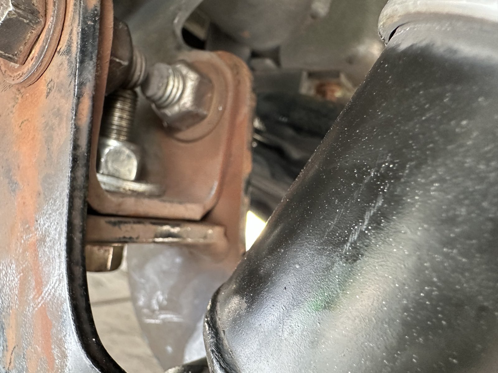

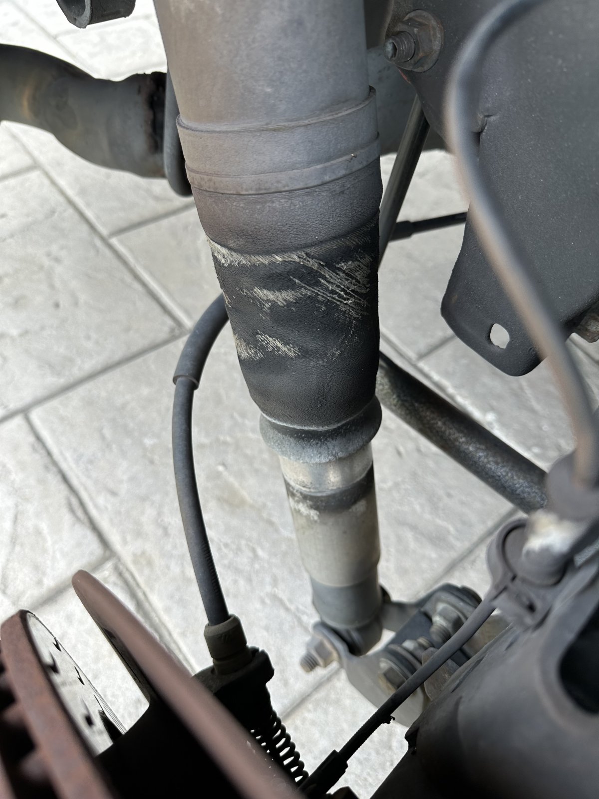

Found some wear on the rear shocks but could not see/find why the I still had some clunking from the rear suspension. Dropped it off at the shop for an oil change (report attached above), so my buddy gave it another solid look over on the lift and found that the drop shackle on the drivers side had a piece missing, thus allowing it to be not in the correct position and smacking against something else underneath. All this wear must have been attested to the wrong position of the drop shackle.
When you look at the picture of the drop shackle and the center section, something had worked its way loose or broken off, so he inserted a thick washer and bolted it back together. The clunking and noisy sounds going over bumps seems to have abated and the ride is much better.

That odd drop shackle issue also put some wear on the inner side of the drivers tires, both front and back. Perfect timing as they were on the wear indicator and it was time for some new rubber with the rainy season, hot summer temps and the wife driving it more. No need to have her with too little tread on the open road.

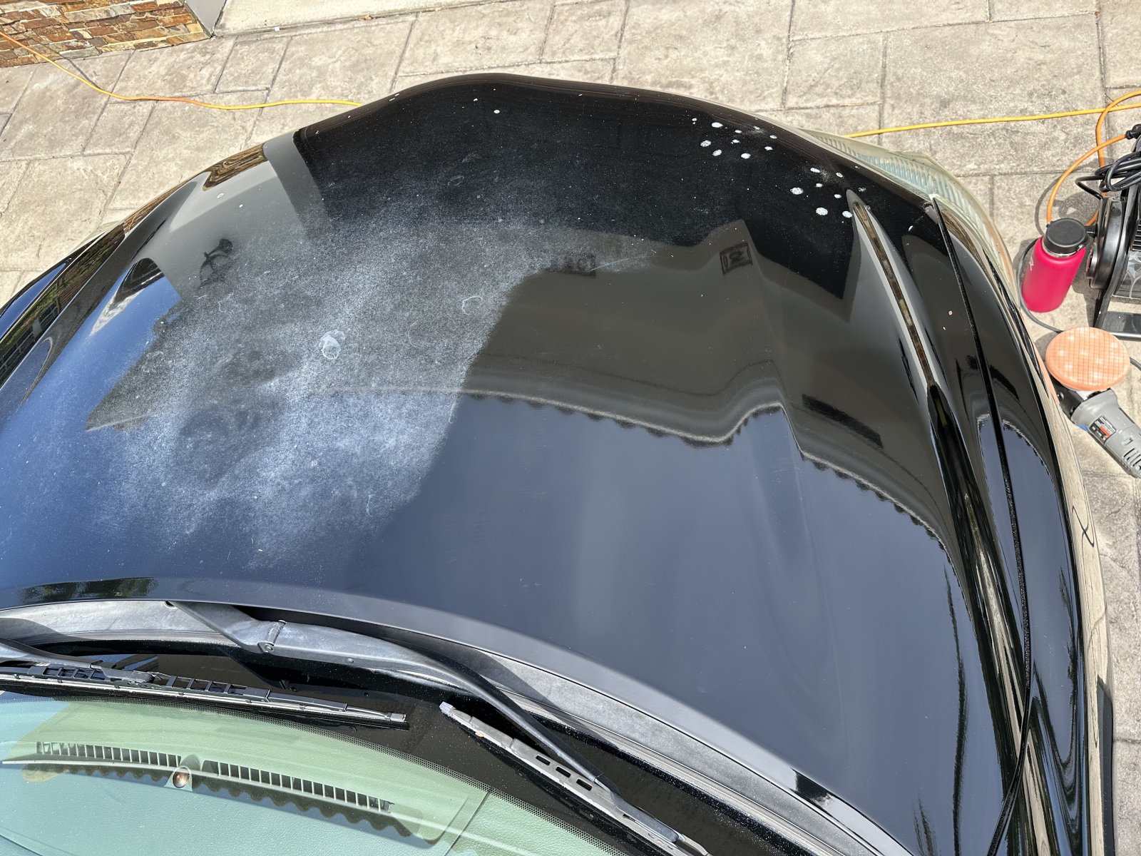

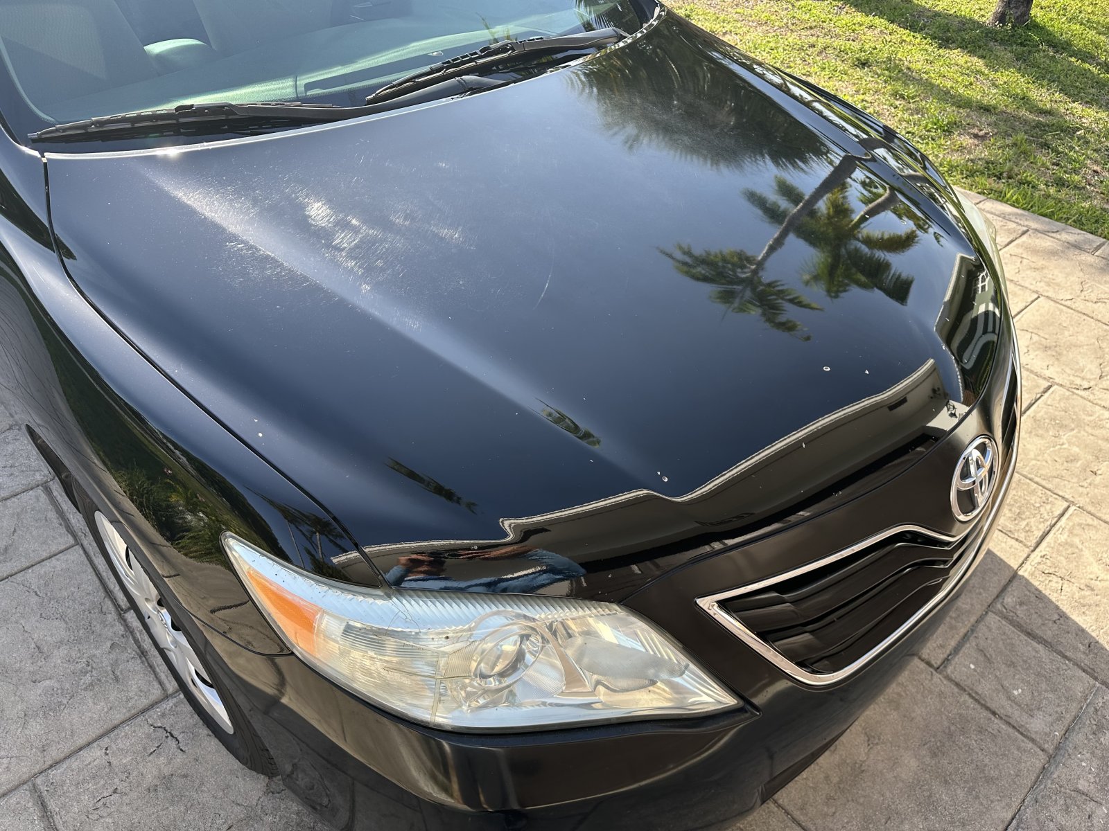

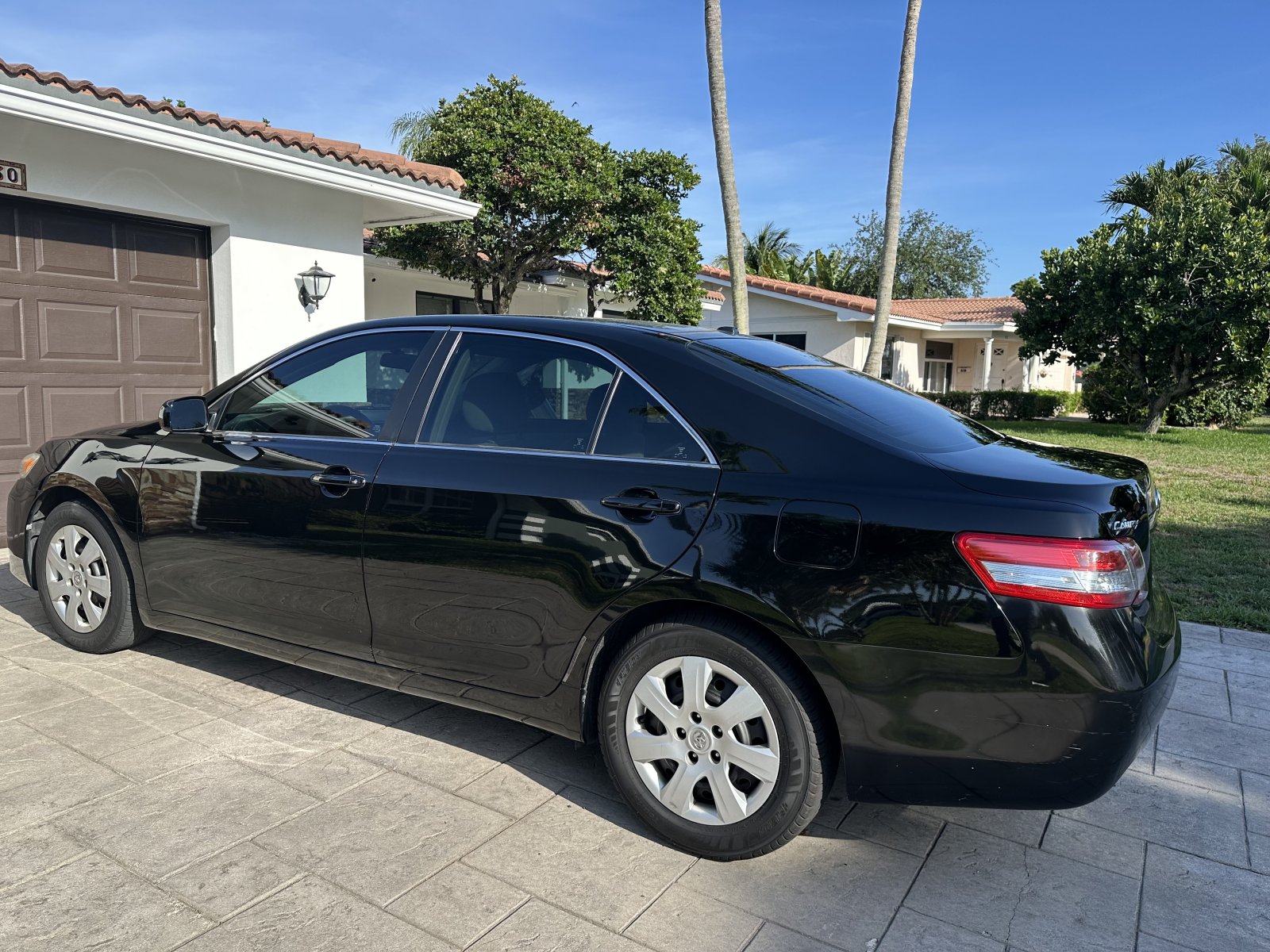

I put in some polish wheel time on my son's Camry one weekend after the lacrosse games. Set up the 10x10 shade tent as it was clear as a bell and hot and humid AF. Gave it an iron decon, wash and clay bar to be ready for some polish.
Now the roof is faded beyond polishing out, the hood is a bit better (may come back, but looks pretty good) and the trunk lid is a bit better still. The sides had plenty of fine line scratches from age, dirt and improper or no washing, etc...
My goal was to get the rest of the big panels cleaned up with some Meguairs Ultra Compound and coarse pad, step up with some Chemical Guys polish and then top coat it for some protection and water beading. My son is not as much into the cleaning and detailing as I am, no matter how many times I have tried to influence him. And knowing that the car will sit a lot at college or just not get it cleaned either. Especially after the 4 hours drive to get there.
I worked my way around the car, cutting and polishing, with the black popping pretty good. I was able to cut a bit of the hood (has some dime size chips to the metal), but not sure how long it will last and even more shine on the trunk lid after a polish and coat.
Something good to say about that 2010 paint and clear coat. The weird thing is the front and rear bumpers are a different shade of black (and plastic) and the paint reacted different to the polishing. Hopefully holds ok. The front bumper has some road rash but the grille polished up pretty good.
Alas, I was happy with the outcome and way better than when I started. Gave it a good vacuum and interior wipe down.

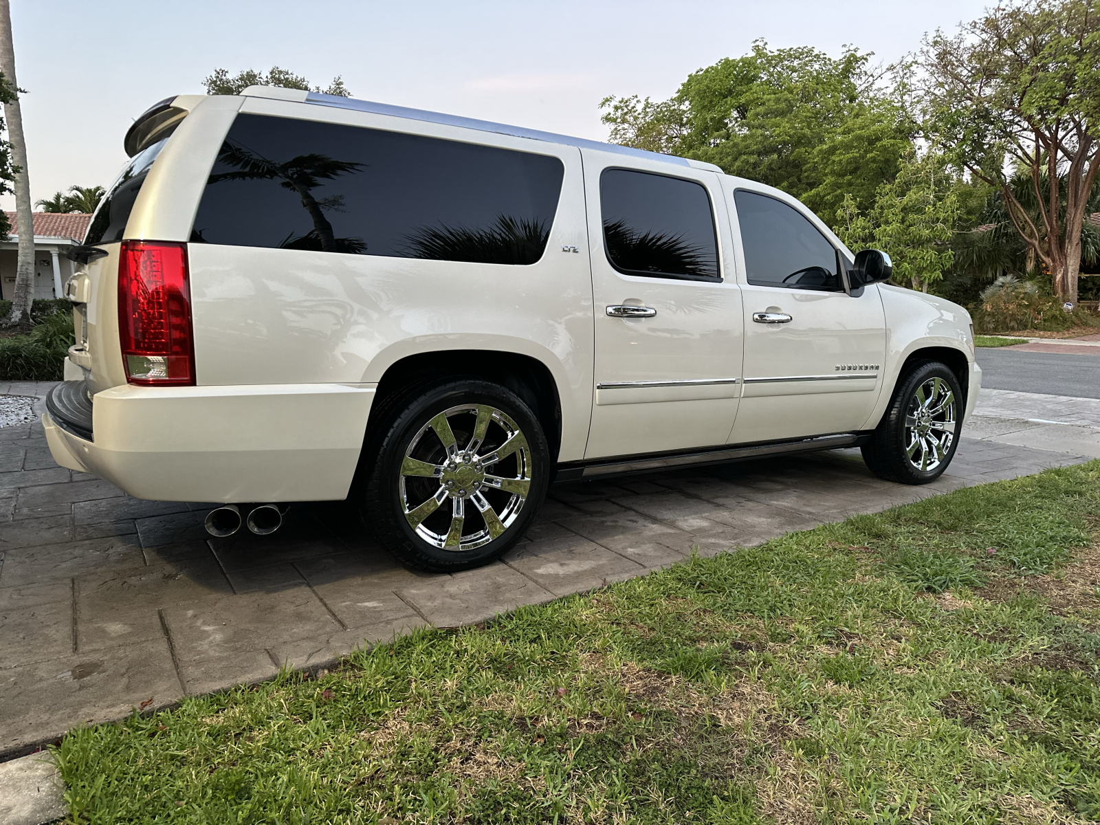

Yessir all good memories for sure. Thx it took me a moment when the new wheels were on...but glad I went that direction. @adventurenali92
They do look nice. I saw a set on an Avy the day I got them mounted. I put 3 coats of the Dura-Coating Wheel Armor Nano Coating before they got mounted.
Sheds the water nicely and easy to clean. Made locally in Naples, FL or Amazon. I've just got to find time to clean the tires and apply the Dure-Dressing tire dressing, so they stay shiny all the time.
adventurenali92
Feb 16, 2015
7,722
9,172
Big Bear Lake, ca
Heck yeah man!! Dura coatings makes such good stuff! Them wheels will be so simple to keep clean with a coating in them haha. That reminds me I need to our in an order for some stuff from them soon haha.
