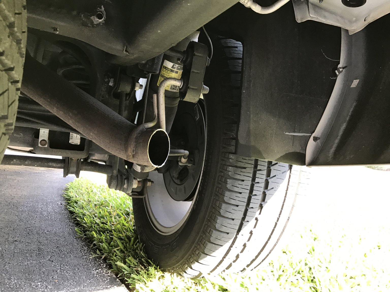

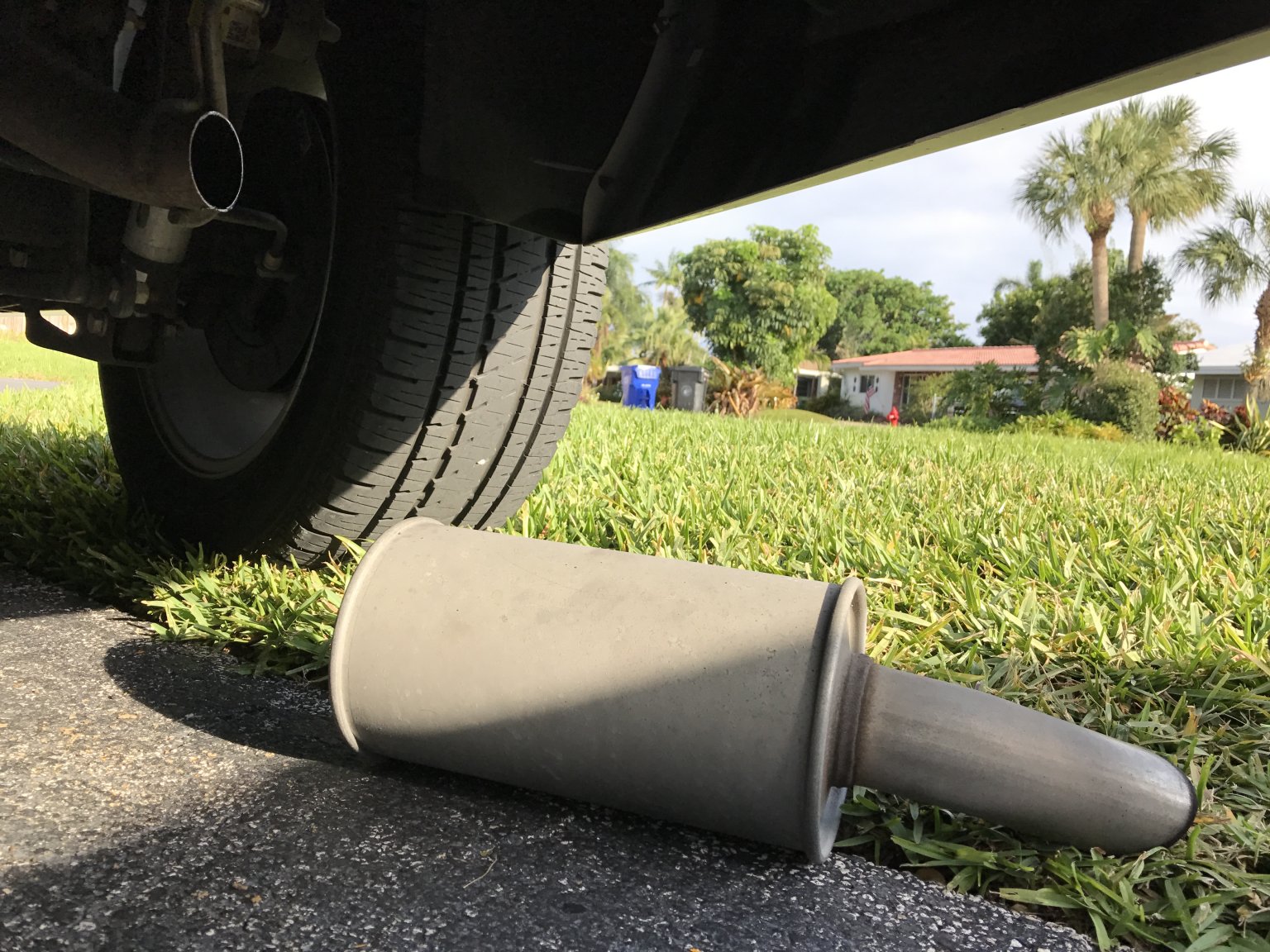

I cut the resonator off today. Took it off just between the last hanger and the resonator itself. I removed the heat shield (2 x 15mm threaded bolts to the frame without backing nuts) first to give me some extra room to lay on the ground and get the sawzall in there with the spare tire. Looks clean now without that coffee can dangling down. My wife will never miss it.
I'll write the rest of this for those of you wanting to know more info about after the resonator is deleted.
It is clean looking. The exterior sound does not change other than the hollow resonator sound is gone at start up. The Interior sound at start up with the doors open and sitting inside revving with the doors closed remains the same as before. A WOT pass with the windows open or closed is the normal exhaust sound as before.
To me, spending $$ for the SLP Resonator delete pipe and dual polished tip at this point IMO could be better allocated elsewhere. Not sure if I will go with a muffler swap or not as it is the wife's daily driver. I am tempted though as a little growl could be welcomed.
I may consider the popular Magnaflow 12589 or Black Widow.Either way, cutting the resonator off is a win with the clean look, takes less than 1/2 hour, cost $0 and does not alter anything with regards to your OEM setup if you want to stay that way.

Not sure. Will rock the no exhaust look for a while and see what I think. Side looks clean without anything though.
Clamp on some kind of extension so on cold mornings it doesn't look like you have an exhaust leak under there lol
Damn government and their mandatory resonators and baffles. That's nice it can be deleted with no sound difference, and takes off a good chunk of weight too. It is a big ass burb but anything helps

Plus if you sit idleing for awhile, the fumes might get inside, because of the way it terminates under the truck instead of expelling the exhaust to the side, outwards.

You could probably just get a piece of 3" pipe from autozone or whatever and clamp on there and get a nice tip

y'all are over thinking this. He will not get any exhaust fumes inside the vehicle with how it's cut now. Adding tips and all that will just take away from how clean it looks now IMO I vote leave it as is :waytogo:

No I mean add an extension to route it more towards the outside, but still keep it hidden. Probably won't get in the cab , but a possibility is still there.
