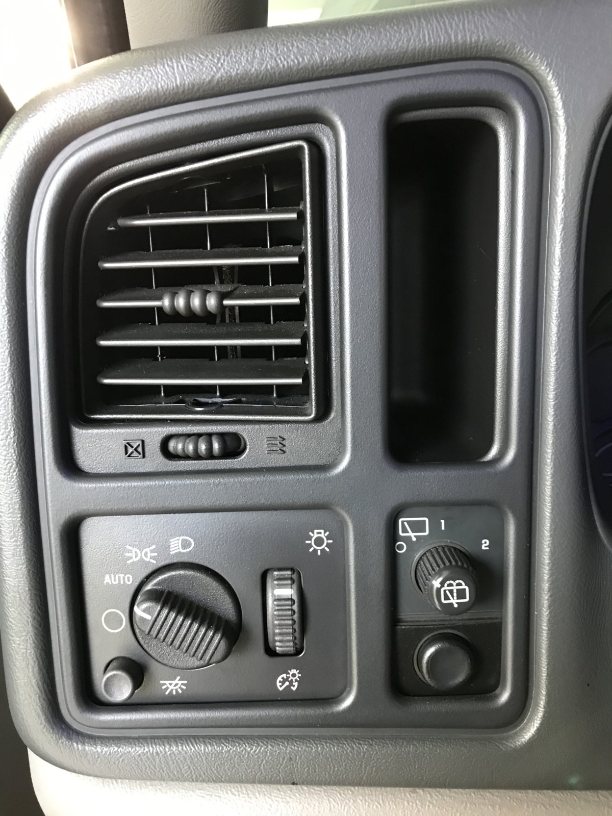

Found a spare fog light switch at the junkyard earlier this week. Well actually I only wanted the fog light push button. I found 2 but one broke the same way mine did. It is so thin, that it just pushes through.
I got mine almost apart to change it out but it was being stubborn and moving the circuit board and then the fog lights wouldn’t turn on, so I gave up on changing the switch out for now.
I took a piece of black electrical tape, cut it into A Perfect Circle to cover the hole and much like the NNBS A/C buttons it is now covered.
Interestingly enough my fog light LED is out but the rear wiper switch 3 LEDs work.
Stupid little things can win or fail right?
Fog light switch electrical tape vinyl overlay.

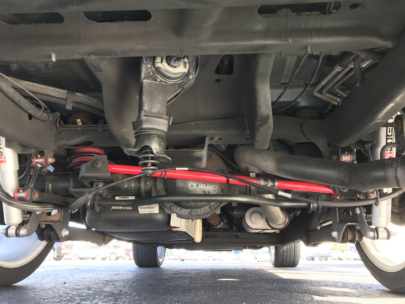

A picture from last weeks painting and cleaning underneath. Still needs some love, but looking better.

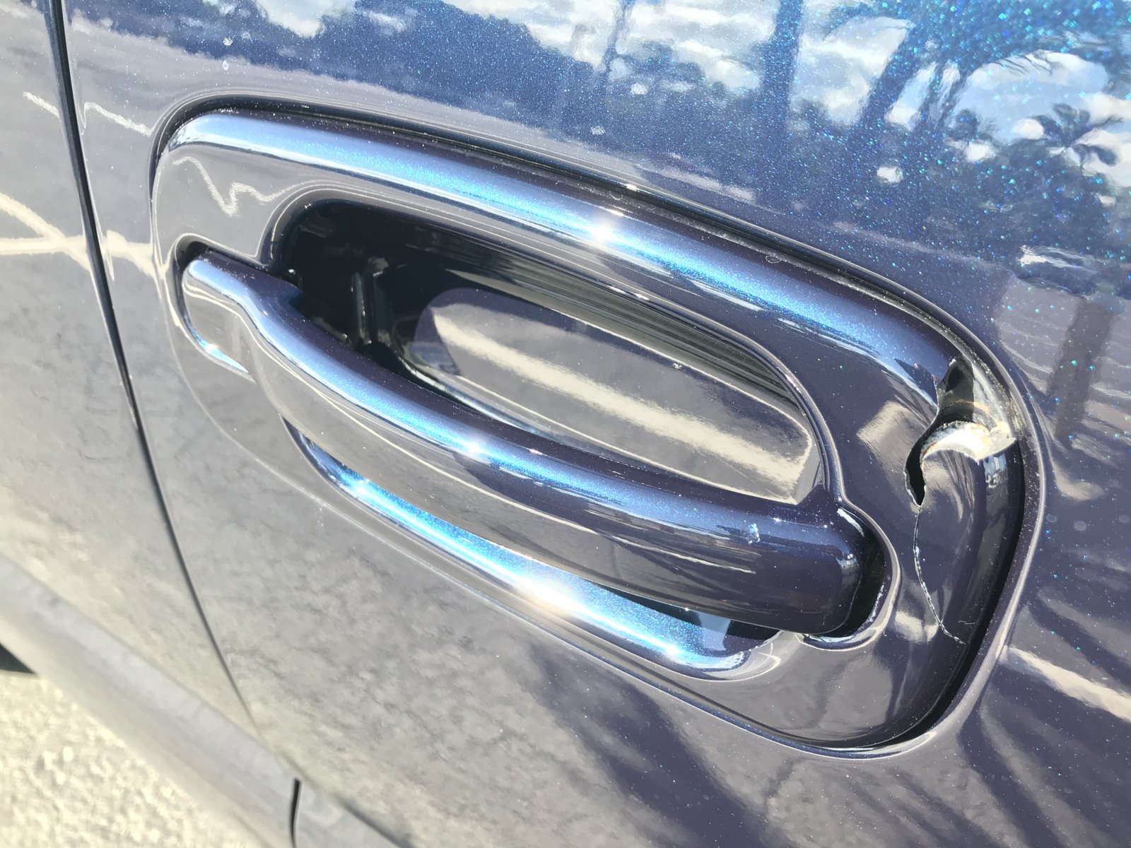

Got up early this morning and hit it with 3M Perfect-It Machine Polish, then Surf City Nano Seal and finally top coated with some Trinova Paint Sealant. She looks much better and that 2000 grit sandpaper feel is gone. Man was I pissed when that happened. And the house still sits vacant. The Suburban is next on the list to polish and coat.

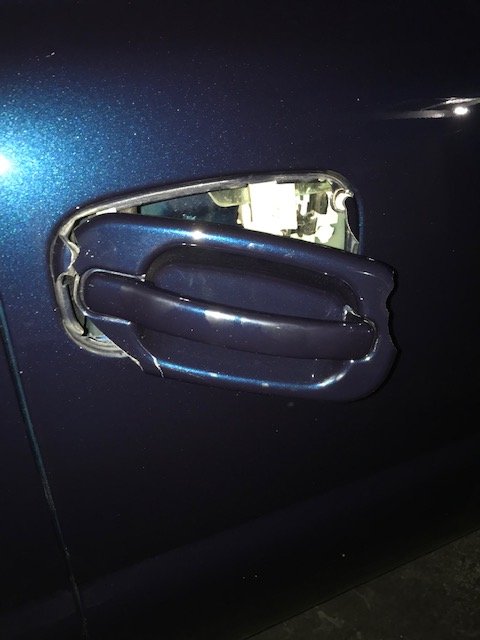

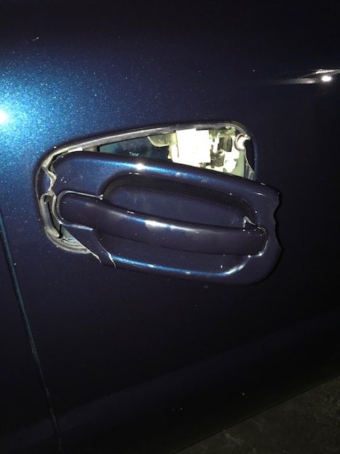

And I'll be damned if the very next moment I opened the passenger door and a piece of the handle broke off. To be fair, it had been cracked when I hit it with the polisher a while back. Today was the day it finally decided to fall apart. Fuuuugggg.....need to get a new one painted now to replace that POS.

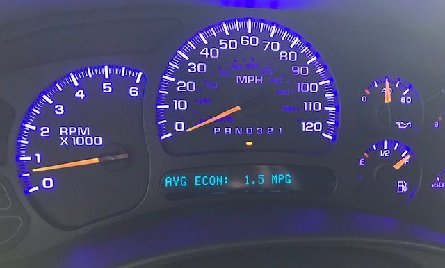

The windows got coated in Rain X and the tail pipe was polished out. Filled her up with a tank full of 93. Managed to get 10.4 mpg. My smaller fuel tank only shows about 260 miles per tank after topping up, while the Suburban shows over 450 miles. Road trip miles were great in the long body when you average out the MPH, distance, steady cruise and MPGs, but city driving is a killer on both trucks for fuel consumption, even if you drive conservatively.
This was right after filling up and sitting at the traffic light. Imagine that MPG as a reality?

Now I have a couple of pieces and a totally mangled door handle!! I pulled once and heard that unmistakable crack, so that fascination of how far you can push it, turned into another crack, then it exploded and just hung there still attached to the rod and bolts holding it to the door.
Found my OEM handles buried in a box of other parts. Time to get to work and fit the parts to at least get the door secure when it is locked, then worry about color matching the replacement. Going ghetto with some mismatched parts. Ugghhhh.....

was going to say I might have a handle somewhere if you needed one.
Thx man for looking out. I was going to head down to M&L out there on 441.

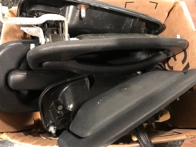

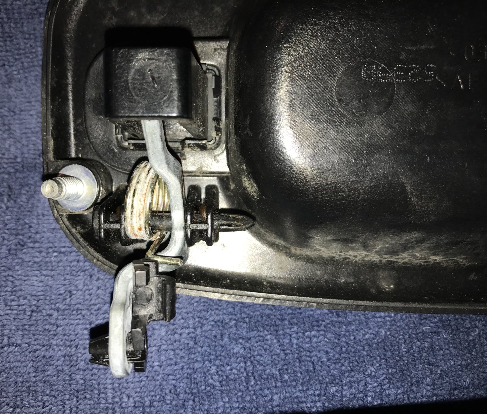

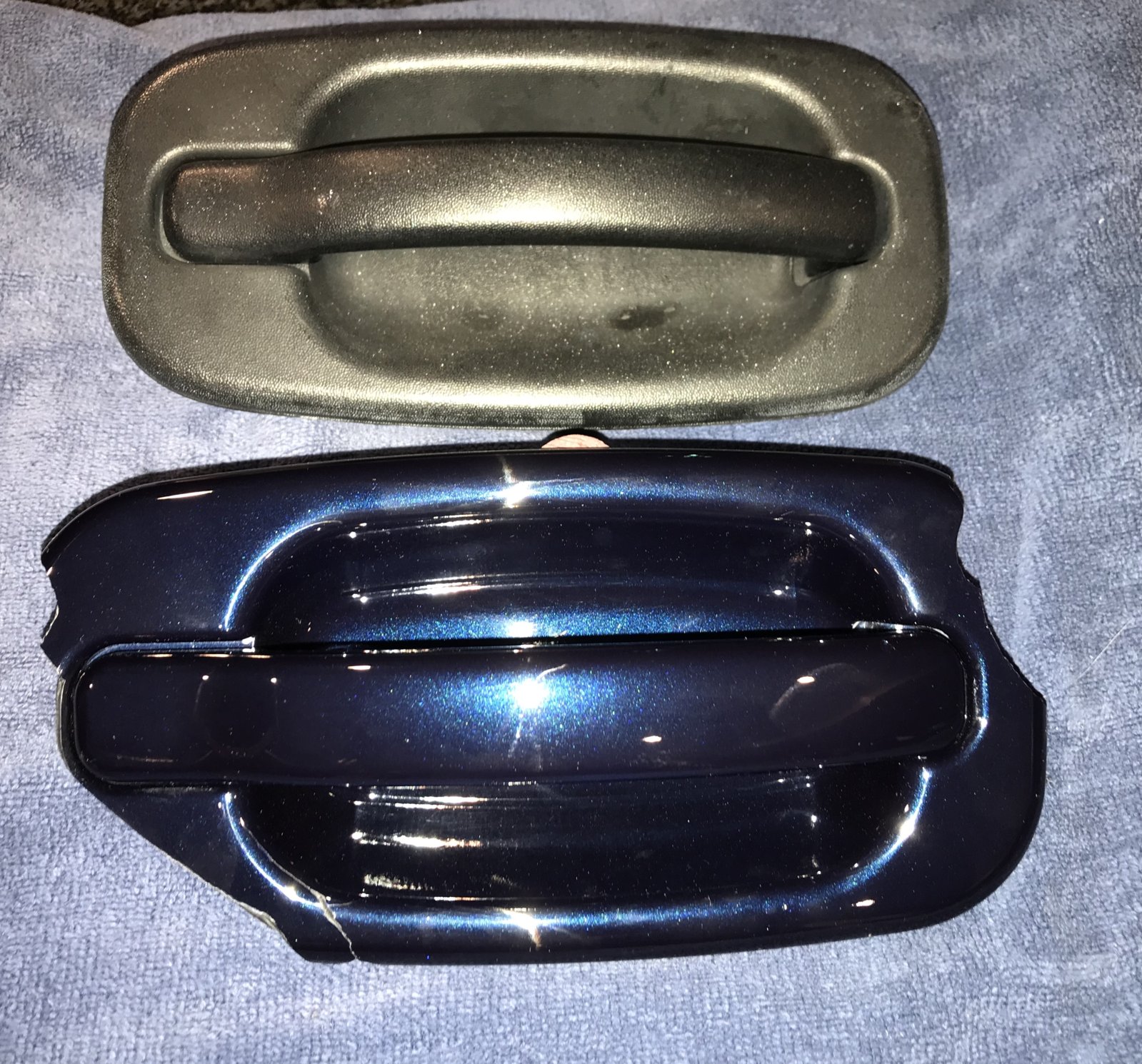

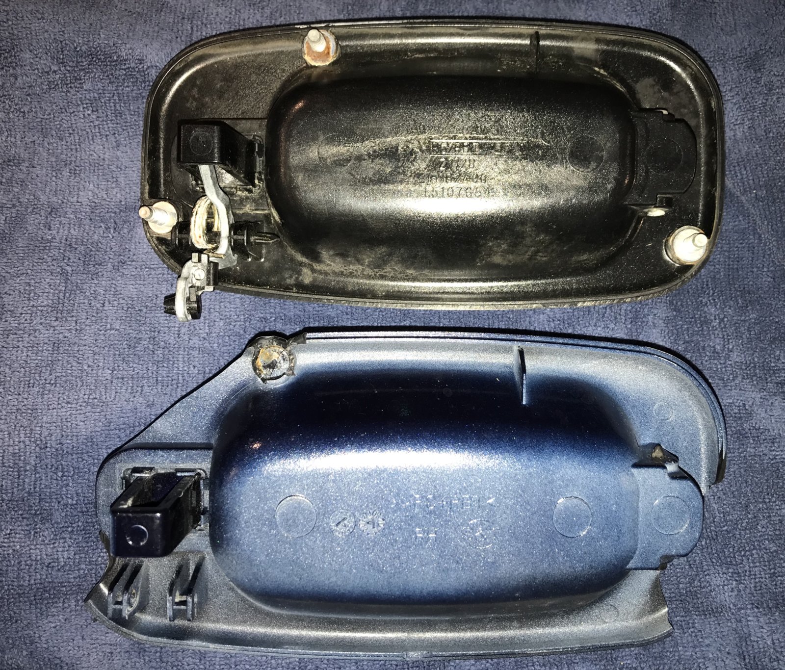

So the black ones are my OEM handles. I bought aftermarket handles to CM.
You can see the CM handle broke at each of the 3 bolts. The OEM handle uses a metal rivet where the handle attaches to the actual assembly that attaches to the door. The aftermarket handles use a plastic rivet that can be squeezed and pushed through.
I think I still have some spray paint left, so I may pop that rivet to reuse the painted handle and then CM the OEM assembly and see if I can get a good smooth coat.
Fingers crossed I get a good outcome as it is a pretty small piece to wet sand and buff out.
Can see the metal rivet in the right side where the the handle and assembly attach.
What a difference between OEM black and CM. .
You can see the plastic rivet That can be reused.
