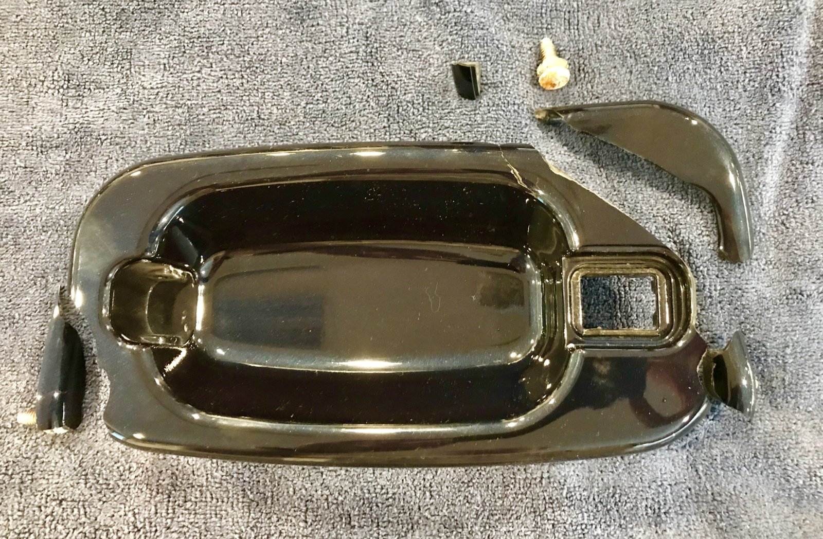

Now I have a couple of pieces and a totally mangled door handle!! I pulled once and heard that unmistakable crack, so that fascination of how far you can push it, turned into another crack, then it exploded and just hung there still attached to the rod and bolts holding it to the door.

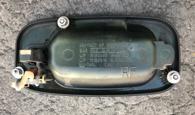

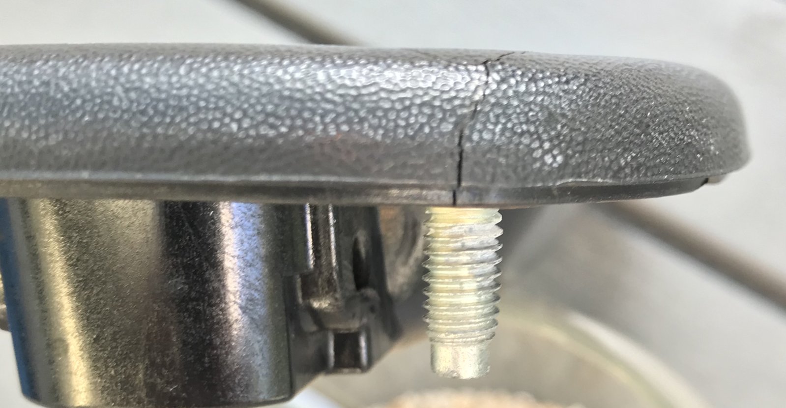

Today no luck on the OEM handle I pulled out last night. It has a crack on the front by one of the bolts. Grrr... I did not inspect the handle close enough before I started working on it of course.
I had to pull the Dremel out to cut the end of the rivet off, sit it in the vice and pound it out to separate the handle and assembly. As I was washing the assembly to prep for adhesion promoter I found the crack. Grrrrr...
So I reassembled the black OEM handle and installed that on the door so it would be secure for now until I can source out a new handle and color match it.
I did search eBay for CM handles, but no dice. Guess it is off to the junk yard to see what is there first, and if nothing there then order one online. At least I have a handle even though it is black.
The OEM crack.

The carnage

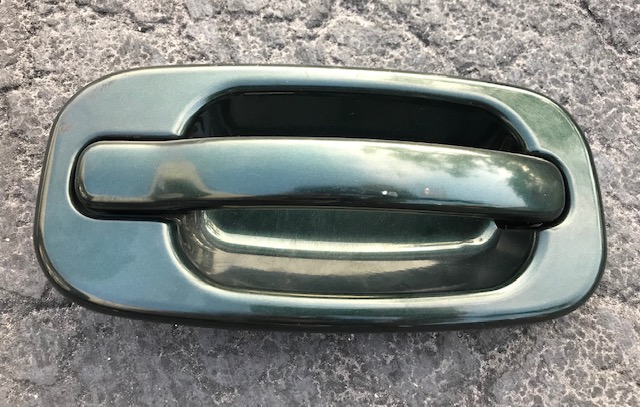

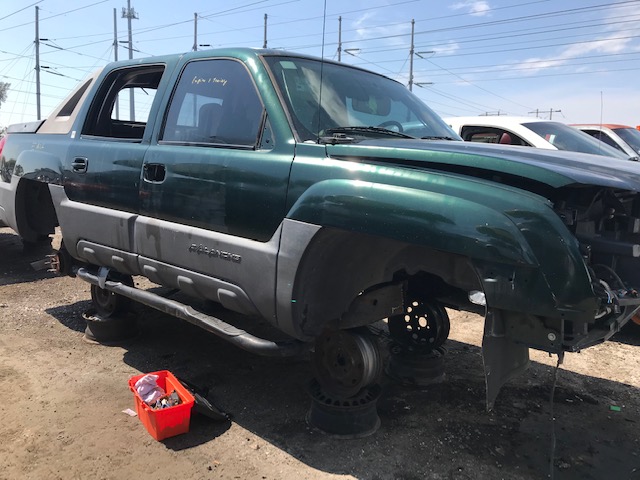

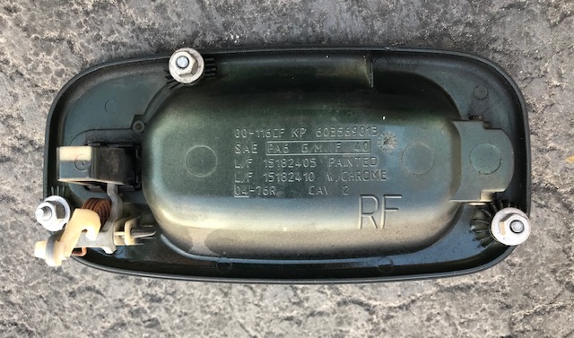

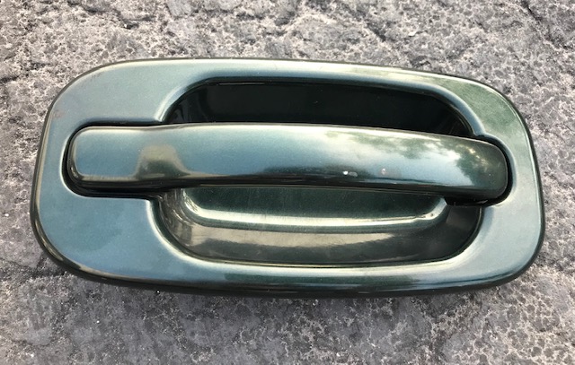

Hit the junkyard today and found a donor green Avalanche for a replacement passenger front door handle. Perfect shape and already smooth. Surprised it was still there, but guessing since it was green and not textured black, the usual vultures couldn't be bothered to paint it. lol Win!! I just need to Dremel the rivet off the assembly so that it can be painted on its own. I will reuse my existing handle as it is in mint condition.
I should also be able to use the original rivet as it fits so tight that even without the nub on the end, it is unlikely to come out as I had to pound it out with a hammer and punch in the vice.
Total cost including the $2 entrance fee was $21. There are many options online for a few dollars cheaper, but this one is OEM and 10 minutes in the yard was worth a few extra dollars.
Check out where the frame has been cut and the motor is gone.

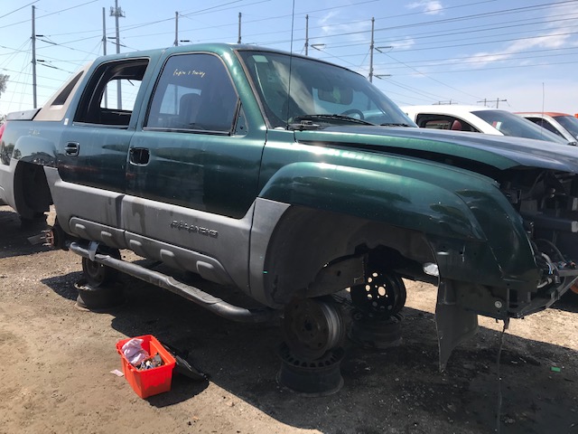

I should also be able to use the original rivet as it fits so tight that even without the nub on the end. It is unlikely to come out as I had to pound it out with a hammer and punch in the vice. Total cost including the $2 entrance fee was $21. There are many options online for a few dollars cheaper, but this one is OEM and 10 minutes in the yard was worth a few extra dollars.
