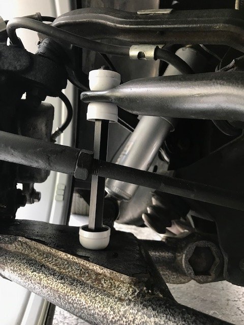

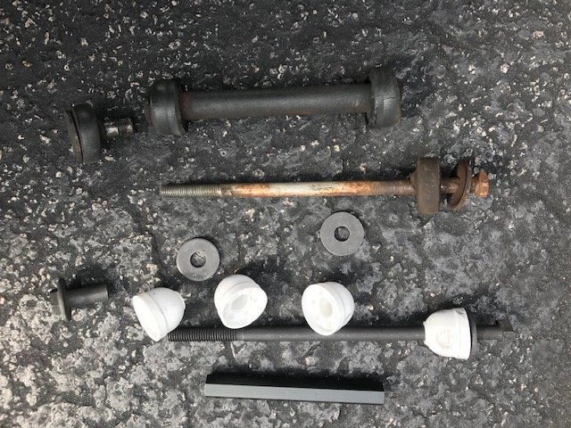

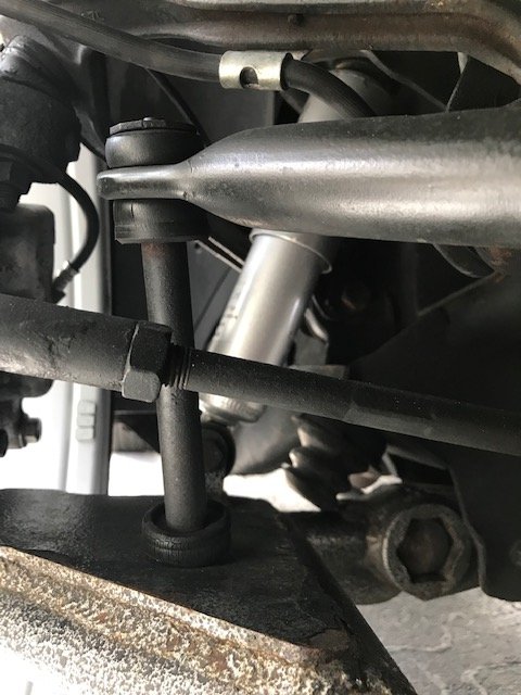

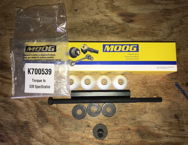

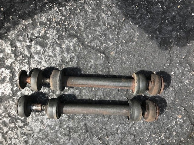

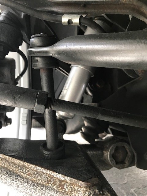

Got a new set of Moog end links, part number K700539 from Amazon and installed them this morning. Thanks @95escahoe for the part info. I double checked on the Moog site ($21.35 per side) first as Amazon ($14.93 per side) says it does not fit my truck.
See here:
https://www.moog-suspension-parts.com/moog-k700539
White is the only color. They did have blue, but have since been discontinued.
Easy swap, but I did have to lift the truck up just barely off the ground as I couldn't get the end link in between the lower control arm and the sway bar. Plus it made a bit more room to work the wrenches. Approximately 30 minutes for the job.
Took it for a spin to settle the front end down. Whether there is a noticeable difference or not is TBD, but nonetheless refreshing an old part on the suspension is always a winner.

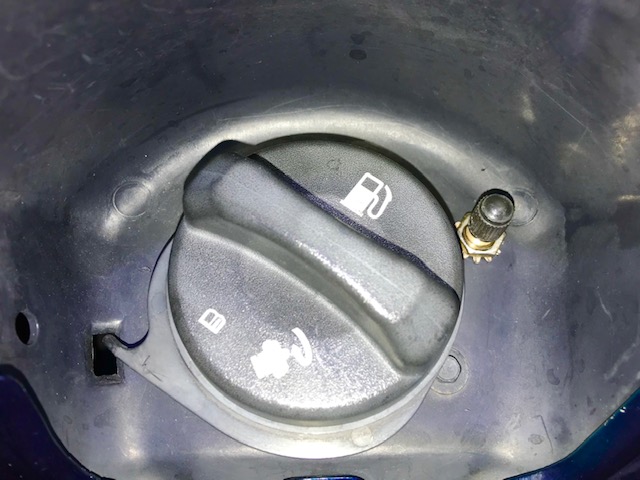

I relocated my air fill line for the Air Lift 60742 bags inside the rear springs. It was previously tucked up inside the rear bumper. I just ran the lines across the top of the framework, zip tied it in place on up to the fuel fill and through the small hole and tightened up the 2 nuts. When the shop installed the drop, they T'd the lines from both bags into the one fill. Not a big deal for me as I don't tow or load the cargo area where I might need to distribute the load. This just make it easy to fill both bags and be done from one fitting.
Looks good and more accessible as needed. I put 10psi in the bags to see if the ride is any different in the back. Tires are at about 38psi at the moment. Fuel mpg seems to be better or maybe because of traffic and the tricky motorcycle police staked out in their favorite shadowed spots, I am unable to open it up as often?? Not bad for a 4.8. :rolleyes:

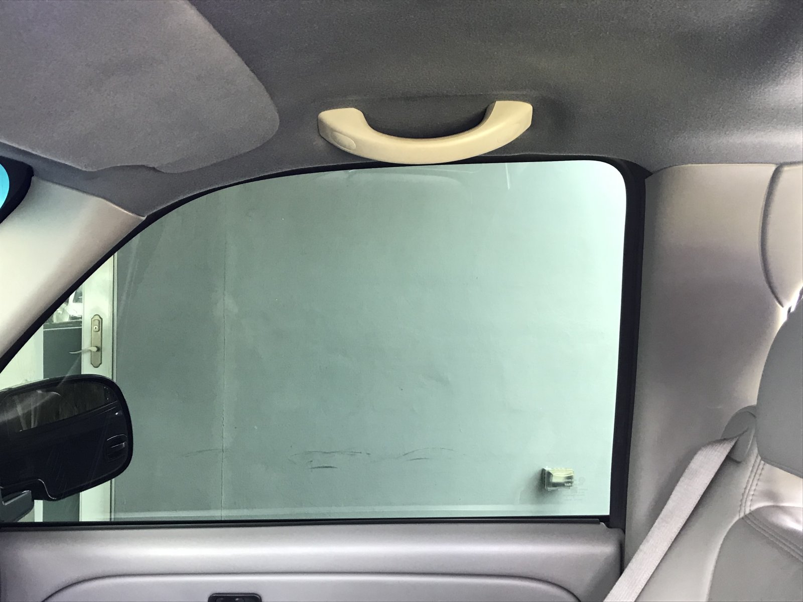

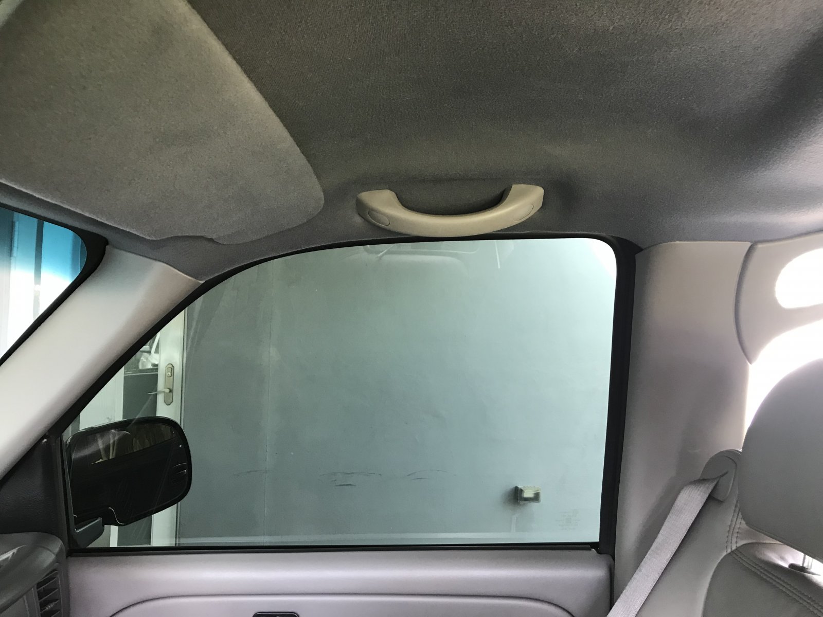

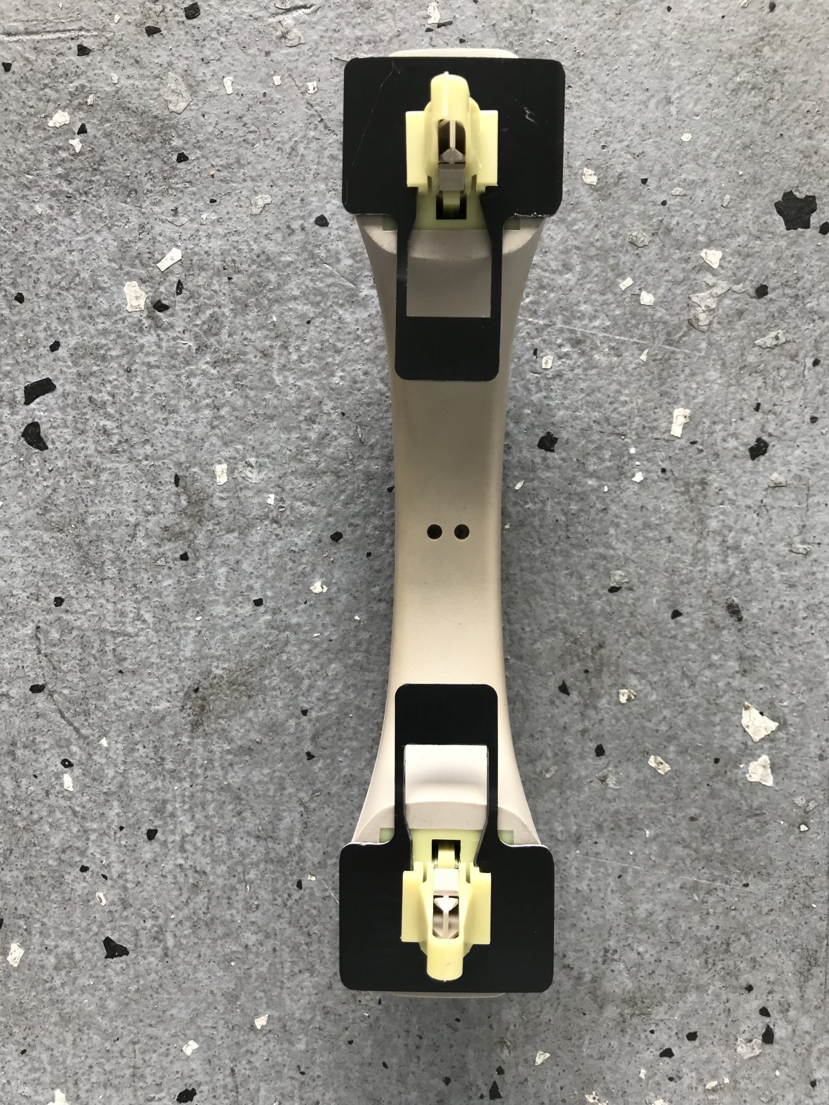

Swapped out the passenger front overhead grab handle.
Long ago when I redid the carpet and headliner I accidentally painted the original handle. Spray paint and rubber were not a good combination, so it went in the trash with a junkyard replacement taking its place.
It was the wrong color (tan) and I finally got a grey replacement to trade it out.
The headliner is a dark grey and the handle is a light grey.
Tan handle.
Handle with the black plastic slide washers that hold the handle to the headliner and help lock it in place into the roof.
Grey handle.
