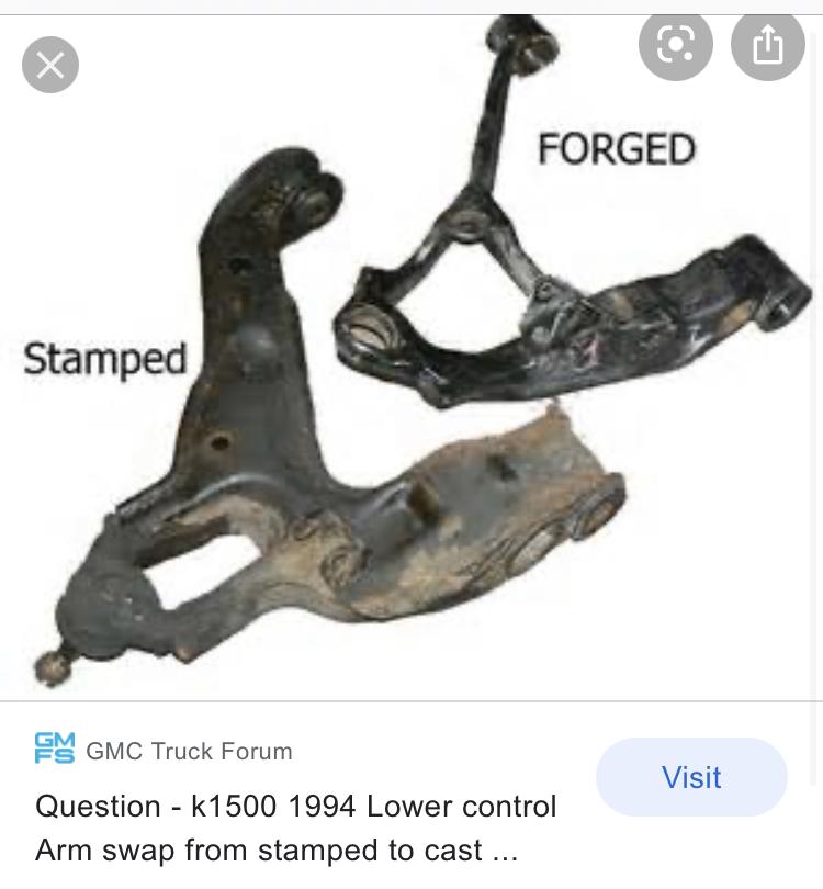

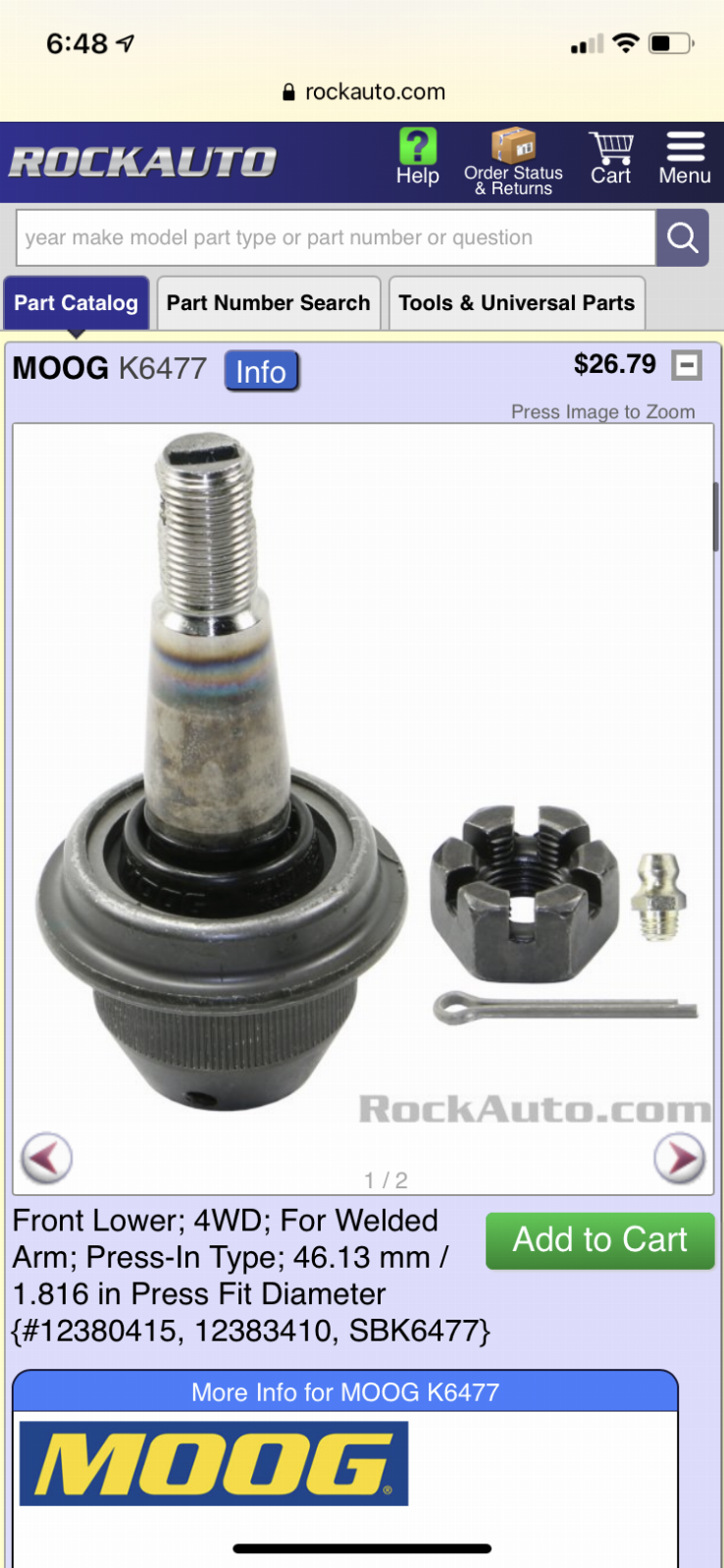

The difference is the type of LCA and diameter as mentioned above. My 98 used the welded/stamped.
