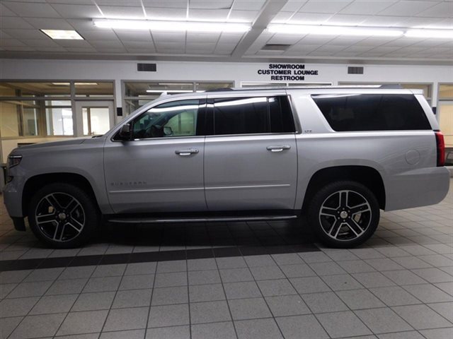

I am thinking of going to 22" CK 160 wheels with 285/45 Bridgestone Duelers. I was curious what the overall wheel & tire diameter is? Do any of you tow? Your thoughts on towing performance? I am concerned that this wheel & tire combo with reduce my towing capacity. It will if the diameter increases over the base 18" wheels I have now.
Here's a pic of the wheels on a Suburban. I know I saw at least one member with these on a Tahoe/Yukon.
