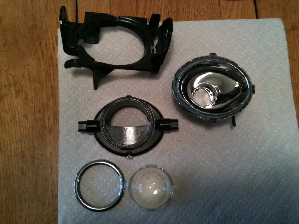

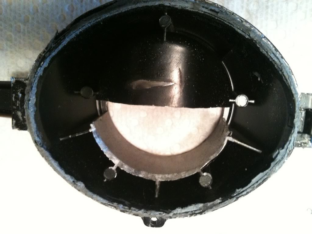

Success....finally. And I still have the other one to do, but hey. Progress is progress. I got the lens off, which gave me access to the shields. Was able to quickly sand off the black paint to metal, so now I'm ready to paint. Here's a few pics of this little assembly:
Inside looking out, with top shield cut out (turn your computer monitor upside down for the correct perspective on this one....lol):
The whole thing taken apart. I have sanded the black paint off the front of the lower shield in preparation for painting:

The upper shield is basically a foreground light blocker. In fact, they are called foreground blockers...lol. It's so your beam is narrow and throws far which is great when it's for a driving light and you're trying to see as far down the road as possible, but with fogs you want the light on the ground right in front of you. Basically it should fill the ground with light from your bumper all the way out to the cutoff with them removed. With them, you get a black spot right in front of your vehicle.

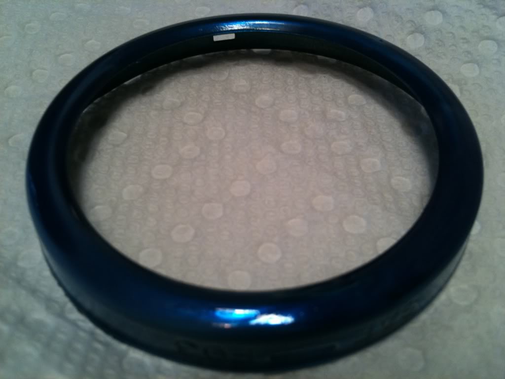

A sneak-peek at the new color ring/shield and hopefully lenses.
Chauncey gets the credit for inspiring this :Handshake::

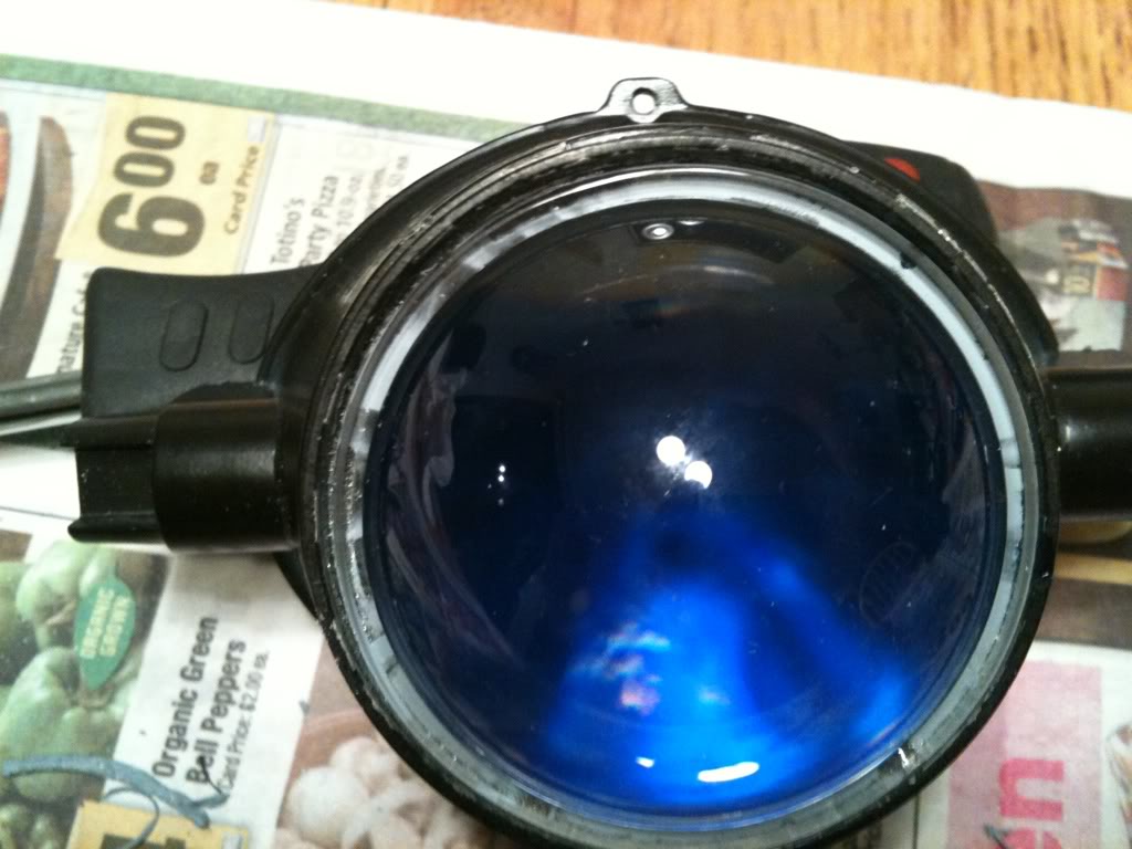

Last pic for the night. Projectors are pretty much ready, just need to get some sealant and put them back together. Still haven't gotten the Denali lights or HID bulbs, so it's not even going to be completed this weekend, but I got a lot of the tedium done. This isn't the final product, but imagine the ring around the lens in the pic below. I think it's going to look pretty good:
I'm going to have one light that is basically all of the little mistakes along the way, and one that is more or less mistake free. I chipped one of the lenses on the edge, too. That will be very interesting to see with the HID in because that could completely screw it up.

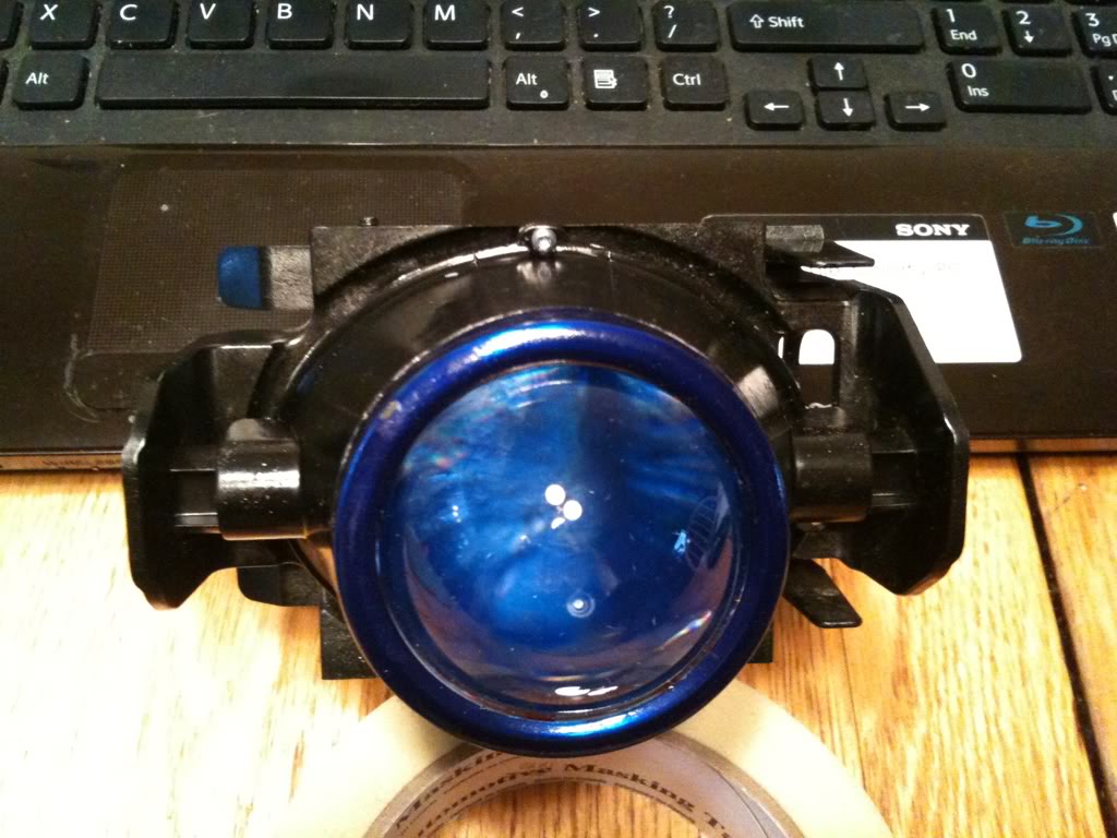

One reassembled....needs some touchup on the paint. Chipped some off the ring putting it back on. All in all it came out well. Just have the other one to put together. Then I need my actual lights so I can start fitment work.
