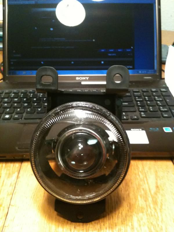

Quick pic of one of the P1's mounted in the preexisting housing bracket. Nicely centered and everything. Just need something to fill the gap around it. This is not the final product, but shows the exactness of the fit. If the projector that came with it wasn't an H3 halogen I'd compare the output of the two to see if there is any difference at all.

Looks good Scott. How about you just make another set for me?! Did you see the guy in HIDP who is doing the same thing you are with his Bonneville (they have the same fog lights.)

Send me the parts and I'd be happy to do it, but seriously this is so simple it'd be a waste of time. If you went with things like they are in that last pic, it'd probably literally take about 10 minutes to do both lights. It's that simple.

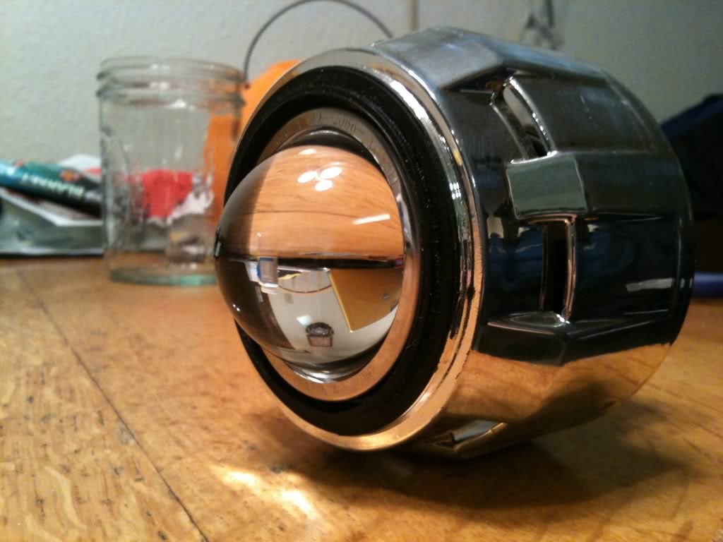

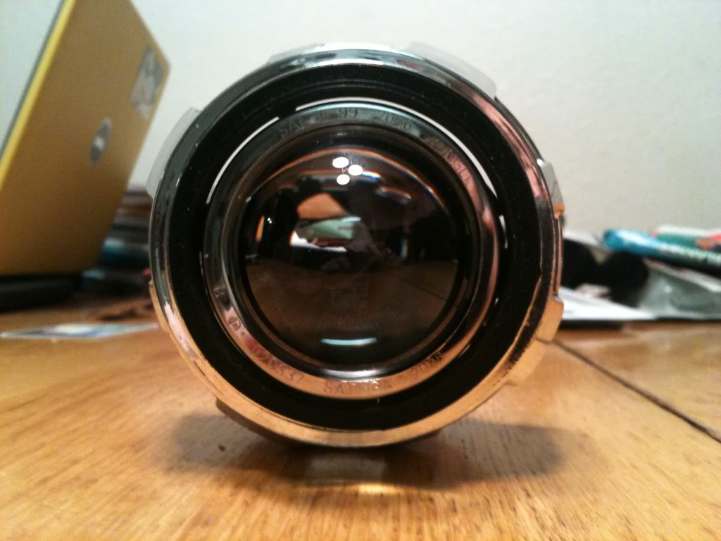

Ok, couple more R&D pics. I've now fitted the projectors into some shrouds. I put a black gasket around the shroud to fill the space, but there is still a little gap. Not much, though, and it may be needed for beam adjustment anyway. I think it looks pretty good. I still need to trim the shroud...I'm basically going to cut almost all of the shroud off leaving only the top part that is exposed to lens (and the only part seen aesthetically). It's just a tad too big to fit naturally in the fog light. The top portion of the shrouds will pretty much fill the fog light, so there will be very little gap and it should like a more natural fit than just the projector (although that would've been way easier...I'd be done by now...lol).
I'm hoping to get the shrouds cut and fitted tomorrow. I still need a precision cutting bit for my dremel. From there, I just need to epoxy the gasket in place and screw things together. Once everything is cut it should just go together easily with the two mounting screws. I never seem to have as much time as I want to just sit and work on this, though, so it could take me several days to finish this up.
Here's pics of the projectors in the shrouds:

This "little" project has taken on a life of its own. I trimmed down one of the shrouds today and it still wouldn't fit. They are just a tiny bit too big to get in and it's annoying. If I cut any more then there isn't going to be anything left of them. I may as well just screw the projectors into the housing and call it good. I'm spending way too much little unexpected money on this trying to make it pretty. I can make it functional with no problems, but trying to make it aesthetic is a PITA.
Thinking I may go to Home Depot and just wander around and see if I can find some stuff to make it look finished without creating too much more work for myself.

Bud you are way over engineering this..
Think K.I.S.S = Keep, It , Simple, Stupid,....
rubber door trim...
Run something like this around the back side of the Large housing to seal the P1 inside.
Theres all kinds from round to blade edge, from 1/4 to 1" thick..
Rubber door trim Noone will ever see it and all you need it for is to keep the inside of the outter glass lense clean on the inside.
Its never going to melt.....
I am real curious to know what those fog shells would look like with some chrome paint on the inside walls and maybe even paint the outside of the P1's chrome..
would probly enhance the total lumen output greatly .
