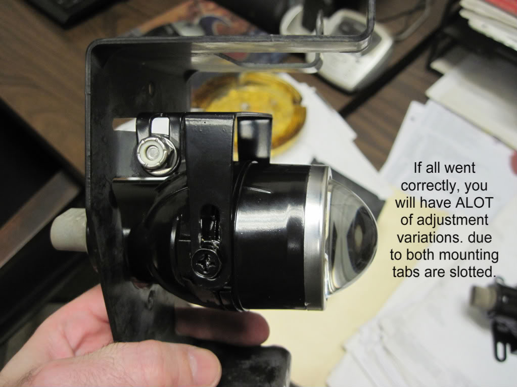

the housing is metal with glass lens.
This is the Projector light thats stuffed into that extra housing.
Shown is the light mounted to OEM denali fog bracket.
its from my how-to thread from way back.

Did you just mod the ebay projectors? I see there are different bulbs mounting then the ebay if they are the ebay ones. If not where did those come from? Also couldn't you cut a hole in the OEM housing and and put the projector into it to retain the factory housing so there is not a huge gap from the bumper and light housing?
