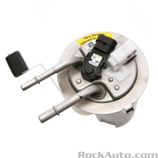

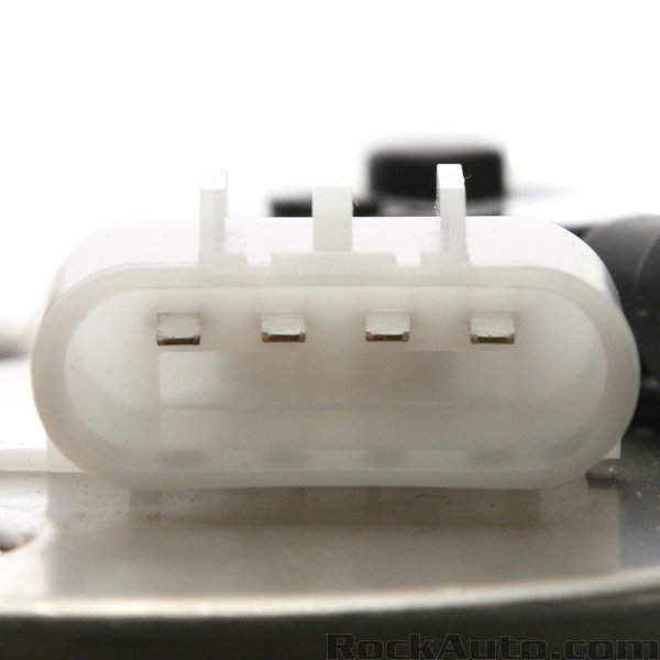

I believe the VIN Z Flex Fuel vehicles have a different intake and corresponding fuel pump. As for the fuel pump, the regular ones have 3 connections on top, the Flex Fuel has 2, I believe? Different electrical connectors, too.
Like this:
Regular GAS:
FLEX Fuel pump:
