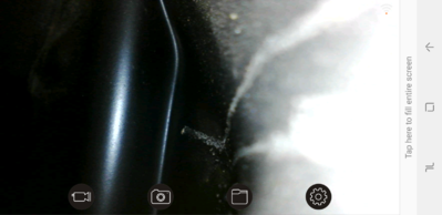

Cool! It looks like lack of lighting is my current camera's problem, but I'm liking the idea of this style. Any chance you can post a pic of how it looks on screen? Maybe post a screenshot of your phone? You don't have to pull a plug to get a combustion chamber image, but maybe a similar setting, like down inside a dash A/C vent or under a seat, would be nice.

Sorry, I kept forgetting to do this. It's not very exciting, but here it is shoved down the AC vent. The picture is quite amazing, and the light makes it especially useful. I also like the hook and magnet attachments... They make grabbing a socket that slipped into the depths really easy.
45,012
Thanks! That's plenty of resolution for what I need. It's a definite win at that price.
