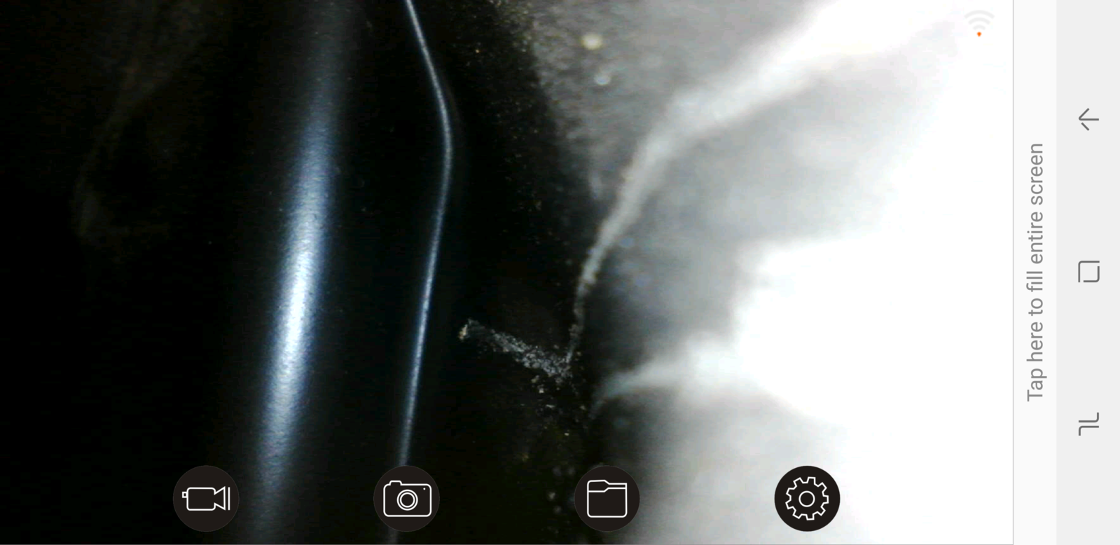

One other thing... Change your plugs if you haven't recently. And while they're out, use one of those USB endoscopes to look at the inside of the cylinder to be sure there isn't a lot of buildup.
I've pulled a plug from each bank and they looked and measured out fine. I may still change them just cuz. I have a crappy borescope that I stuck down in there. The resolution sucked, but I didn't like what I could see. It may actually not be so bad or it could be worse. I'll try lighting it up better in there next time to get a better view. In the meantime, I'm gonna research this "USB endoscope"...
Thanks for the input.
