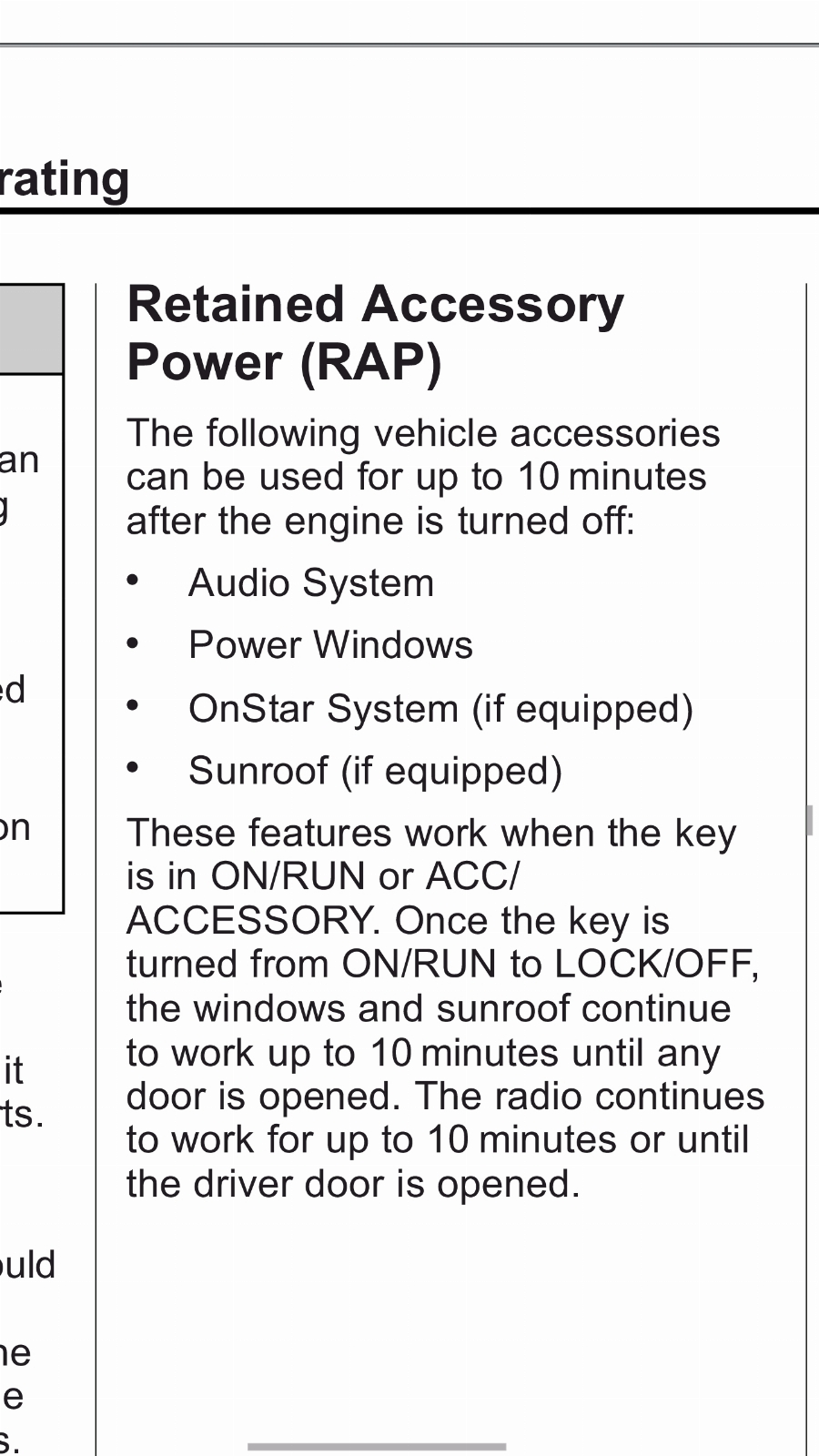

So if you shut off the vehicle, get out, close door, and go inside, the radio will keep playing for like 10 mins?

Actually press power on your radio right now with truck off...and door closed.... it’s called train station mode or something it will play for 30 min iirc

Holy shit, your RAP lasts 10 minutes? Mine times out in one. So the stereo shuts off just as I’m going through my front door.

Well I never timed my RAP before so this is obviously a feature programmed in to the BCM to retain RAP for one minute after the door is opened. I like it, you might not. Funny thing is, I didn’t see it mentioned in the items he programs in by default.
