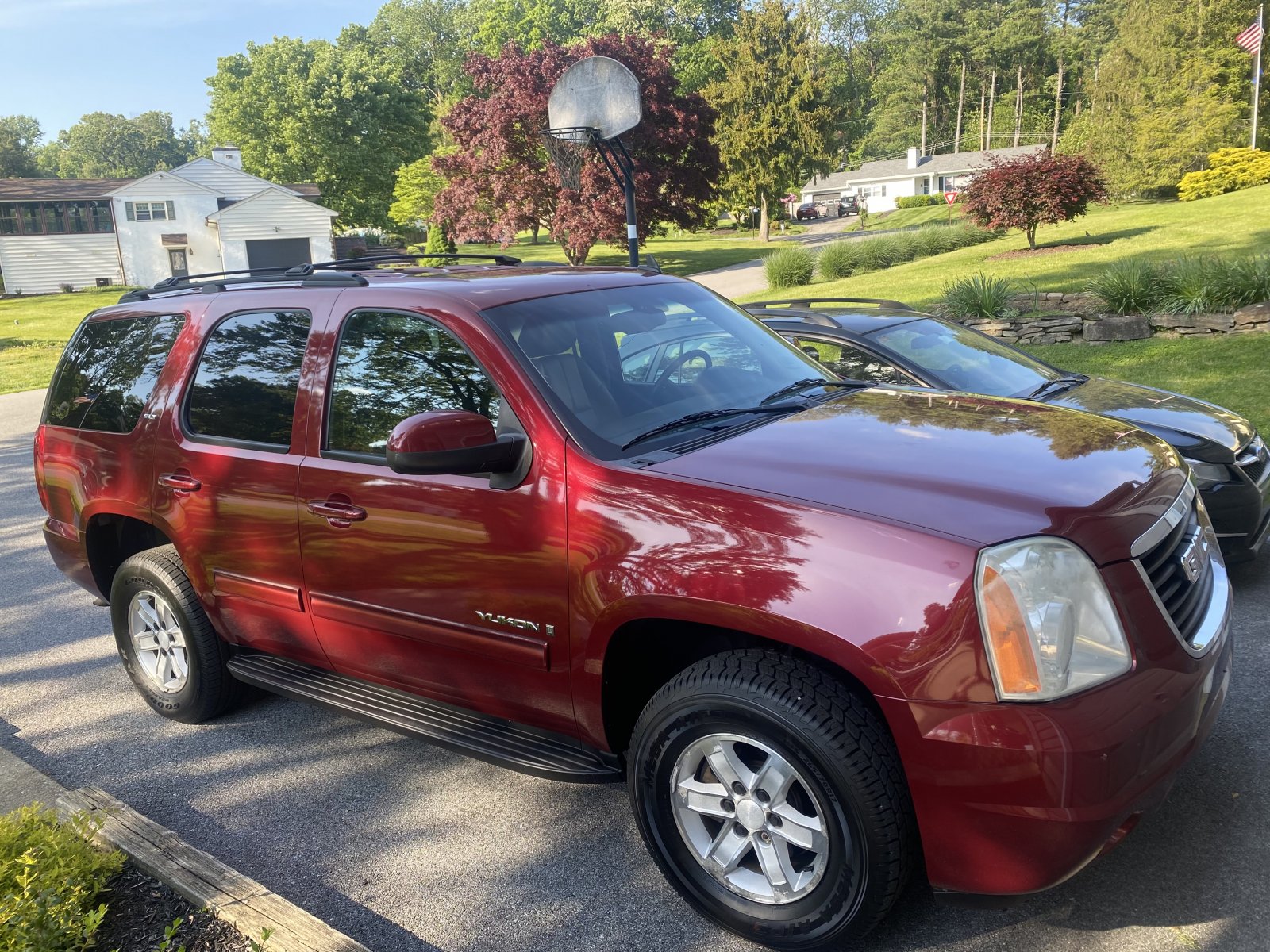

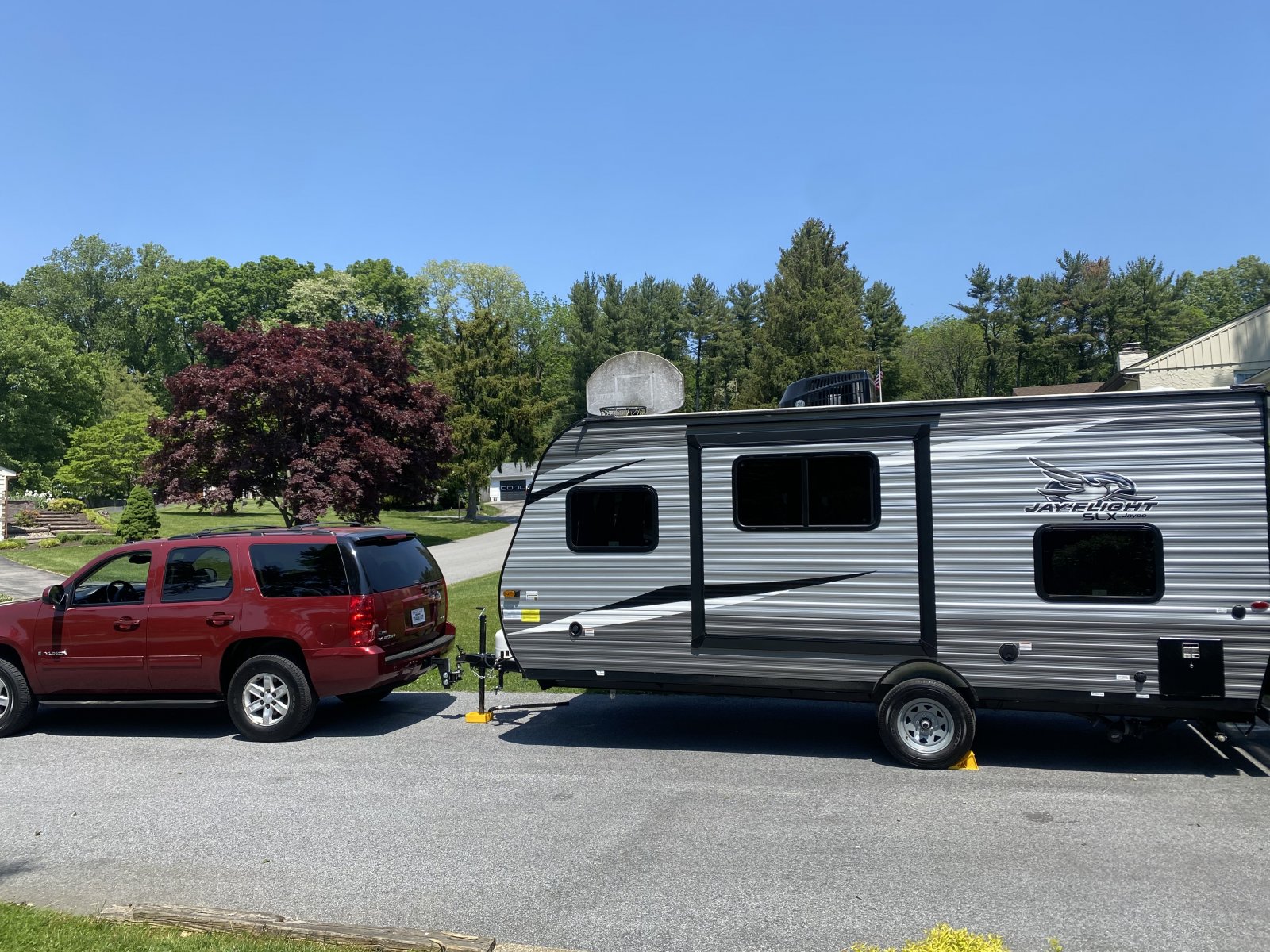

I have already received such great advice on the purchase, so hopefully more is in store! Recently purchased a 2009 Yukon SLT w/ HD trailering package 82k miles, only one owner. Truck is in pretty great shape, seems to run very well, clean interior, etc. We bought it to tow a Jayco 184 BS and are heading out adventuring for the summer on a road trip from PA to Seattle and back. What are some things that the experts can help me to look out for? What's on the pre-service checklist that I should be discussing with my mechanic (I have a trusted one). We are staying primarily in hook up sites, but will probably do a little bit of dispersed camping once out in Washington and Montana. With 2 small kids, we are only planning on 300-400 mile legs on any given back to back days. What should I be worried about? The first tow home after picking up the trailer seemed pretty good. Lots of power, didn't struggle at all at highway speeds. Any insight/advice/help is much appreciated!
View attachment 280106 View attachment 280107
Mileage is low and she's twelve years old or so. That can mean some rubber is needing to be replaced or needs to be replaced soon. I'm talking about control arm bushings, sway bar bushings, etc. Change all of your fluids, differentials, transmission, transfer case, radiator, etc. Most owner's never do this and most do not think they need to run on severe service schedule when they ought to.
Map out where the GMC dealerships are along your route, just in case.
My eyes aren't so good, do you have a weight distribution hitch on that with sway control? Does the truck have the Integrated Trailer Brake Controller or did you add an aftermarket one? Even if the trailer when loaded is below 5,000 pounds, the WDH will sure be nice to have on windy routes.

Thanks! Yes sir, got the WDH and sway control installed with the purchase of the Jayco as well as a Tekonsha brake controller. Wanted to be as safe as possible with my precious cargo! Quick question on the gearing. Do you generally use the "tow mode" button on the right hand side of the shifter? I've never towed long distances before so how do I know whether it is in 4th as compared to 5/6th? Newbie questions :)
