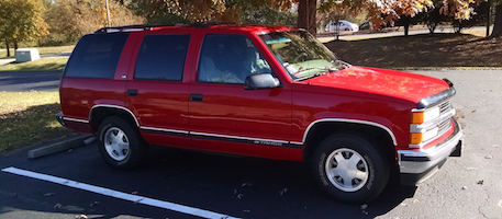

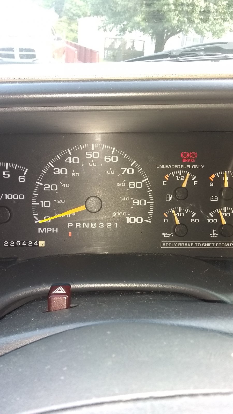

Hello,
I bout my first Tahoe today, a 2004 z71 with 275k miles. Bought it for a pretty good price and in above average condition for how old it is.
I'm a sports car person but decided I wanted a Tahoe for the occasional camping trips and what not.
Not knowing that much about them I'm just wanting some advice on what to look out for at 275k miles. The transfer case was replaced 6 months ago ( verified ) along with the rear main seal and a rebuilt transmission but not completely rebuilt just some parts or 780 worth of it.
Only issues I have with it are one or both the catalytic converters are going bad as its running super rich and reeks of unspent gas through the exhaust.
Steering is a bit loose, brakes are super spongy and the temp gauge hovers around 200 to 220 degrees, depends on the load but doesn't actually over heat just goes a little past 210 degrees then back own for a bit.
Saying that what should I watch out or possibly slowly replace? My plans are to replace the radiator, upgrade to better cooling fans as the ones on there now are super noisy. like loud as all get it out like a wheezy cough Look into buying a complete suspension kit and replace the front as well as with the steering components. I already have new coolant hoses and belts should I need.
Biggest things are the A/C front and Rear works like a charm which is needed in North Texas this time of year.
Any advice or preferred parts to use would be helpful. Right now planning no performance mods until normal stuff gets sorted.
Make a plan with priority's FIRST, basic mechanical immediately. You found a diamond in the rough so go slow. I suggest a 195 degree thermostat, OEM radiator is all you need with fresh hoses. Flushing the cooling system is the most important to clean the engine OUT BEFORE replacing the radiator. There is only one-way to flush.......to do it correct.
1. cooling flush in radiator
2. follow directions on bottle
3. let circulate @ least 30 minutes make sure HEATER is on. turn engine off
4. remove top radiator from radiator, move so water will drain on ground
5. put wadded up rag in upper radiator neck where hose was
6. Remove radiator cap and put water hose in radiator
7. start engine and adjust water hose in radiator just to keep water running
8. when water from upper hose is CLEAN.....YOU'RE DONE.
I share the way I was taught by good people years ago. There's GIVERS and TAKERS......i choose too share in giving.
You have a great Z71......keep it that way.
