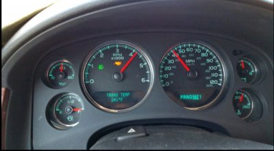

I disagree with the responses above (not Bill's, posted while I was typing). I don't just turn on tow/haul and drive away in "D."
GM calls it "range selection mode." Whatever you set the number to, you're limiting the transmission to gears up to that number. M3 locks out 4, 5, and 6.
I agree with running in M5 when towing. This locks out 6th gear. Even if the vehicle is able to maintain speed in 6th, it's likely that the slightest grade, or even a headwind, will cause it to downshift. I prefer to reduce/eliminate those frequent shifts.
When approaching a steep grade, I typically will kick it down to get the engine in the power band prior to the grade.
I will sometimes go to M4, M3 or even M2 on long, steep grades, again to prevent frequent shifts. On long pulls, you'll sometimes hit a flat area, or even a downhill stretch, and I use M to keep it in the selected gear for when the grade resumes.
I will use the tap shift buttons (+ or -) primarily on descents, to have better control of engine braking. If your speed is too high for the selected gear, the computer will block the downshift.
I also use it in winter when driving in snowy/icy conditions, for better control. If you're stopped and put it in M2, that puts it in "low traction mode."
ETA: This was my "worst case." The "Ike Gauntlet," 7% grades, 11,000 feet elevation, 16,000-lb GCW. Trans in M2 for a stretch of about 10 miles.
