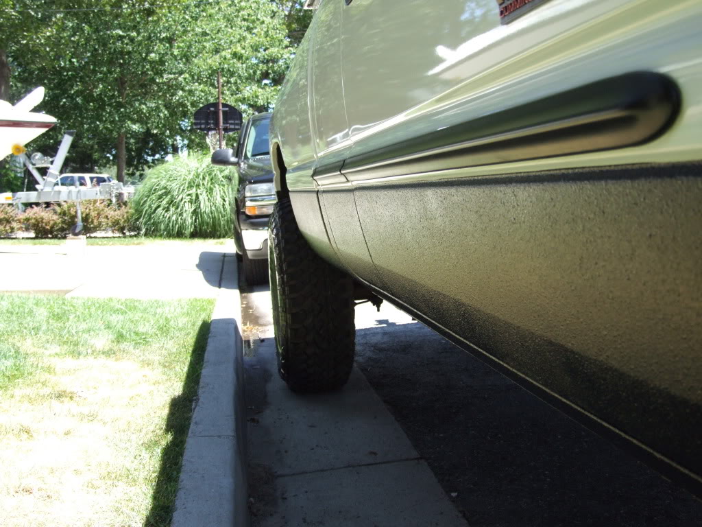

Here's a pic of a bumper coated in Sem Chip Guard:
I might be able to spray the rockers with the Chip Guard and just leave the flares alone.
Casey
---------- Post added at 08:32 AM ---------- Previous post was at 08:28 AM ----------
Here's another pic of Sem Chip Guard; this one is on the rocker panels of a Dodge pickup:
Casey

that second picture is what i had invisioned texture wise for my rockers. how thick is that chip guard? may be a better option.
A
arveetek
Feb 5, 2010
165
Granby, Missouri
Apparently the thickness and texture depends on how you apply it. I'm told texture is controlled by how far away you spray it. And the more coats you apply, the thicker it gets.
Casey

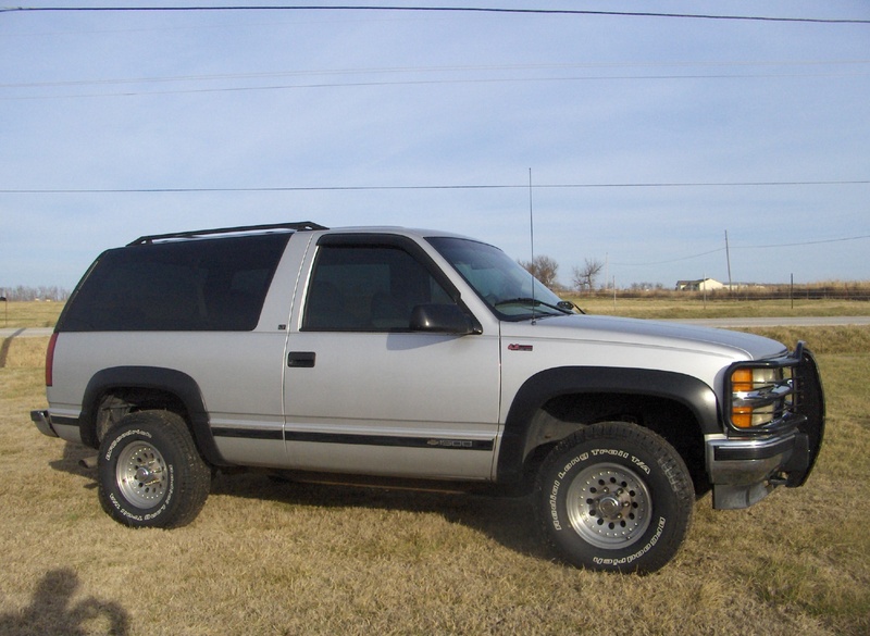

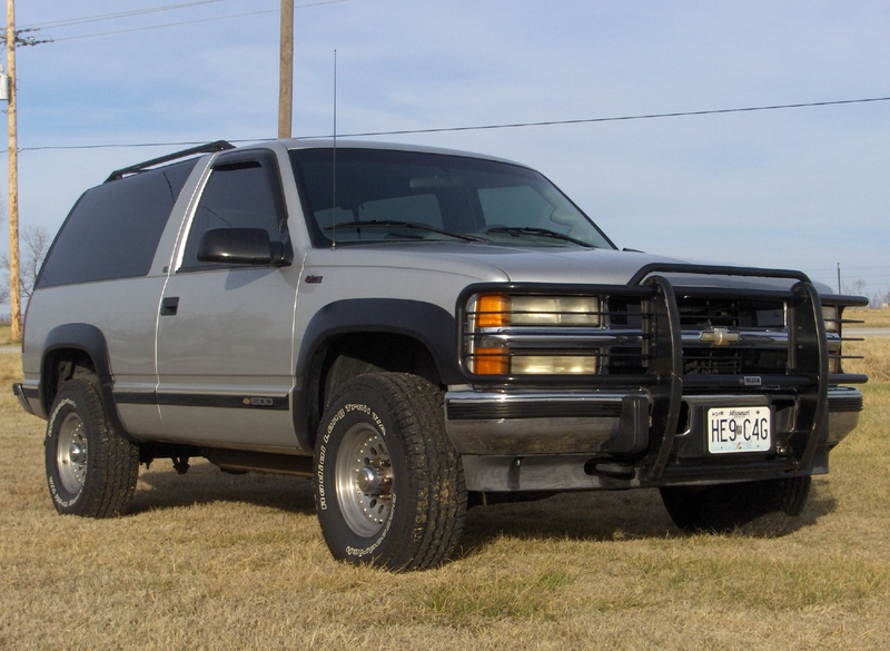

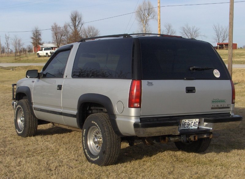

I installed my Bushwacker OEM style flares a few weeks ago, but I just got around to taking some pictures today:
I think I need some larger tires.....the 31x10.50 tires look too small in the wheel wells now.
Of course a mild lift would be nice too....
I still need to finish pulling the lower moldings off.
