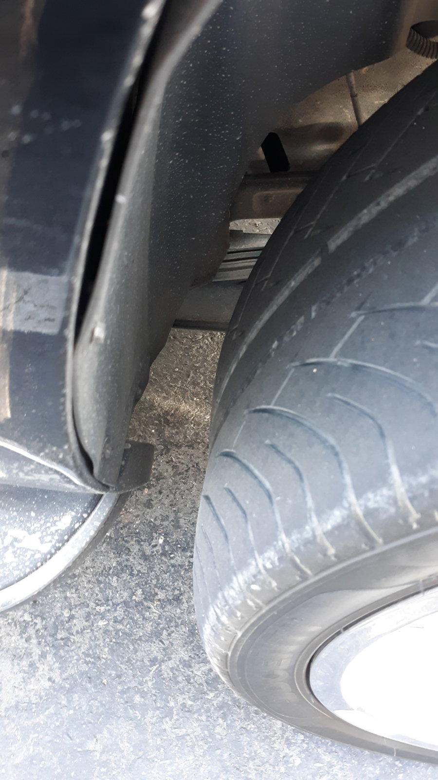

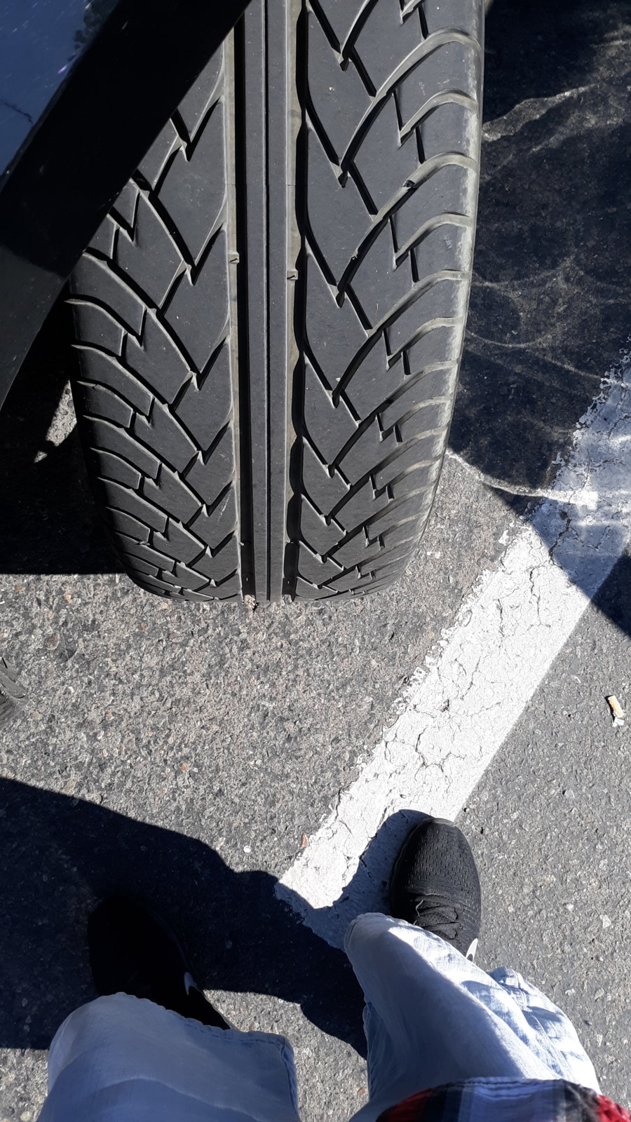

Is the shake all the time? Or at diffrent speeds or just around one speed? Check everything the guys already said, i would also check your rims /wheels ! You might have kicked (lost/ fell off) your wheel balance weights. Maybe ripped the cables inside the tire causing a bump!?!? If you got some cheap tires from china, just saying if you did ! Cuz i did, the tire will split the middle! Not visual unless tire is removed. It splits inside . You can tell from checking outside too, well make a really good guess. The tire is in the shape of a "M", like if you put a strap / chain around the middle of the tread and filled too much.the first one is new and the second is split. So many! Sorry suturing on the same pic.
