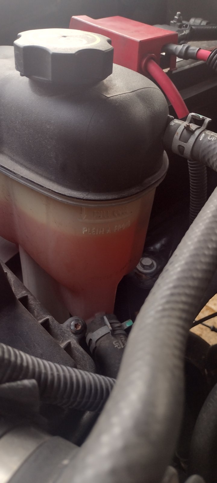

Alright, it had 12.2 V this morning, cold. And 14.8 within 2 minutes.
12.2 seems a little low.
Also attached is my coolant level, cold. The truck is parked on a slight incline.
after you have driven it for the day and have parked it, then check the voltage engine-off record the voltage, then check it again tomorrow again before you start it. and compare
coolant doesn't really look very low, mine will sometimes rest just below the cold line. depends on how it was last flushed.
