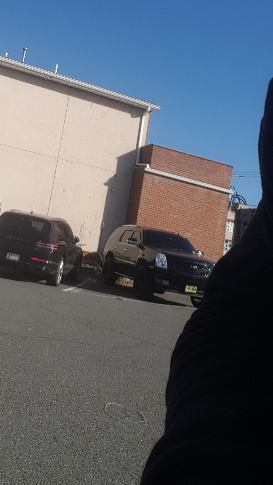

Brake caliper bracket pin was seized. The passenger side was also alittle hard. Replaced both brackets with new hose aswell. Problem resolved. Now alignment tomorrow
Not a great pic but all i have for now

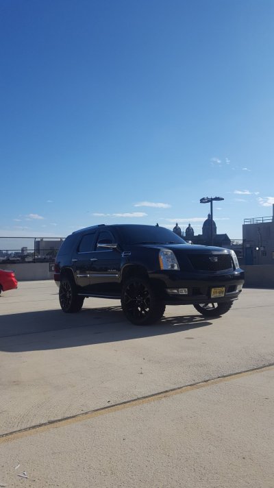

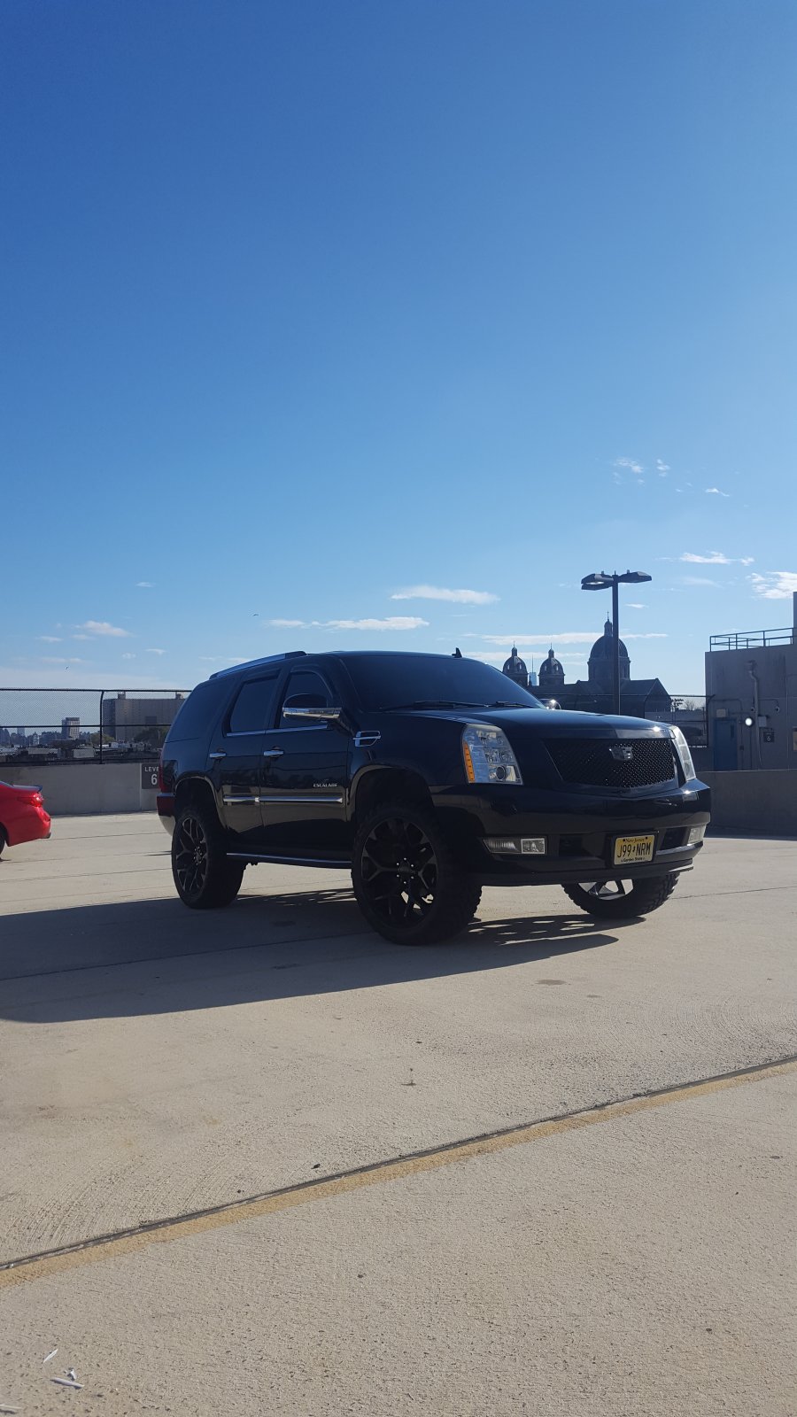

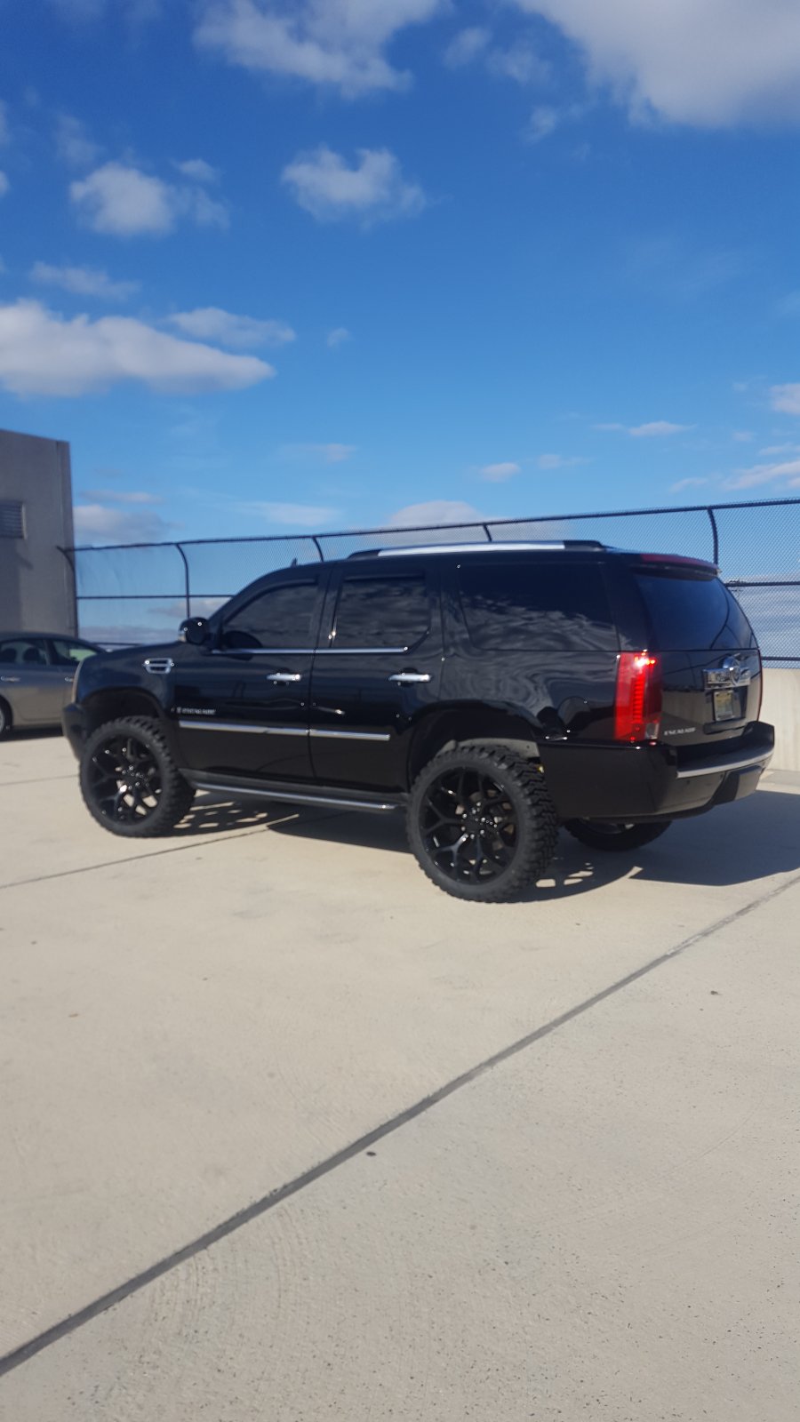

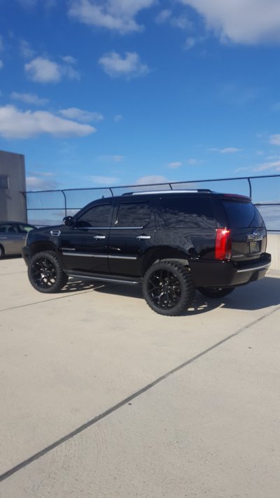

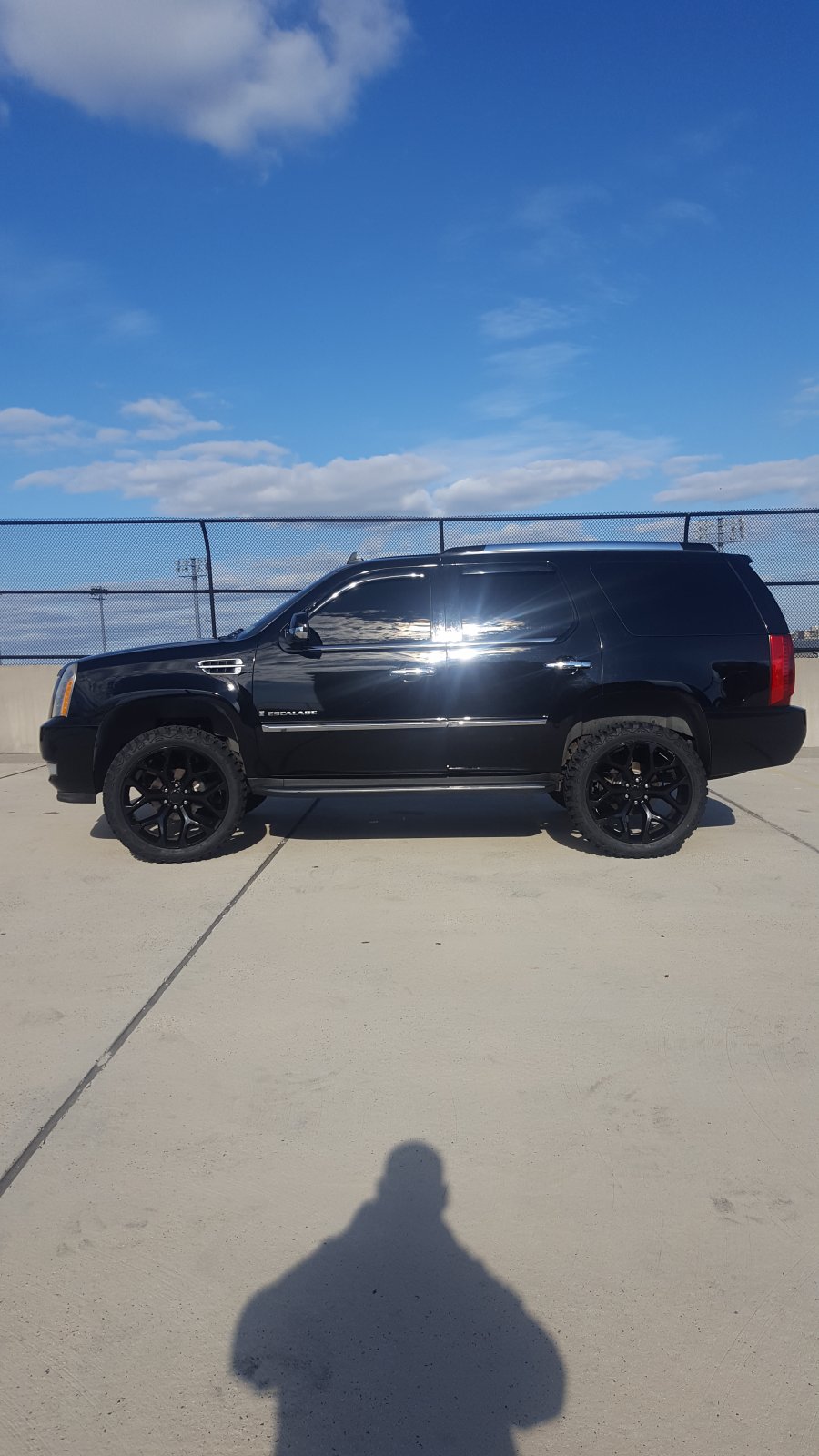

Washed her today and got some pics.
