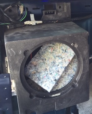

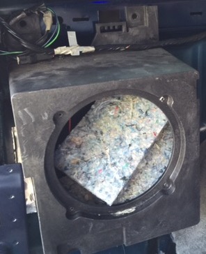

Great advice guys. So my first small project while recovering from neck surgery was to install the Kicker 8' sub bass. I had to hog out the box for the sub to fit. The old dremel did the trick. Used some wood screws to secure the sub and in it went. The sound is great. Dialed it back a bunch.
