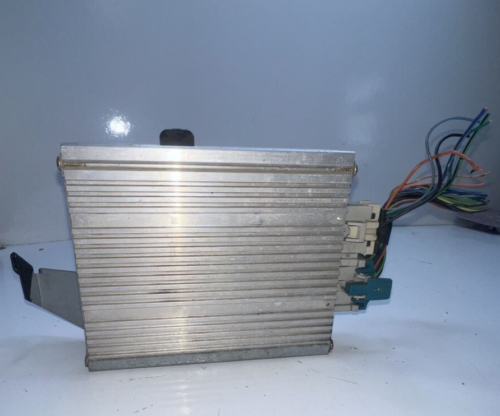

OK, for anyone who's removed the factory amp before, how did you get the smaller of the two plugs out? I'd like to find the engineer who oriented that type of connector facing away from the inside of the car. I've tried multiple things to push on the tab (this is all blind, because I can't see the other side) and release the connector with no success. I've tried using my finger to push it in, but apparently can't exert enough force to clear it and push up on it at the same time. I'm close to just prying the entire plug out of the amp, since I think it's bad anyway and then remove that harness when I can have better access to it. It's the top connector in the picture (stolen from the Internet)

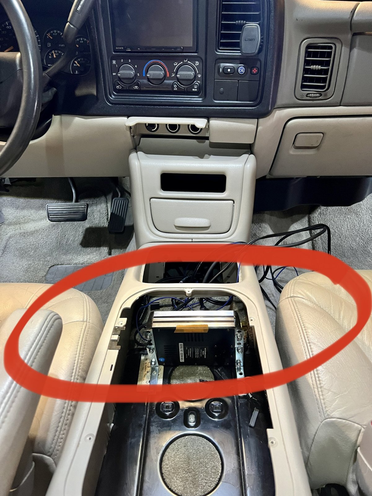

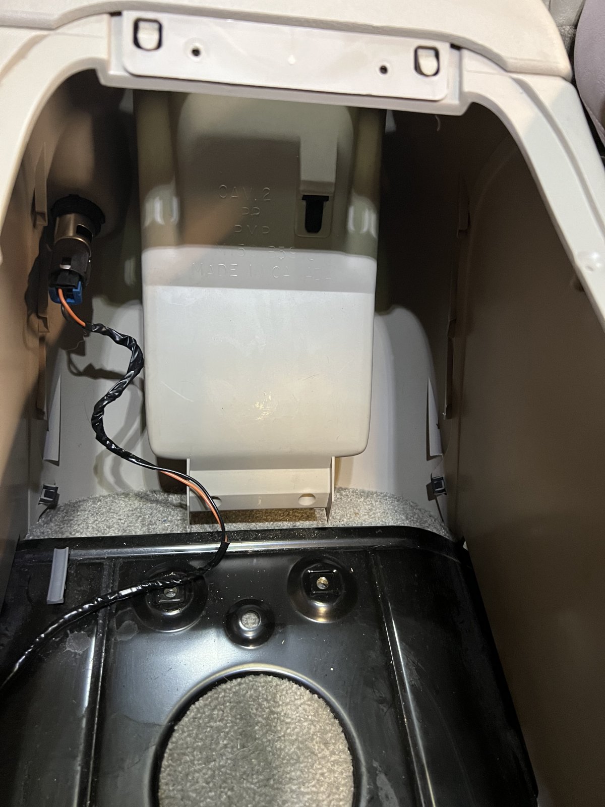

I was undecided but after driving/listening I decided that the OEM amp is adequate or maybe a little better than that for all 6 speakers except the subwoofer in my 2001 Yukon. I’m using a Sony 2X20W double-DIN head unit with all new more efficient speakers and volume / clarity is fine. The low/freq bass is thin though … might as well take advantage of the new sub’s capability.
The OEM amp under the glove box is installed well, runs cool. And it’s already wired up to all the door speakers. It’s tempting to get a second amp but the speaker wiring to the doors and rear pillars is a lot of work.

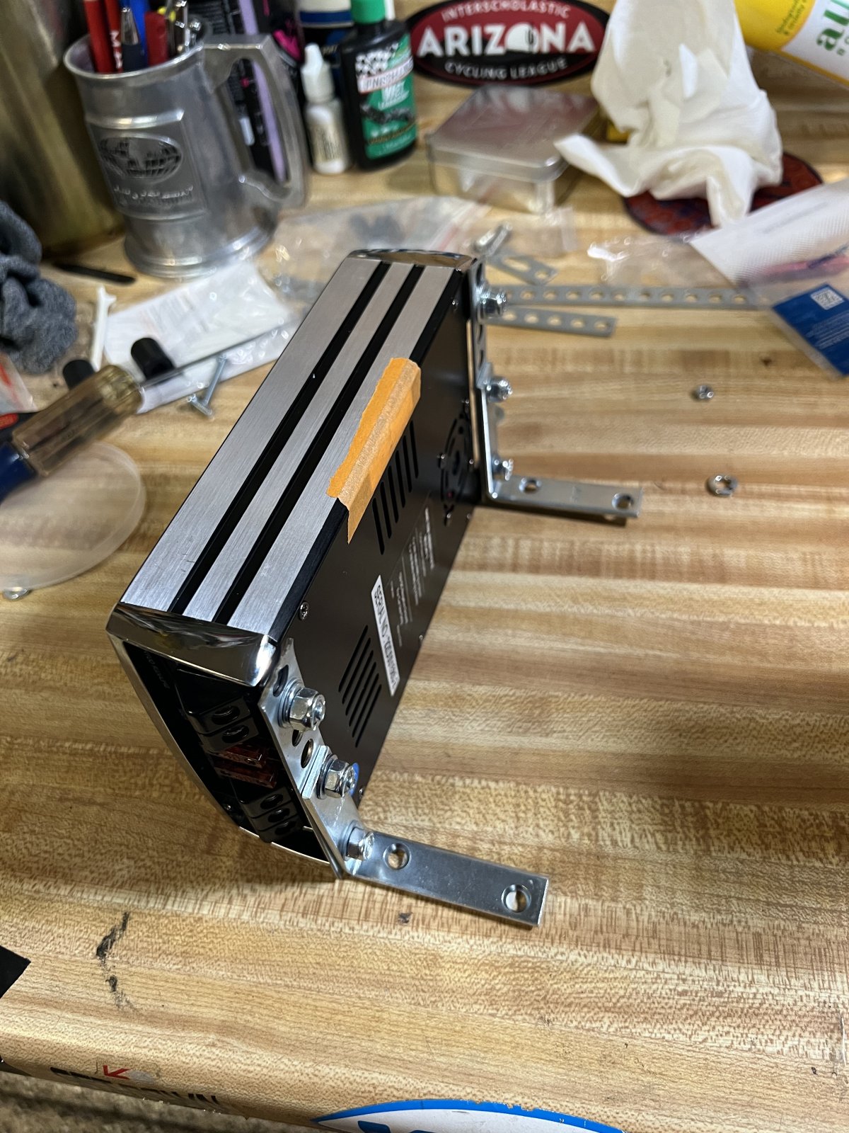

However I’m also adding a Crutchfield store brand (Sound Ordnance) small footprint 1X300W fan cooled amp for the Polk Audio 8” subwoofer. I’m installing the amp vertically on L-Brackets between the cup holder and the console box in the center console. I ran the super-clean low-level signal in to the amp on RCA patch cables, and the amplified signal out on 14-gage wire down the driver’s side floorboard trim mounting rail. I might try grounding the amp to the metal console box mounting frame, but will need to grind some paint and test the resistance. Can’t find a really good place to ground it. Maybe under the seat, on one of the big seat mount bolts?

seat mounting bolt/post is a good grounding spot
as for running a amp for door speakers it is only necessary to run wires from the amp to the factory vehicle harness (in dash area) that splits to all the speakers the factory wire is good for about 200w (per speaker) so unless you are trying to go get a trophy the factory wiring is fine, you do not need to run new wires to all the speakers.
