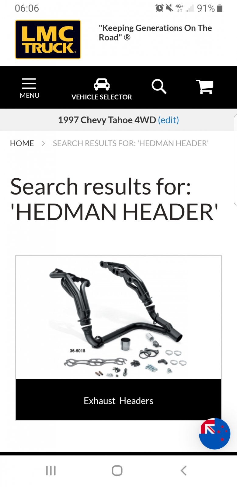

I have the same setup in my 97 Yukon.
Shorties are pretty much your go to.
Tuned length performance wont fit unless you drop your front driveshaft.
Lcm truck do Hedman Headers.
These are shorties with 3" coĺlectors that have a 3" performance tube or balance pipe that connects the headers together producing 1 3" collector out to either a high flow cat then exhaust or your choice of rear piping.
You can get your headers ceramic coated.
A powder coater will do this.
It will create performance by keeping the heat inside the pipe and dropping engine compartment heat.
I'll see if i can track them down and I'll post em up for you.

I think these would be a Yeah Boi!! Change in performance for your rig!!
