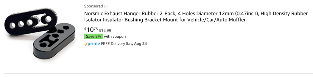

Thanks guys. All great ideas. Soo hard to choose which one. I might start with loosing the clamps on the two pipes behind the muffler then wedge a bar in between and then tighten then back up. If that doesn’t work I’ll try bending hanger a bit. Or I might just get the rubber hanger with various holes. I don’t need much. Maybe 1/16 inch if that.
