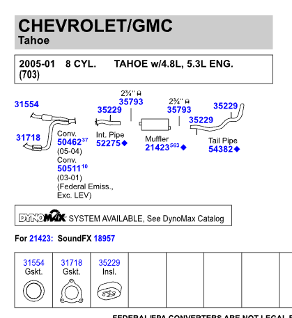

Update: I called my local dealership to see if the parts were available, and they told me its a ball type flange and does not use a gasket. They also said the studs are 30 bucks a pop... At this point I'm thinking regular old nuts and bolts from the hardware store. What do y'all think?
21,320
30,313
This is where I'm stumped... None of the diagrams I've seen show any hardware for the flange between the converters and the intermediate pipe.
There isn't, just bolts or a clamp depending on the style. Looks like that one uses bolts. Yes, use nuts and bolts. Gimme a sec...
Does yours use a double ended stud like the manifolds or a press fit on one end type?
15028620 or 11589264
Nuts are 15709703.
Should be able to cross these numbers to Fel-Pro to source faster locally. Use Rock Auto.
Nuts are 15709703.
I haven't gotten under there to see what the stock setup is like, but I greatly appreciate the part numbers. I couldn't find that information anywhere!
