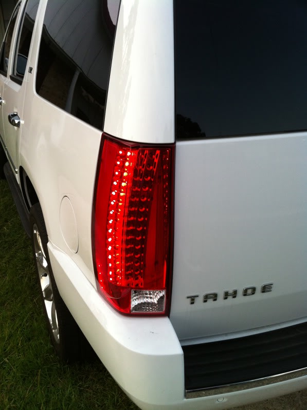

Do you have a pic of these Eagle Eyes?
Eagle Eye's make G4's and G5's. The G4's match the tahoe rear vent appliqué and the G5's are escalade replica tails that match the escalade rear vent appliqué. I had both on my tahoe. here are the pics:
G4:
G5:
G4:
G5:
thanks for sharing the pictures.
