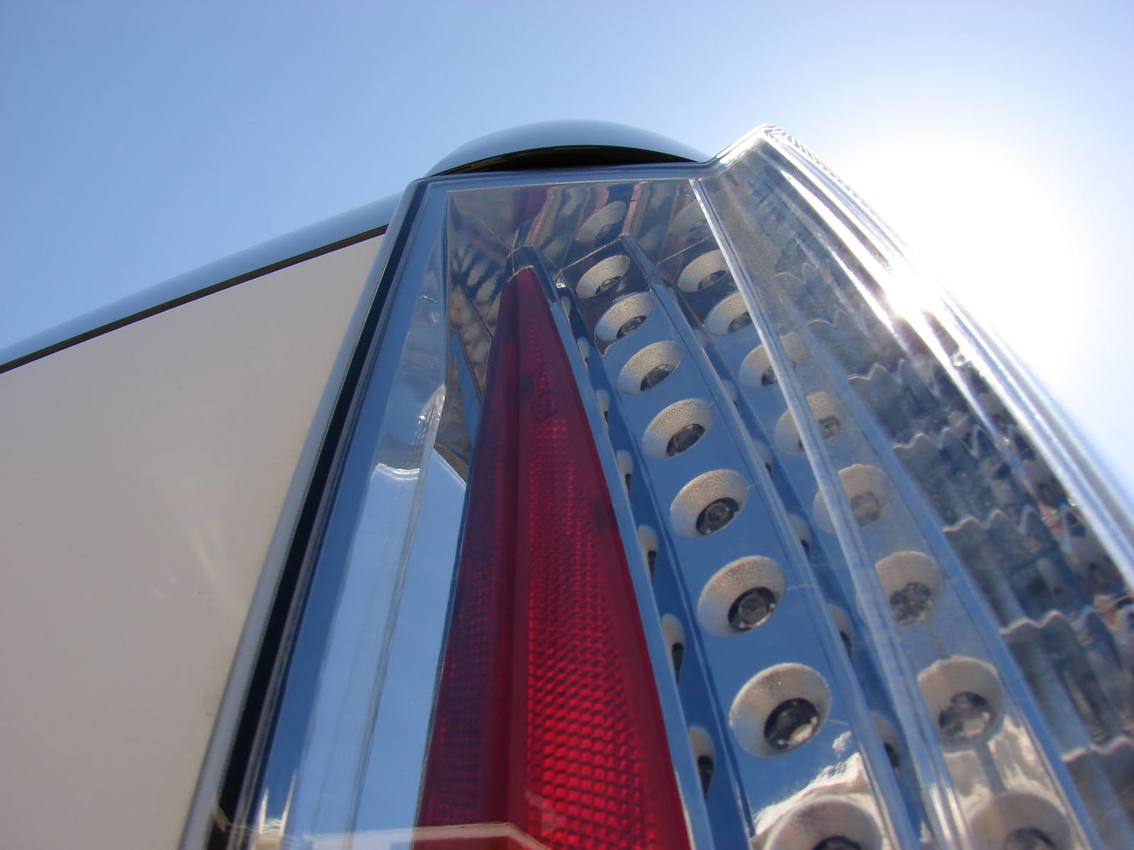

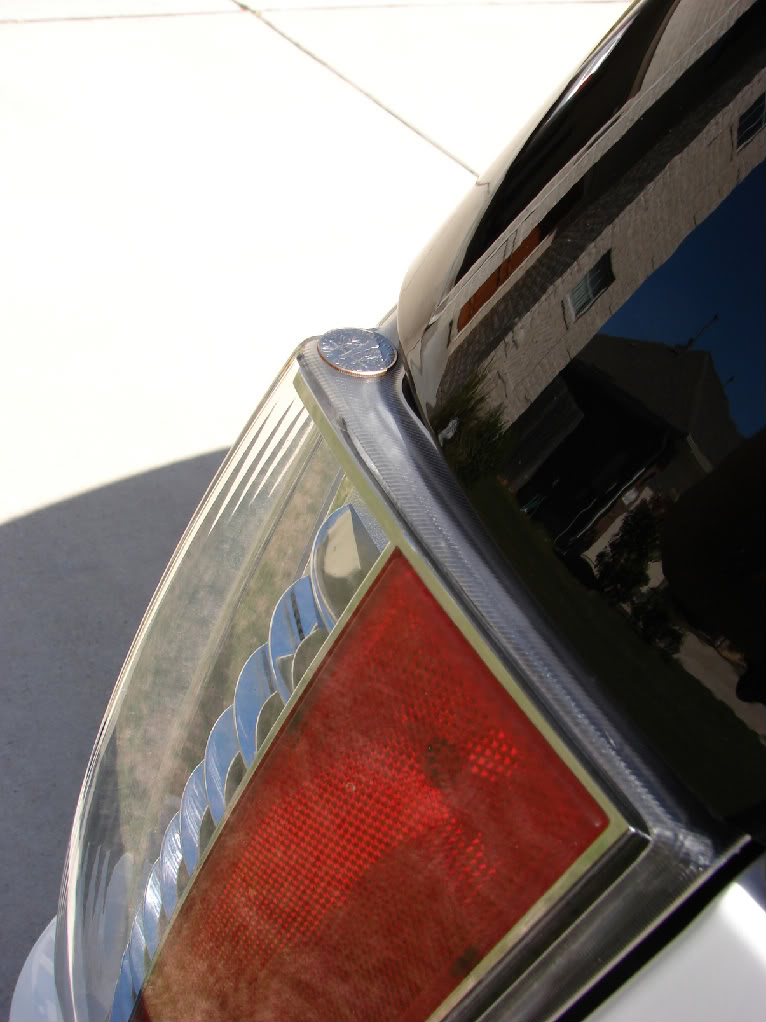

Do the lights stick out at all? Are they the same shape as the stock lights? I want to do this but it looks like they stick out a little at the top.
zach2011
Platinum Member
May 18, 2009
1,640
If you keep the stock pillars above the tail lights, they do, but if you get the Escalade ones they kind of match the shape. Not really a noticeable difference though, unless someone pointed it out.
The Esky tails are shaped differently from the Yukon/Tahoe appliques, but it is less noticeable than you'd think... IF you look at it from the top or bottom it can be seen, but otherwise the difference is minimal...

Great write up, I've been looking for something on this subject for quite a while. However, the edge that sticks out has thrown me into turmoil now as to whether or not to do this mod.
73shark
May 5, 2009
152
KC, MO
Welcome to the forum.
You have two options, one is install the Esky applique which has the matching square corner or get a set of Eagle Eyes which match the OEM Tahoe contour. They are also plug and play.

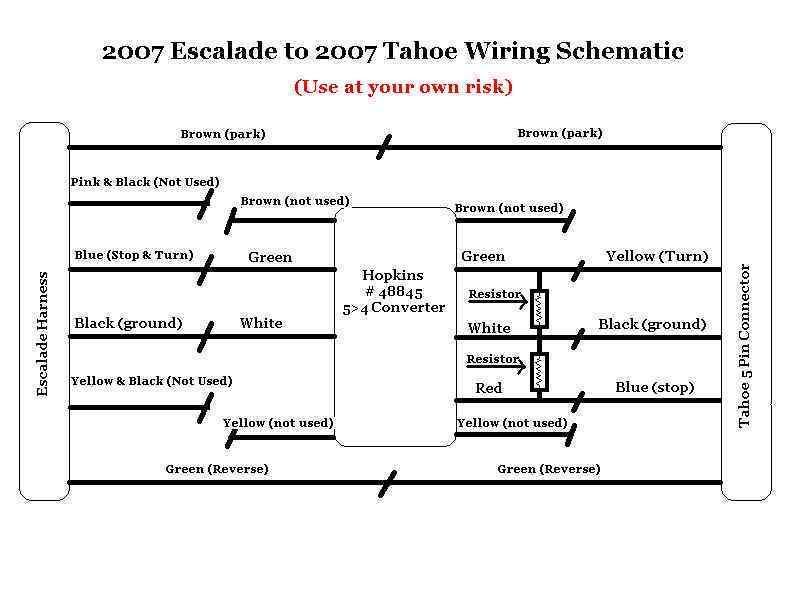

wiring diagram for escalade tail light swap?
the pictures of exconn has been removed, can someone show me how to wire up the escalade tail lights to my 2011 suburban? does anyone have pictures of the wiring diagram?
---------- Post added at 07:54 PM ---------- Previous post was at 07:16 PM ----------
can someone show me how to wire up escalade tail lights on my 2011 suburban since the pictures has be remove from this forum

Just thought I would throw this out there...
I bought the correct harness to install the Denali light into my Tahoe from an online Chevy Dealer for $24 each. Plug and play - took 5 minutes to change both lights. The Escalade harness was the same price.
By this time you buy the adapters in this DIY, I'm not sure that you save much time. Just food for thought...
Nice write up for those that have the time and want to save some $$$. :waytogo:
Is there a harness that can be bought to by-pass all this wiring? If so does anyone know the part numbers?
