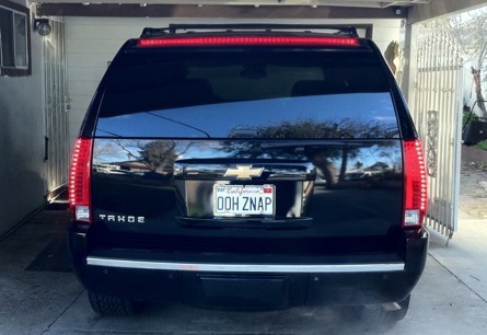

Installation DONE:
Esky Rear Bumper W/ Hitch Cover
Esky TailLights
Esky Top corner vent pillars
Esky 3rd BrakeLight
Esky Roof Rack W/ Cross rails

So I did the swap last week on my 08 Yukon. Everything worked perfect. Until I was driving behind my truck one day and noticed the turn signals on the esky tail light and my dl3 mirror don't match up only when the brake is pressed. So if the brake is pressed the blinking is opposite but as soon as I left off the brake they sync back up and everything is fine. Is this normal? The turn signal clicker inside the truck still clicks just like normal.
I am here: http://maps.google.com/maps?ll=35.350182,-119.049502
GalaxyBlackEsky
BlackedoutLT3
May 13, 2009
2,524
12
MD
Yes it is. Minee does that with the OEM Esky Tails. Doesn't bother me. I kinda like the way it does it. But it is only when brake is pressed.
1STIMEYUKON
Dec 16, 2009
140
bakersfield ca
yeah it doesnt bother me at all. i was just making sure i didnt mess up any of the wiring, because the white and black wires to the resistors got a little confusing. speaking of the resistors i riveted the resistors to the tail lamp pocket behind the actual light. and wrapped the wires that were close with aluminum tape to protect the heat. i can put pictures up if someone would like. its just a different way than mountin it underneath the truck exposing it to the elements. next up is the 3rd brake light. probably next week.
