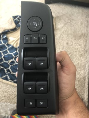

Received my switch today. Getting closer to surgery day lol

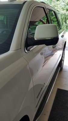

Were you able to get the mirrors in White First Tri Coat?? I just bought a pair of Escalade mirrors that are Crystal White Tri Coat and I'm anxious to see how close they are in color.
Picture is Escalade White Tricoat mirrors on Denali White Frost Tricoat. I Can't tell the difference enough to spend the $$ on getting the covers repainted. The bugs can't tell either...

I agree, it is not close enough to the other painted parts for anyone to notice. Can you tell a difference it the viewing area from this to stock since you have had a chance to drive it?
Yes, the difference in safety and vision is very noticeable and well worth the cost and time to switch out the mirrors. Something GM should have done from the on start .
Then again, one can just buy an Escalade but a bit too much Bling for me..........
