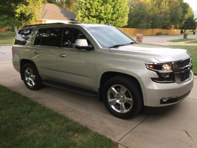

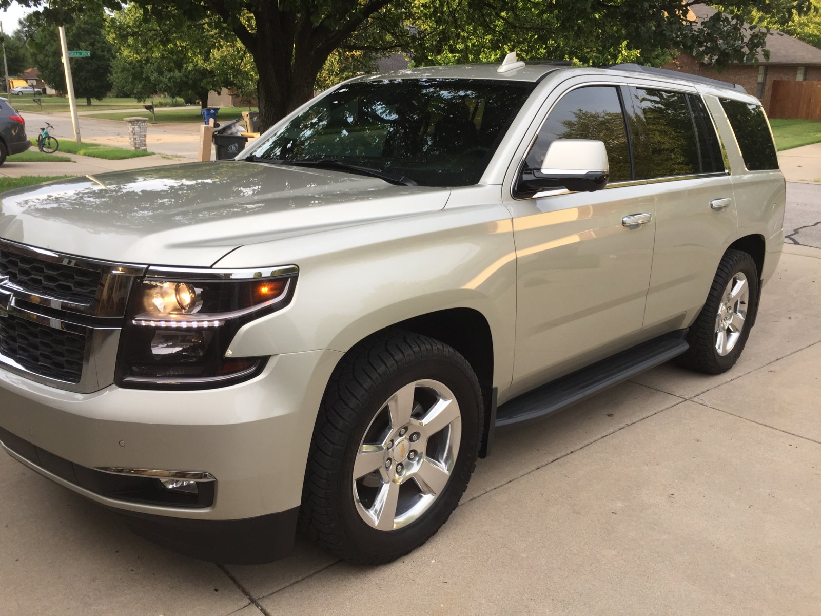

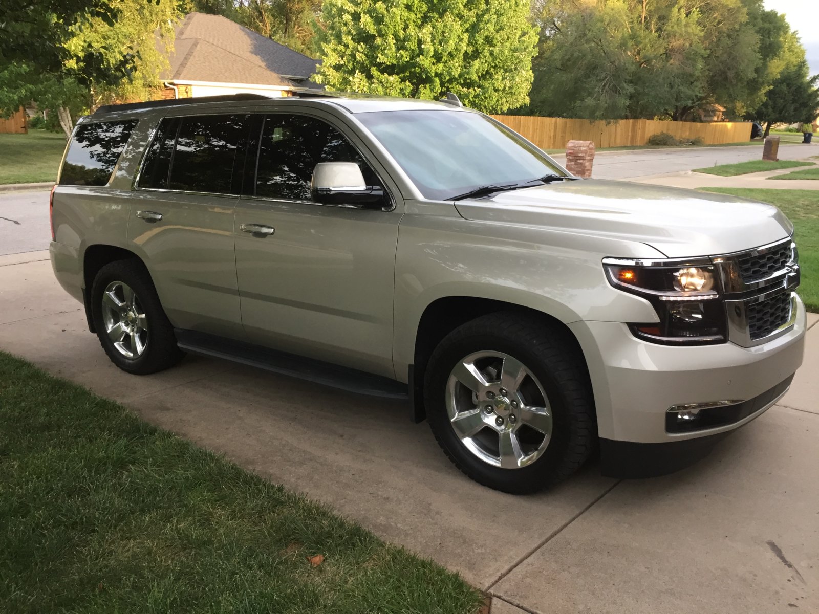

I don't know how to post pics on here, but I finally got my mirrors changed out. Didn't upgrade the harness or anything fancy, basically just swapped my Tahoe mirrors with Escalade mirrors.
Thanks for all your help guys! I love the bigger mirrors already!!
Great to hear! It’s my favorite mod and people will notice something is different too and start asking you how they can get them on their truck!

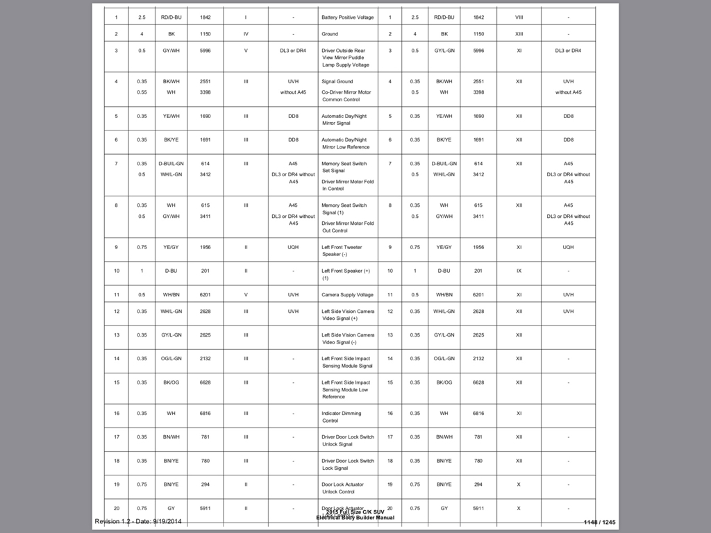

Could you help me out. Is there a difference between the front and rear door handles. Then wiring, how did you hook them up and how may wires are there on the handles. Some on ebay i see 3 wires and some i see 5. More information on this mod would be wonderful as i am trying to do this
cmatt
Apr 29, 2009
637
702
The front handles are the five wire. Rear are the three wire. There’s a ground wire and one for the handle led. The other wires are for the keyless access.
As far as the wiring goes, the challenge is getting the puddle lamp circuit to the handles. If you already have the puddle lamps in the front mirrors, that circuit is in the front door harness and landed in the mirror connector. You can splice into it and run to the handle connector. BTW, the Escalade handle connectors were keyed different from my Yukon’s. You can either shave off the keyed part on the door harness side with a razor blade, replace it with the correct connector or just swap in front and rear Escalade door harnesses like I did. You’ll have to get the puddle lamp circuit landed in the body side of the rear door connectors. I spliced into the gray/green striped puddle lamp circuit wire in the body harness along the lower door sill on each side. That’s it in a nutshell.

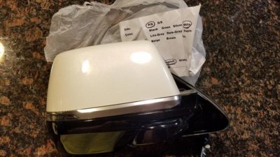

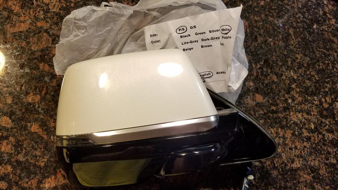

Mirrors arrived yesterday, nicer than I imagined . It looks like they are Crystal White Tricoat which is close to my White frost Tricoat, might not have to repaint them. Extra door clips on the way. Great thread and can't wait to install them.

Well, back to ebay. The mirrors are beautiful, great price but didn't realize that they do not have "Blind Spot" , do everything else but not that. Sending them back , bought two more for $100 more but with the Blind Spot and also "white". I overlooked that thinking all would have it. Door clips arrived but it will be next week before the new mirrors will get here. Need to read the discription more carefully next time..... got too excited but no sense eliminating the blind spot and saving a $100. At my age , I need all the help I can get!!!
ncpepperman
Dec 15, 2017
108
68
North Cackalacky
Well, the new mirrors arrived today. Nice chip out of the driver's side but they do have "blind spot" warning. But , to my chagrin , they are missing the puddle lights and one camera....
Perhaps this upgrade is not meant to be. Any idea if the puddle lights from the stock Denali mirrors will fit the Escalade housings? Happy with the blindspot but the puddle lights would be nice.
I failed to realize that there were so many options on the 15-17 Escalade mirrors. No writing of any kind on the passenger mirror. Looks like I'll have to buy an Escalade if I want the mirrors...
