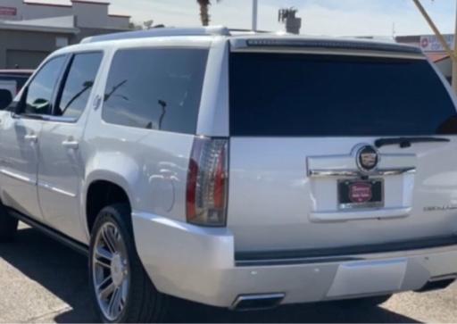

Here’s the skinny on what’s cooking from 07-14 in regard to model year changes. 2011 is also when you get access to the Premium trim with Platinum features. Specifically the Uber cool dual chrome rear exhaust that exit the bumper facia, smoked rear tail & brake lamps, the same Plat 22” rims & the Platinum’s CTS-V like front facia without tow hooks.
The hot ticket was Premium trim w/ adding the factory option of the Platinum’s LED headlamps. Here in Cali they are uncommon in ESV configuration, but definitely the one to get from an investment perspective. They’re one of GM’s best looking vehicles ever produced.
The thing I like most about the LED headlamps is you never have to change the bulbs. Admittedly the standard Escalade HID projector beams are slightly brighter but they don’t match the spread that the 5 LED put out plus 2 more for high beam per side.
