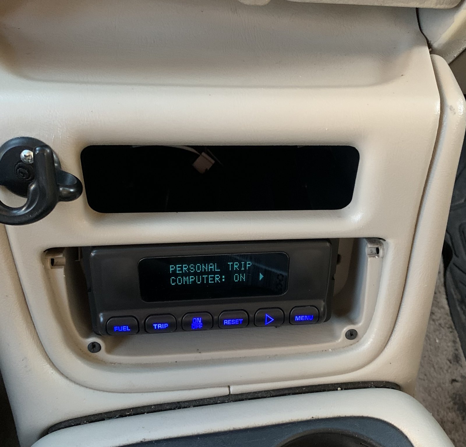

Does anyone know if you can take a driver information center module from an Escalade or Denali Yukon and put it in a Tahoe? Looks like it would fit in the little cubby hole. Has anyone done it before? Just curious. Thinking about trying it.

I did install it a few days after making the post. It was super easy to install a total of 7 wires. I have an aftermarket radio so I pulled power, switch power, ground, illumination, all from it. 2 of the wires are switch power, 1 is ground, 1 is constant, 1 is illumination. Vss is tapped from the cluster and data is tapped from I believe the purple wire on the OBD 2 Connector. I will post the diagram and wire colors and when I get a chance. But here are some pictures. It fits okay. If you push in side in. It’s not perfect but it will do and works

I will post the wire colors for everything here once I gather all the information I used and even the diagram. I hope that it helps someone else on their journey. I have had it in for 2 weeks or better now and I absolutely love it.

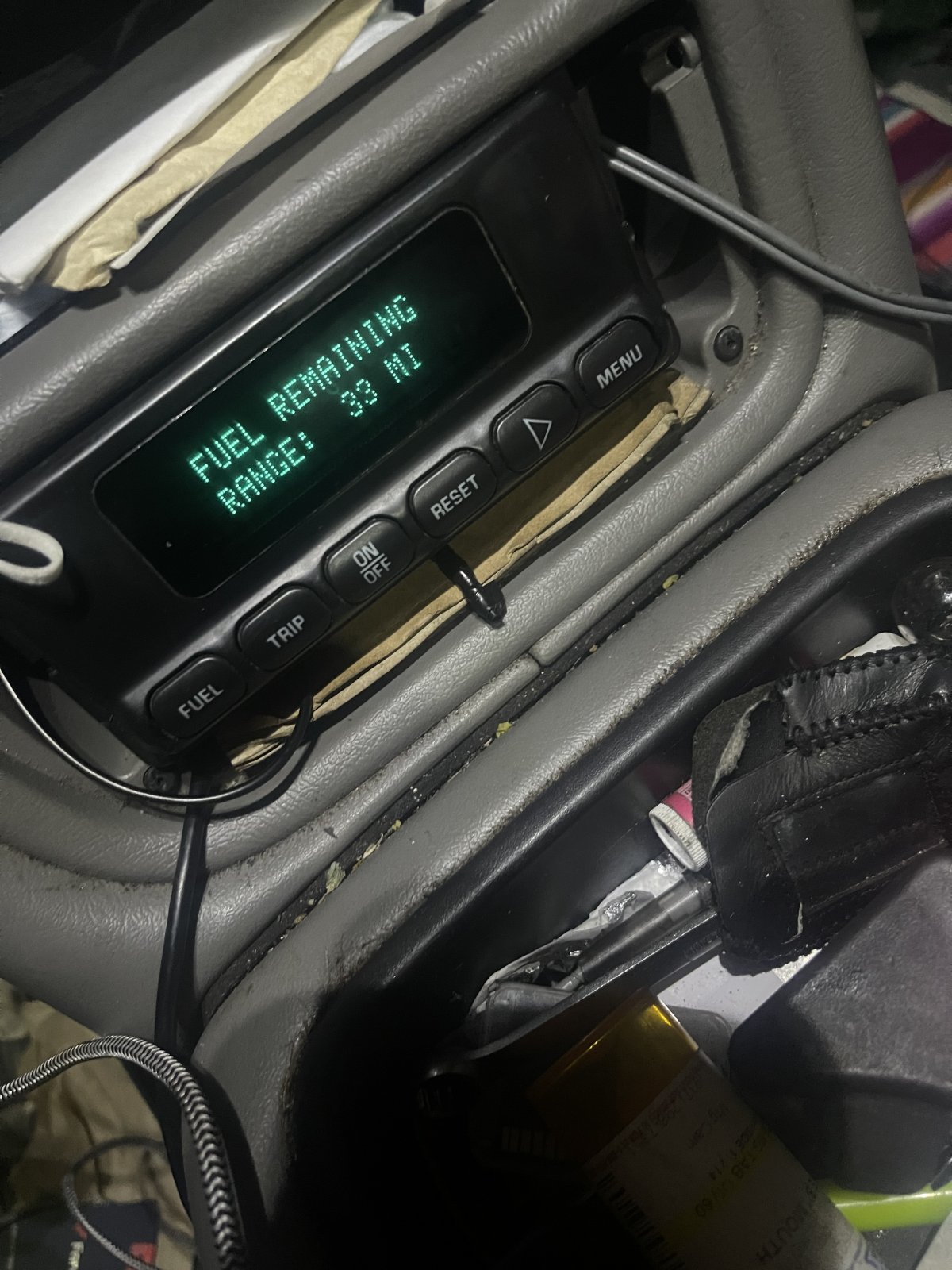

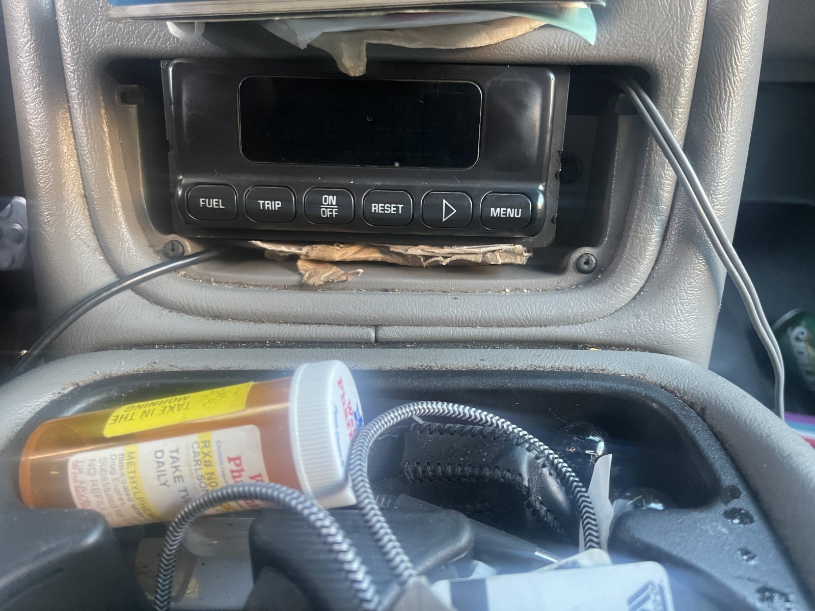

Same place I put mine today. I really want it in the overhead console where my rear a/c control is now so it's just a quick glance up to read it like the rear view mirror. And then everyone riding along can see it too

I'm not sure yet actually. I'm still working that out in my head among other things. What I'd really like to do is an iPad in the dash. And I mean: relocate center vent and main a/c controls to make room. So I would most likely have to mount both front and rear climate controls in a different center console. But, all of that is a maybe and way down the want list anyway
