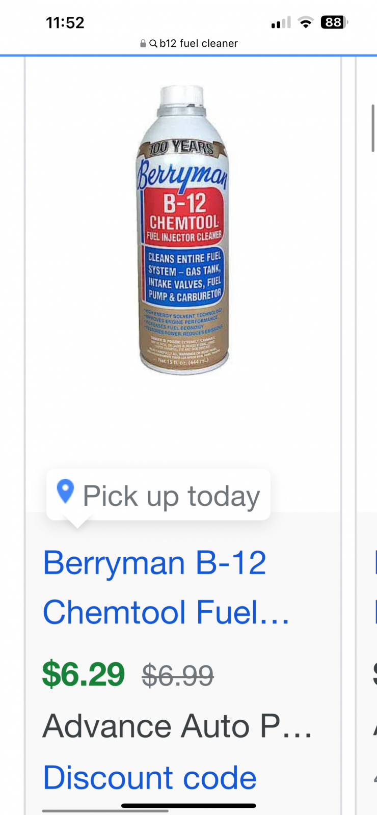

On my higher mileage Tahoe 87 would cause it to spark knock it almost sounded like a rod bearing was going bad I put some B12 in the tank and never had the issue again so whenever I run cheap gas I always throw some B12 or a lil marvel mystery oil in with it and it helped eliminate the spark knock

I will look at that B12 some more. I have added cleaners, not necessarily octane booster. The cleaners were Lucas, and Amsoil. They both said it should eliminate the predetonation.

Another note, I got that B12 and put it in last night. Ran it for about an hour. Towards the end of that hour, I was revving it up to about 2500 and it would periodically go away for about 30 seconds. Then come back faintly and then loudly. So can't say if it's actually helping or not yet
