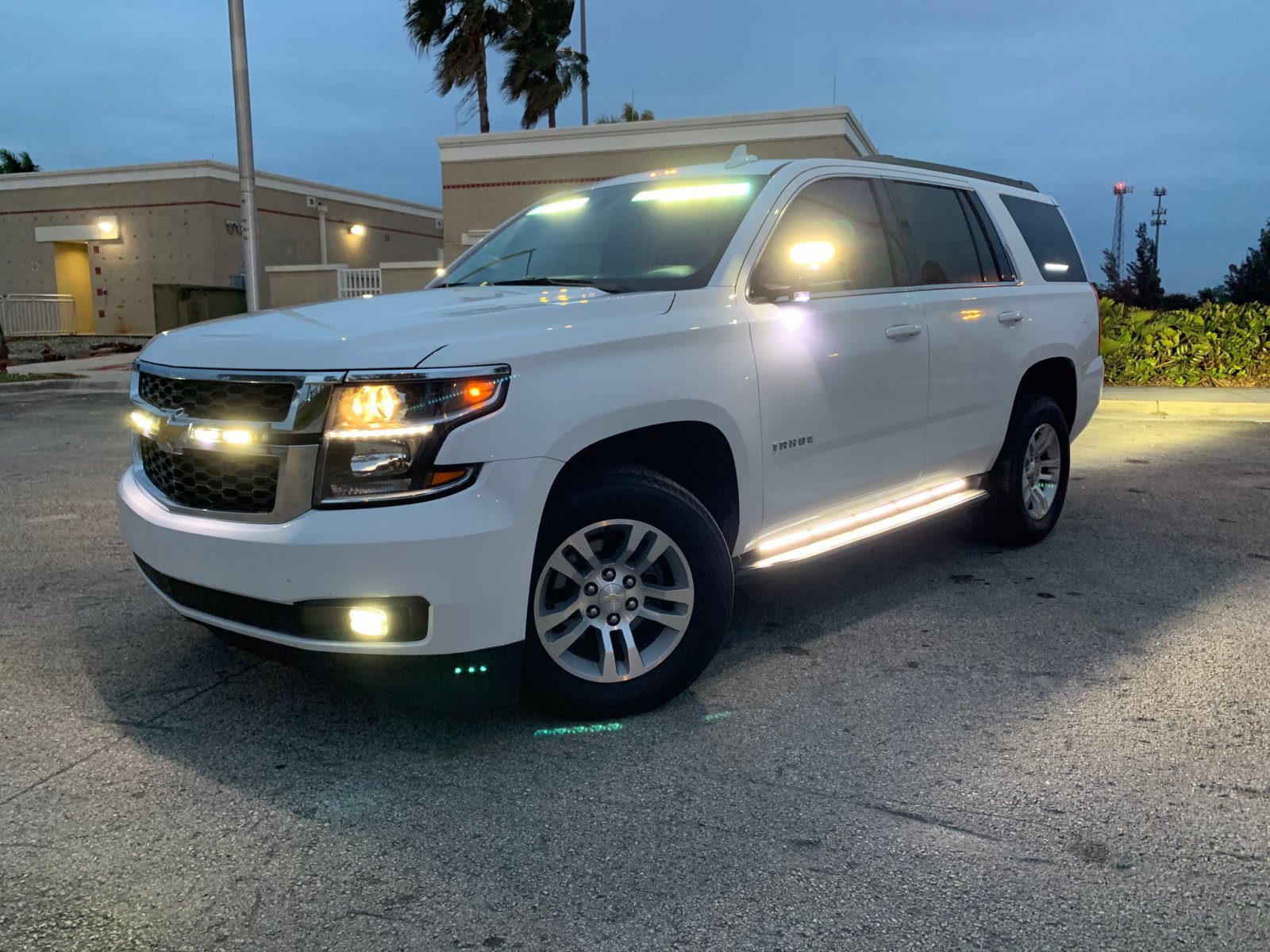

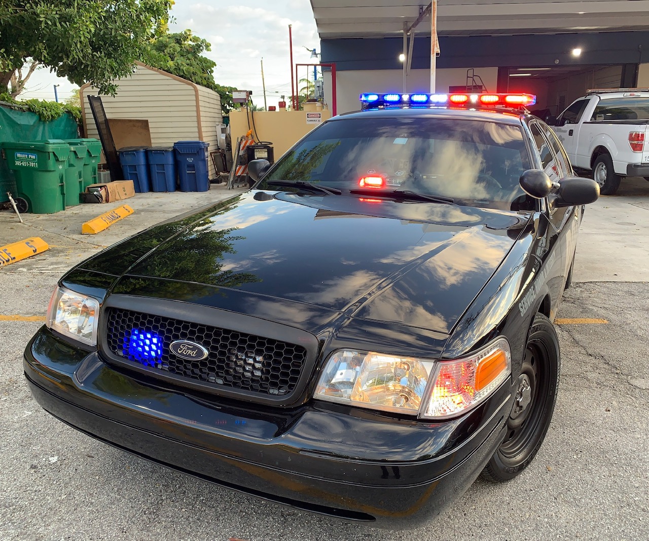

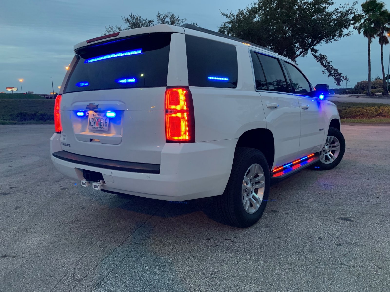

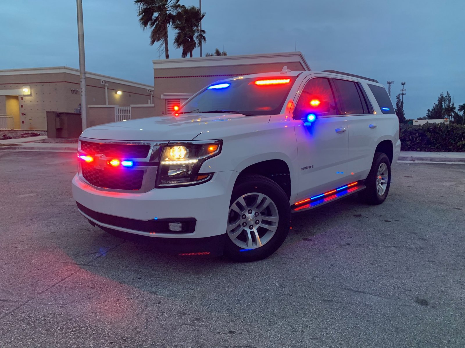

Here are my setups:

Here are my setups:
View attachment 253895 View attachment 253896 View attachment 253897 View attachment 253898

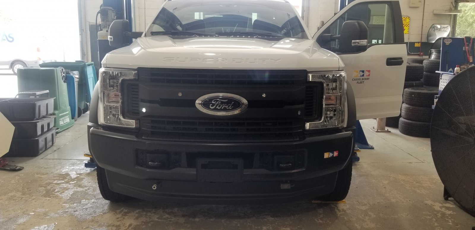

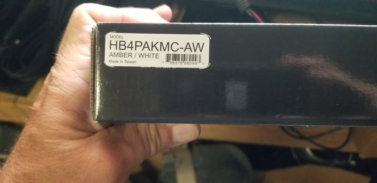

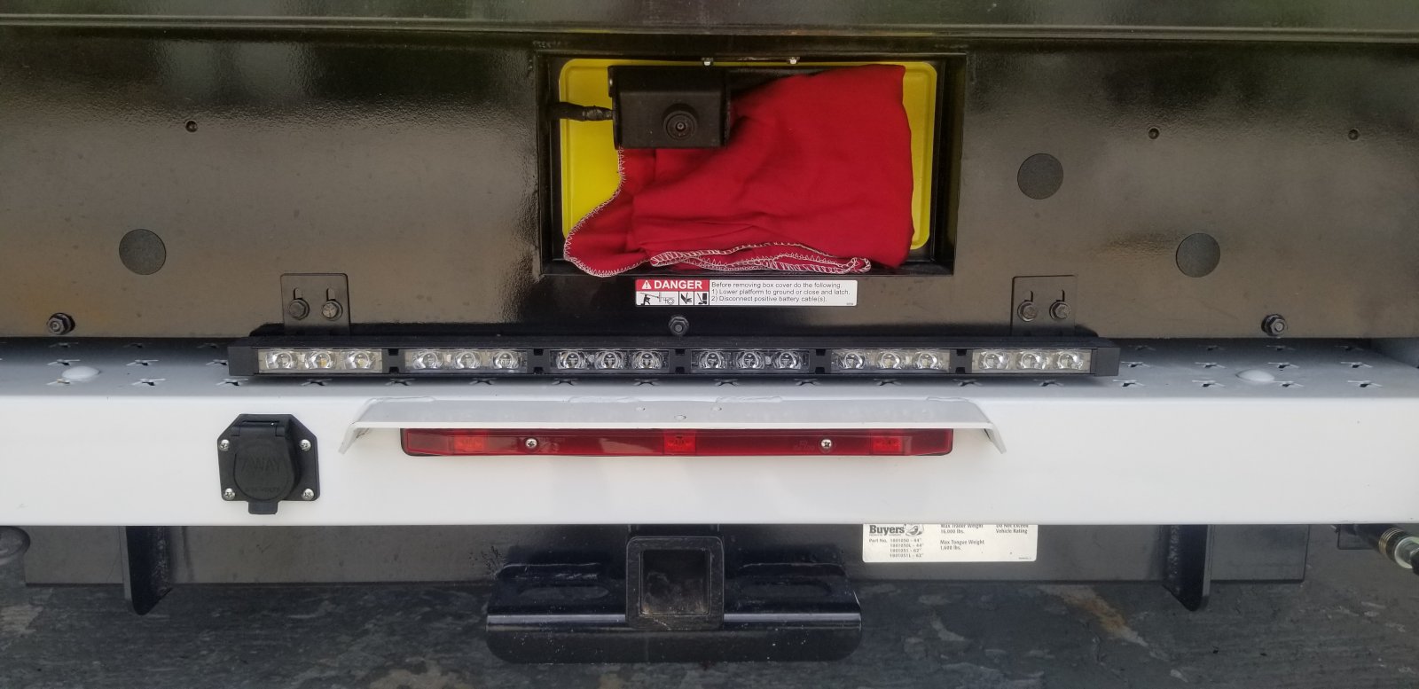

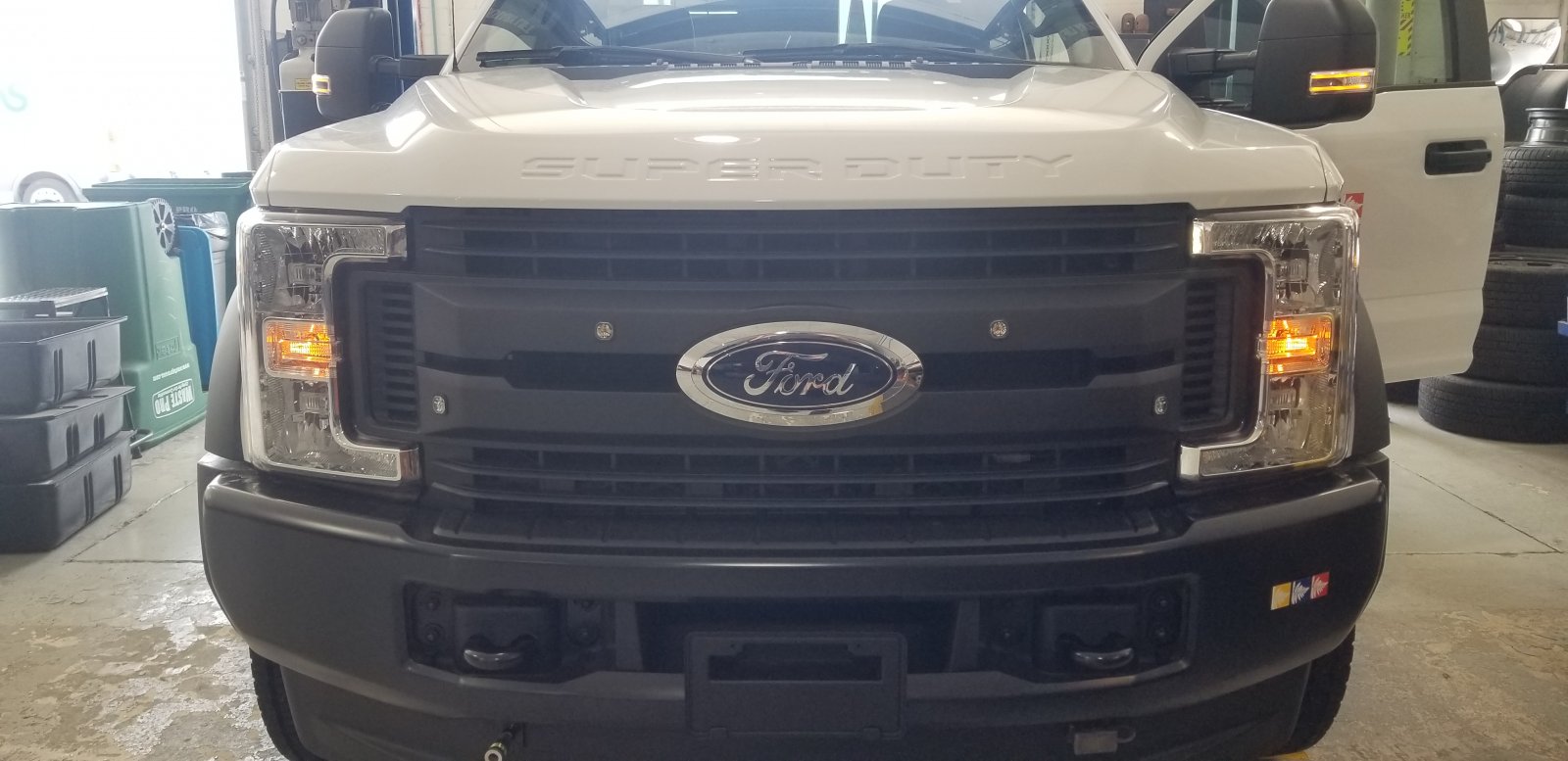

I also agree with GranPrix with using quality equipment. I also have been upfitting vehicles for many years. We use a lot of Whelen too, but Sound Off Signal, Code 3, Star, and. Brookings have many options that are more economical. We use those three on Public Works vehicles with white and amber. I like Code 3 #HB4PAKMC-AW ( amber/ white) for grille lights. They are super bright, multiple flash patterns. They come 2 to box, alternate from amber to white in same bulb. I buy grommet mounts, but you can get them as a bracket mount as well. I also use these in my unmarked police cars as red and blue. Spray a little VHT on them and they blend in like a back up sensor. I will try to put some pics up. Star makes some nice mini inside windshield lightbars with multiple functions. The Star light bars we use are model# ULB-28 for front snd ULB-38 for rears. You can get Tahoe specific brackets for these. We also use Brookings 6 head warning sticks with a traffic advisory function for rear of service trucks and or in the rear inside window.
Here in Central Florida most agencies use Dana Safety Supply (DSS). Lights and More does not have a good reputation here.
Pics and videos are on our 2019 F550 shop service truck. The fronts are the Code 3's, rear is Brookings, the side runners are Sound Off Signal (nLines), and the roof bar is also a Sound Off Signal (nRoads).
20200803_124614.jpg 20200803_124627.jpg 20200803_124711.jpg 20200803_124829.jpg 20200803_124912.jpg
