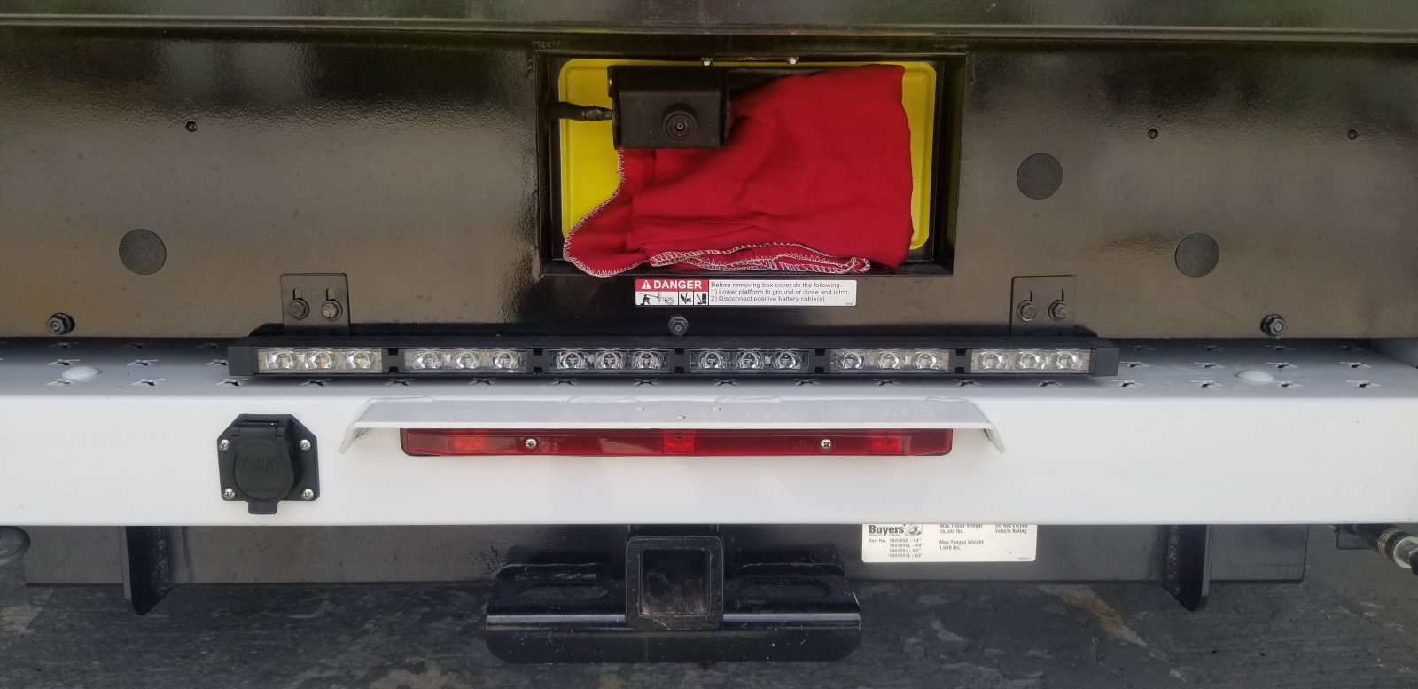

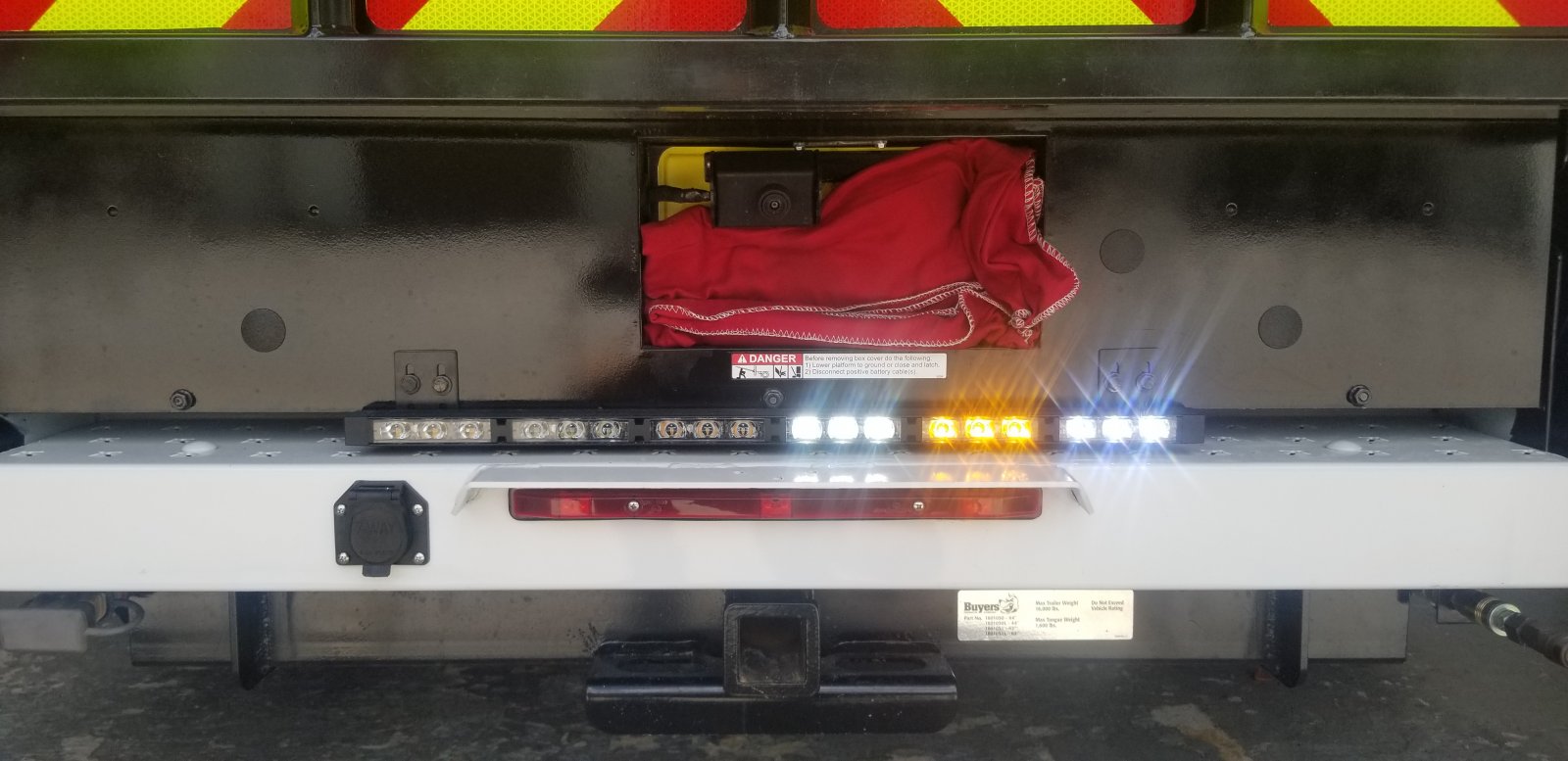

I also agree with GranPrix with using quality equipment. I also have been upfitting vehicles for many years. We use a lot of Whelen too, but Sound Off Signal, Code 3, Star, and. Brookings have many options that are more economical. We use those three on Public Works vehicles with white and amber. I like Code 3 #HB4PAKMC-AW ( amber/ white) for grille lights. They are super bright, multiple flash patterns. They come 2 to box, alternate from amber to white in same bulb. I buy grommet mounts, but you can get them as a bracket mount as well. I also use these in my unmarked police cars as red and blue. Spray a little VHT on them and they blend in like a back up sensor. I will try to put some pics up. Star makes some nice mini inside windshield lightbars with multiple functions. The Star light bars we use are model# ULB-28 for front snd ULB-38 for rears. You can get Tahoe specific brackets for these. We also use Brookings 6 head warning sticks with a traffic advisory function for rear of service trucks and or in the rear inside window.
Here in Central Florida most agencies use Dana Safety Supply (DSS). Lights and More does not have a good reputation here.

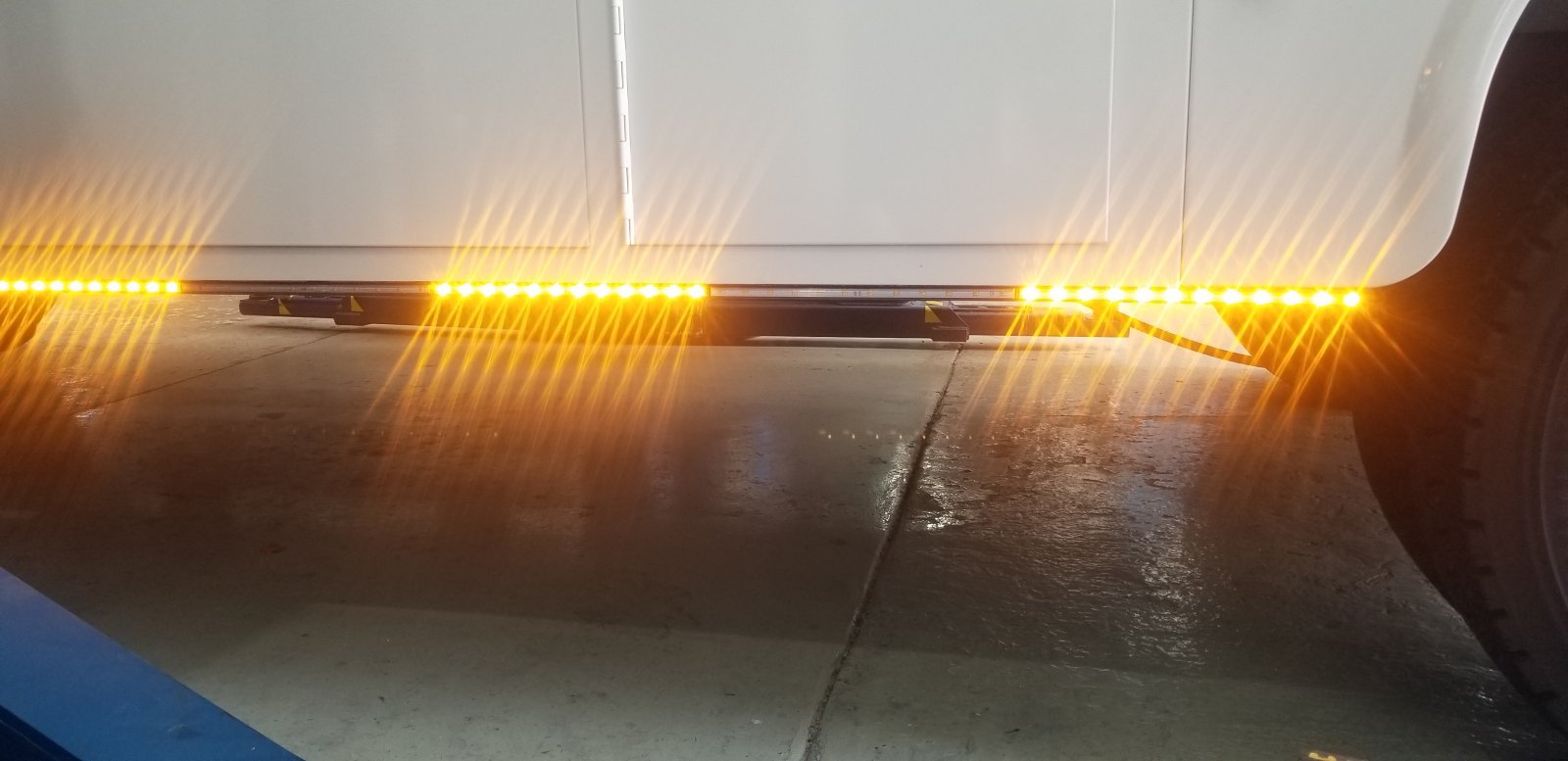

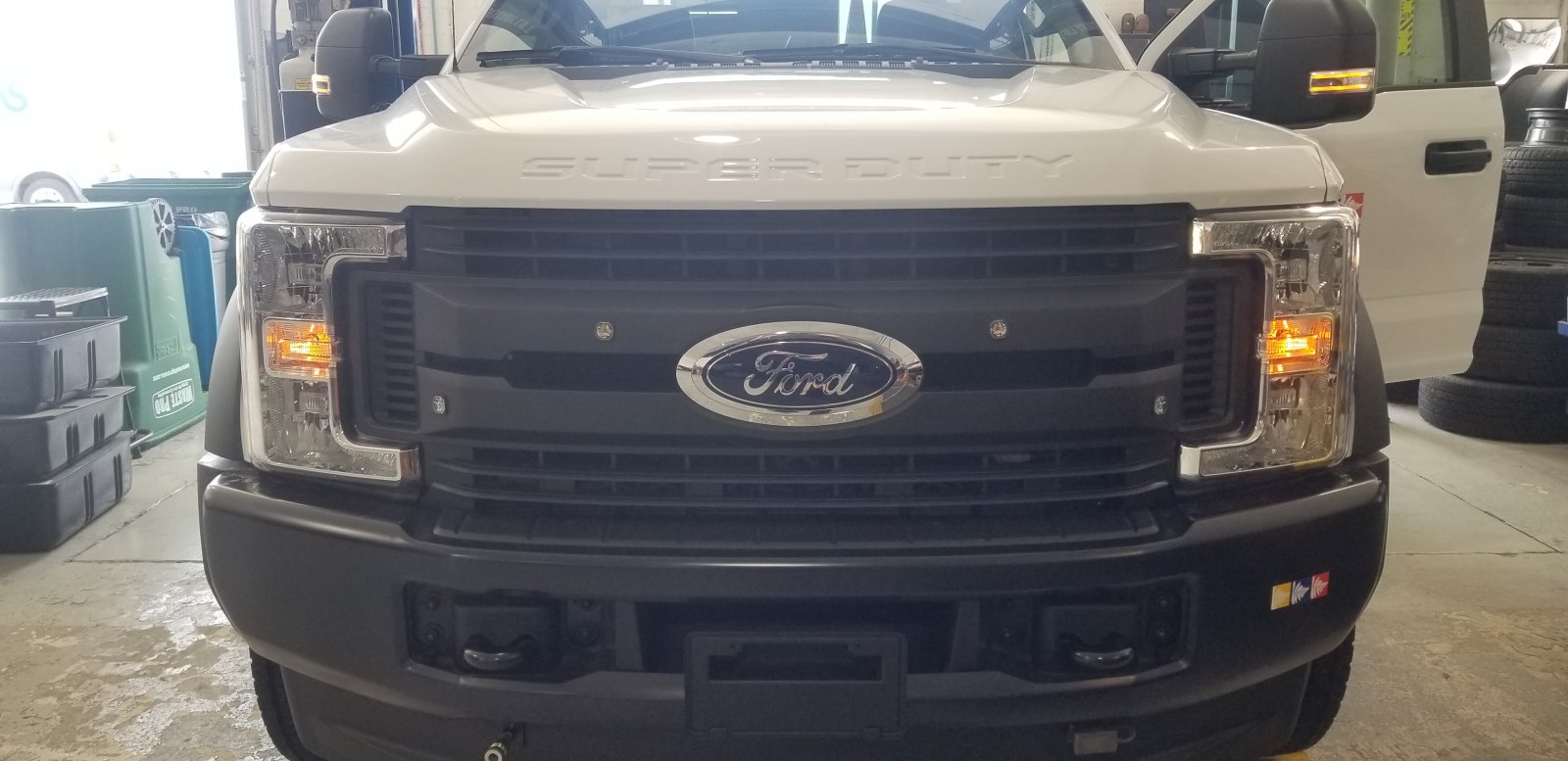

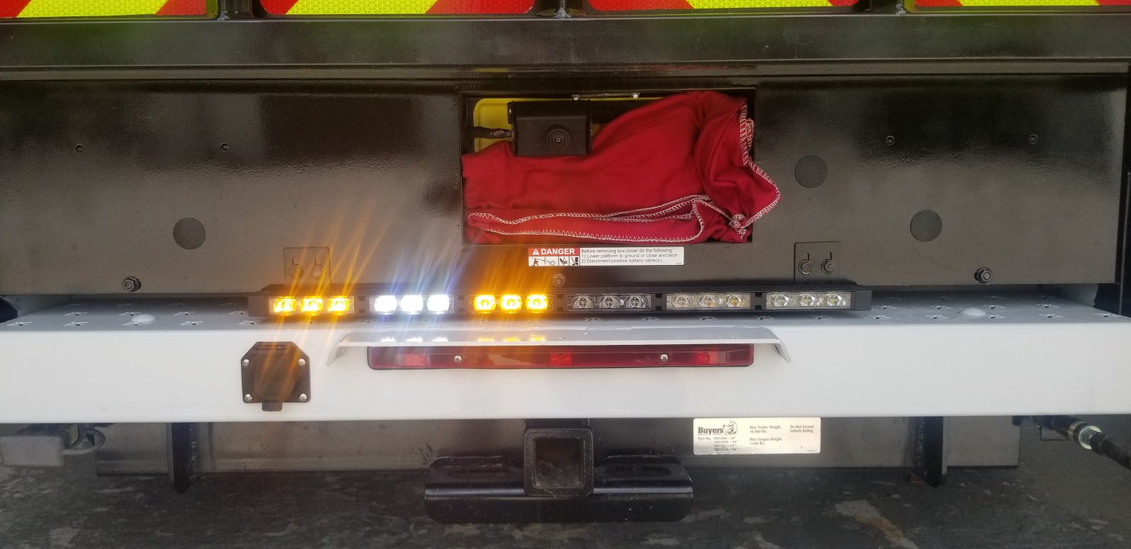

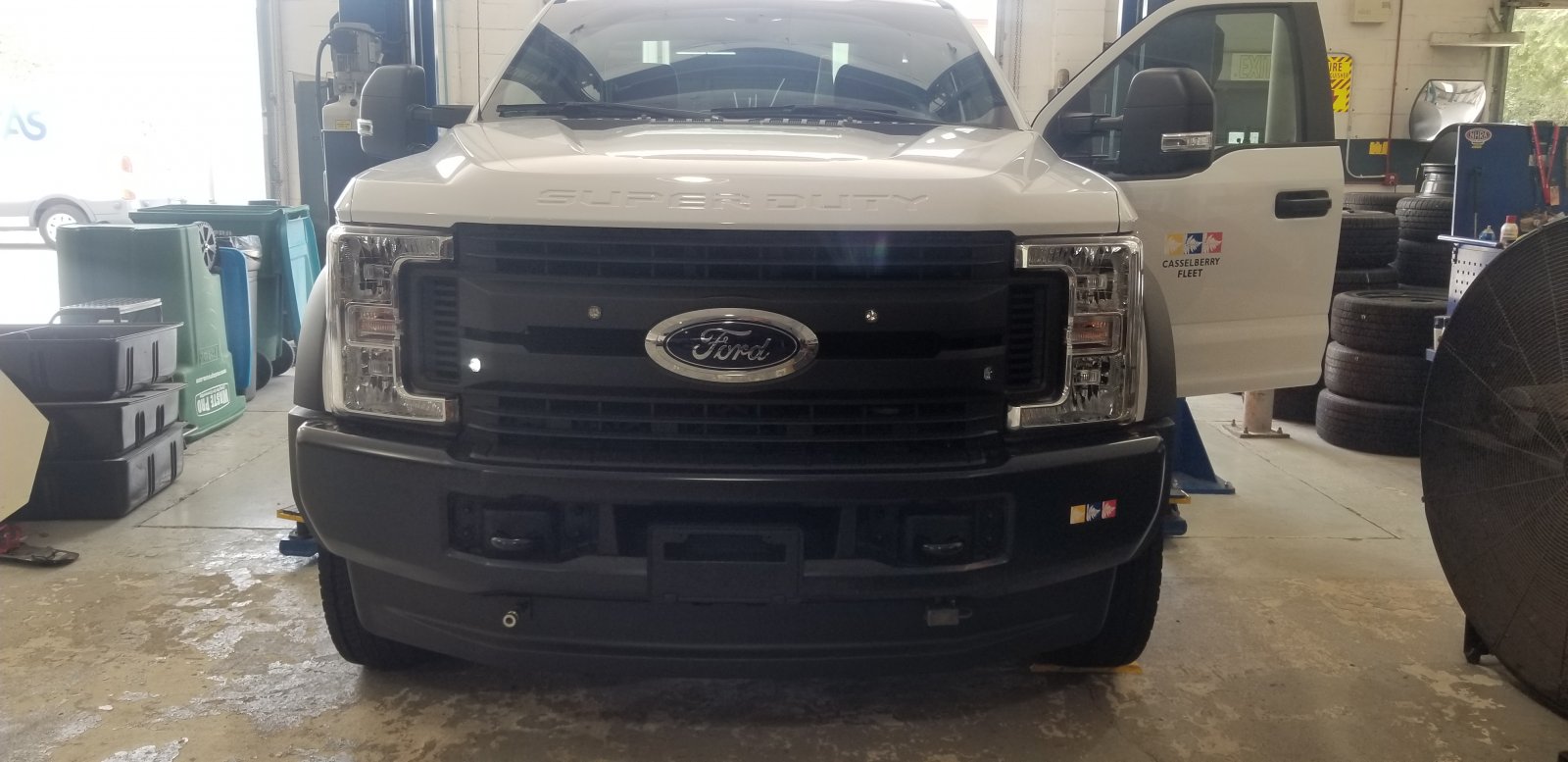

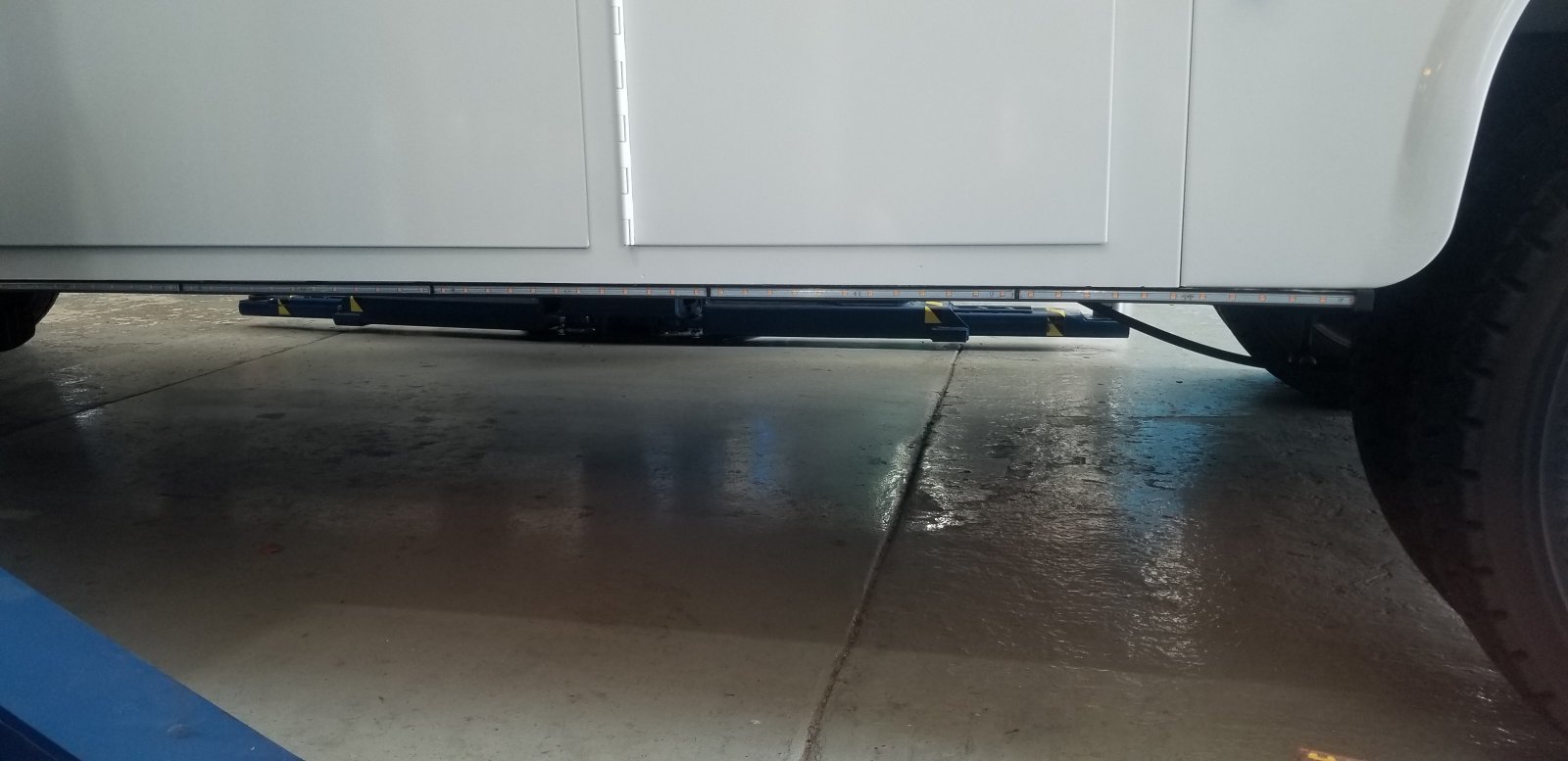

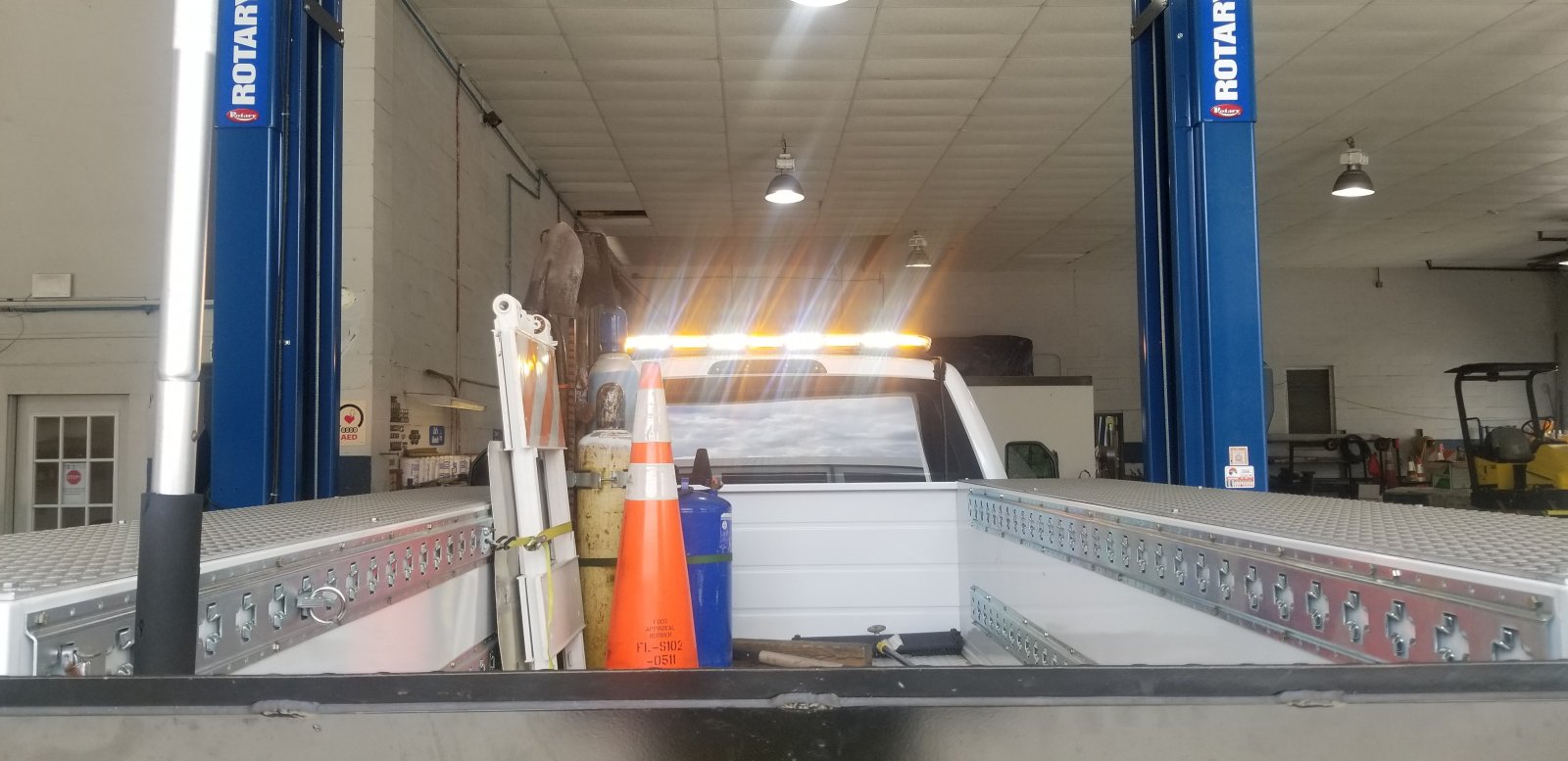

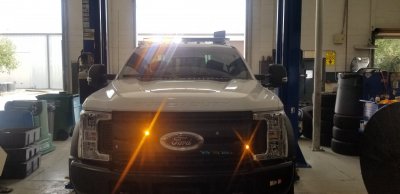

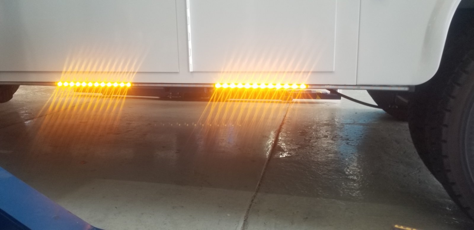

Pics and videos are on our 2019 F550 shop service truck. The fronts are the Code 3's, rear is Brookings, the side runners are Sound Off Signal (nLines), and the roof bar is also a Sound Off Signal (nRoads).
View attachment 253989 View attachment 253990 View attachment 253991 View attachment 253992 View attachment 253993
I have a MAJOR pet peeve with using HAWs as surface mounts. They are not engineered/designed to be used as such. They are designed to be used inside of OEM housings due to the fact they do not have any optics and are designed to use the optics of the OEM housing as a reflector. You might as well dump $110-160 down the toilet.
I like the attatchment. Sorry I missed something. I agree there are lights for hide a ways and lights that are not. If it is the the pic of the code 3 lights in the grille that are in question, I don't believe they are supposed to be used as hide a ways. They are to big. Yes only a 1" hole for install but the housing is too long for hide a way use. There are made for surface mounts. You can even get brackets to install them so not a surface mount The optics on these are pretty good. They have multiple patterns depending on usage, class 1, class 2 and and so forth. Depending on which pattern you use is to the brightness.
I have some short videos of the lights on but was having problems getting them on here. I was told I have to load to you tube to do this. Please let me know if there an easier way? Kind of seems like a bunch of extra steps to create a you tube account, to upload to that account just to reload to the forum. Maybe its a security thing on here to keep people from posting random stuff that's not appropriate, I don't know.

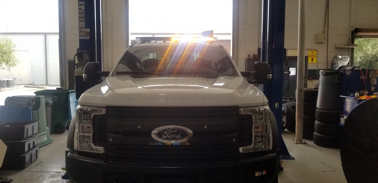

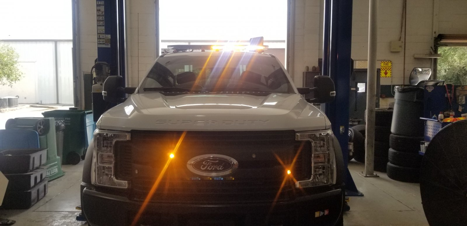

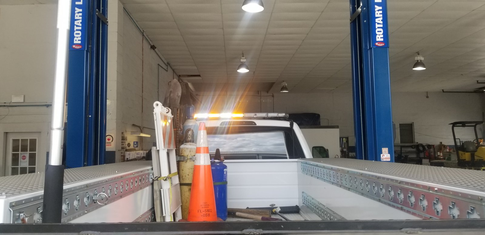

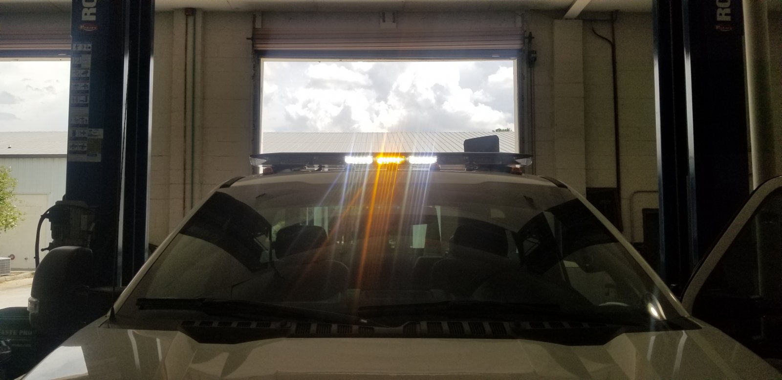

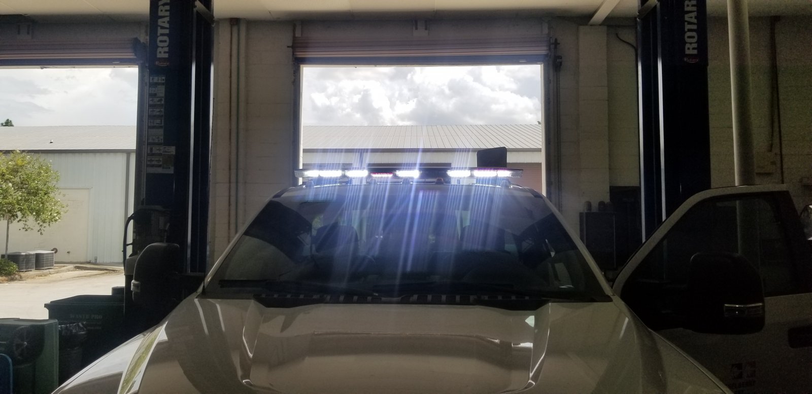

Sound Off Signal (nRoads) roof light bar. Amber and white, with traffic advisor, cruise lights (corners on only on dim), alley's (side whites) , take downs (front 2 white) and scene light which turns whole bar white. In the pic of the scene light there are not lights imperative, they drop out on the phone. (Weird). Kinda like looking at message board with phone camera, the message is constantly on and off, but its stationary looking at with your eyes.
20200804_150602.jpg 20200804_150649.jpg 20200804_150152.jpg 20200804_150203_001.jpg

More of the roof light bar, the ones in the grille are the Code 3's . 4 lamps in the grille, each lamp alternates between amber and white. Hard to get pic of those.
We use a Sound off Signal 6 head mini bar on the push bumpers of our PD Explorers and Tahoes. We also use them in umarked PD Explorers behind the grille. Model is an (nPower) 6 head, tri color with scene light. They flash red and blue then when scene light or take down function is activated the whole bar turns white. I am sure you can get them in white and amber as well. This light is very versatile. I will take pics of one of the red blue ones on Monday.
20200804_150031_003_saved.jpg 20200804_150031_006_saved.jpg 20200804_150031_009_saved.jpg 20200804_150031_004_saved.jpg

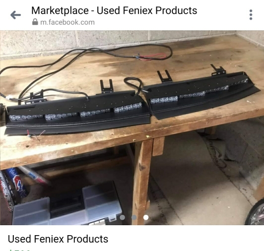

I won't lie, I ended up buying one of the Feniex Typhoon controllers used from a kid that was a volunteer firefighter and had lost his full-time truck driving job. I realize you guys advised against it. However he made me an excellent deal on the controller and a Kenwood radio. I considered buying the lights he had, but wasn't sure if I could change out the red leds. He claims that everything was less than 4 months old. Both came with the mounts, but not the homemade box. The Kenwood radio also came with a Kenwood speaker. I did not get a siren, but I also do not have a use for one (although I did see a few videos where you can play the Jurassic Park theme song, bad boys, Knight Rider theme, or the Ghostbusters ecto-1 siren so I may need one now lol). It's not exactly what I wanted, but for the price I won't complain. I believe I have decided to go with a Westin elite XD push bar so I can add one of the max winch trays. I will probably either add lights in the top channel cross bar or add some type of light bar. I would love to find an actual light bar that can be used as an off-road light but have the option for emergency lighting. I just don't want to spend a fortune. As for rear lighting, I considered doing some type of license plate mounted light. I currently have my El cheapo rocky pro strobe bars in the front and rear windows. The two 4-in white lights are barely noticeable through the tinted back glass. The two 8-in white bars are fairly noticeable through the front windshield. They may not be ideal, but they should work temporarily until I find some actual quality lights.
