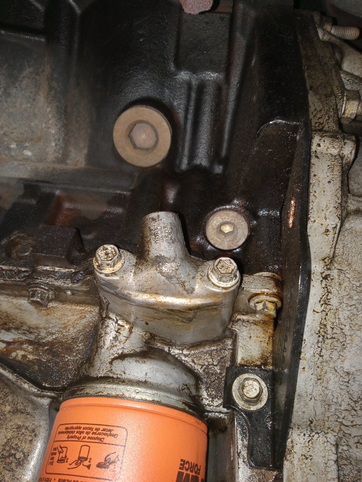

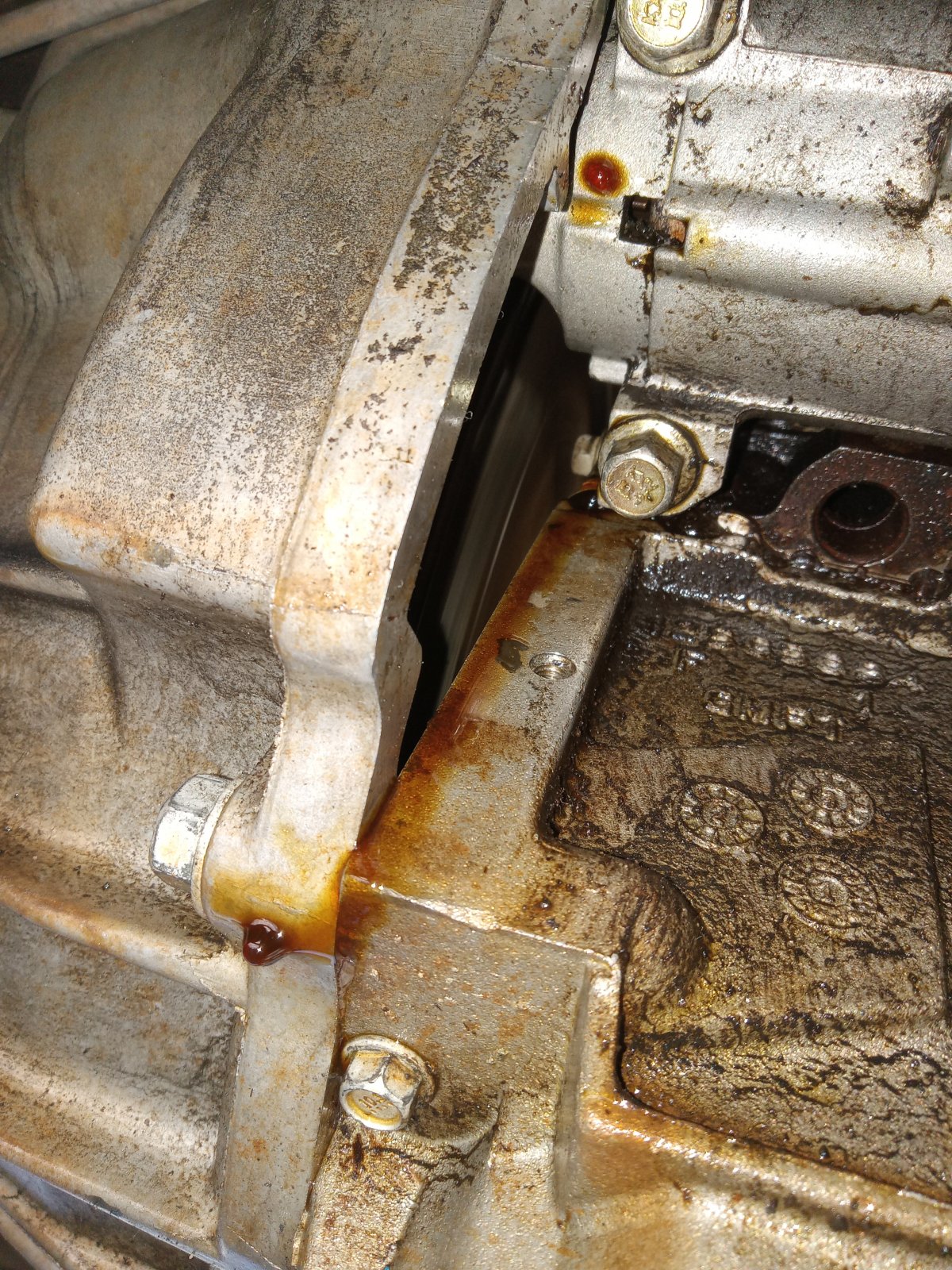

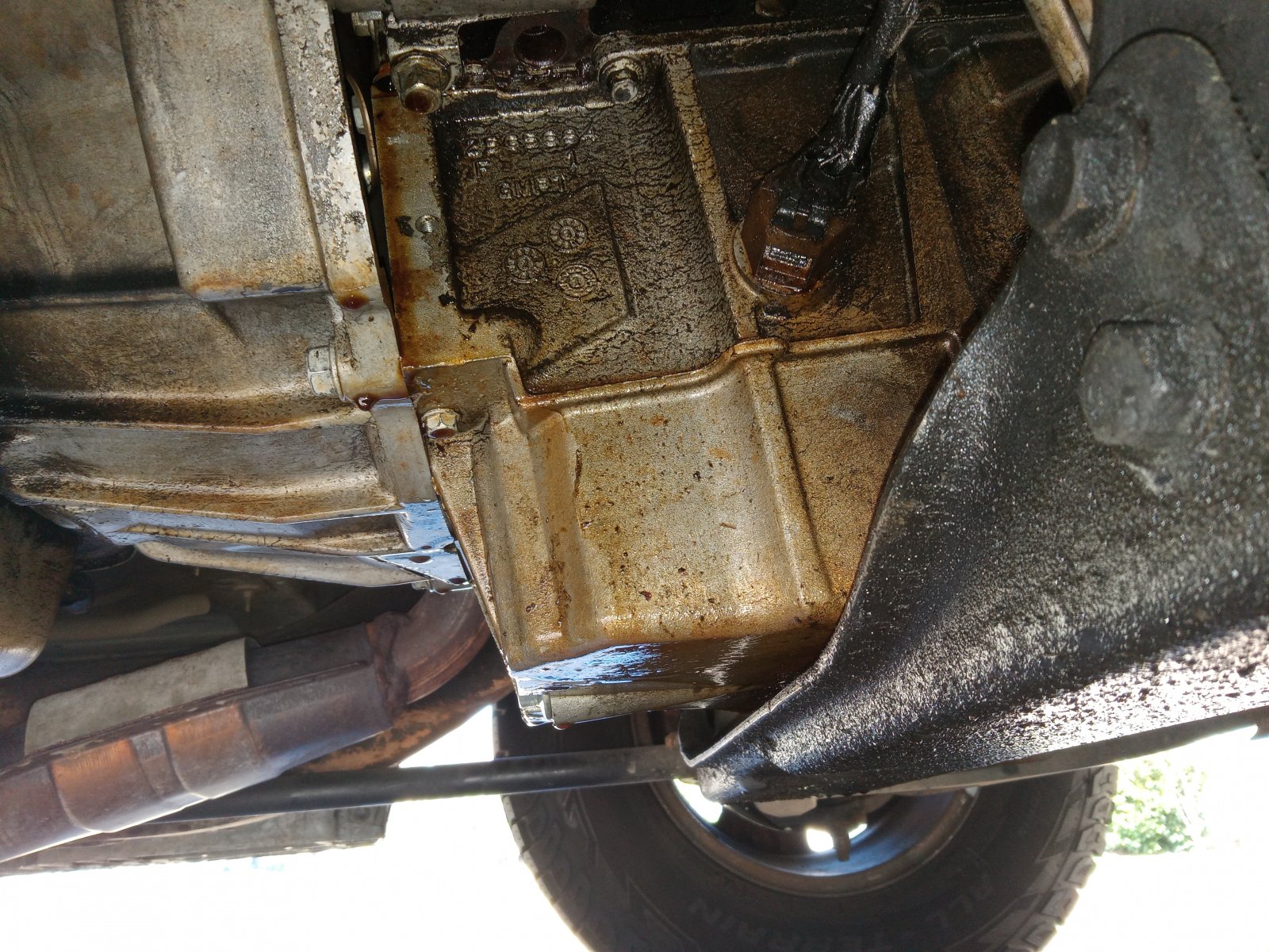

I have the same leak. It seems like the rms is leaking and the oil is running along the lip of the oil pan and then dripping out at both corners: under the oil filter and under the starter. Oil pan is also leaking from the front but the deluge is definitely rear engine, unfortunately. Pretty sure it the rms. I've just been in denial because I'm not looking forward to wrestling the trans. Please let me know what you find.

I'm in the same boat. Just going to keep dumping oil in it. I envy you guys with the 2WD. I might attempt it myself if mine was.

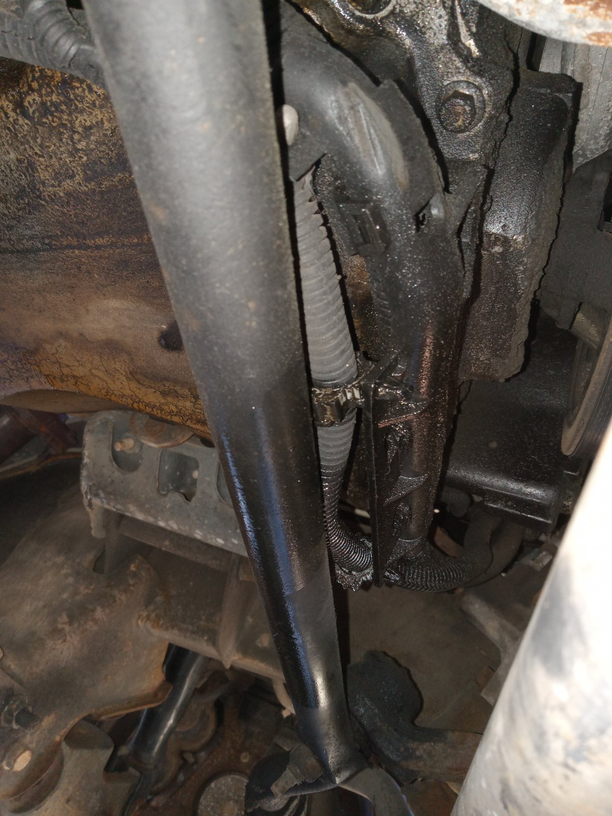

I can't keep putting oil in it at $8/qt. I'll never have to change the oil but it's a hellova mess and I worry about it lighting up on the exhaust. Glad I'm 2WD, too. Gonna be replacing the oil pan gasket when I drop the trans.
Looks like the front seal too there. And if your going that far the timing chain and stuff.
