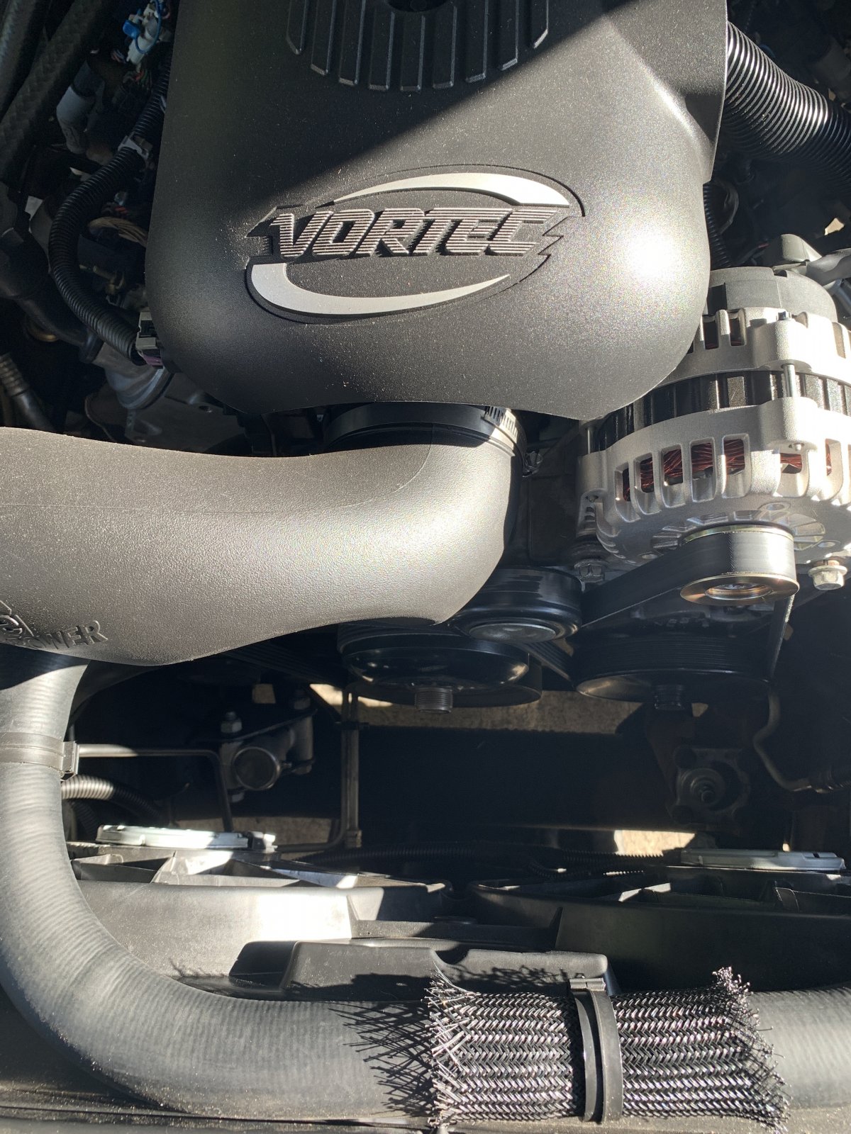

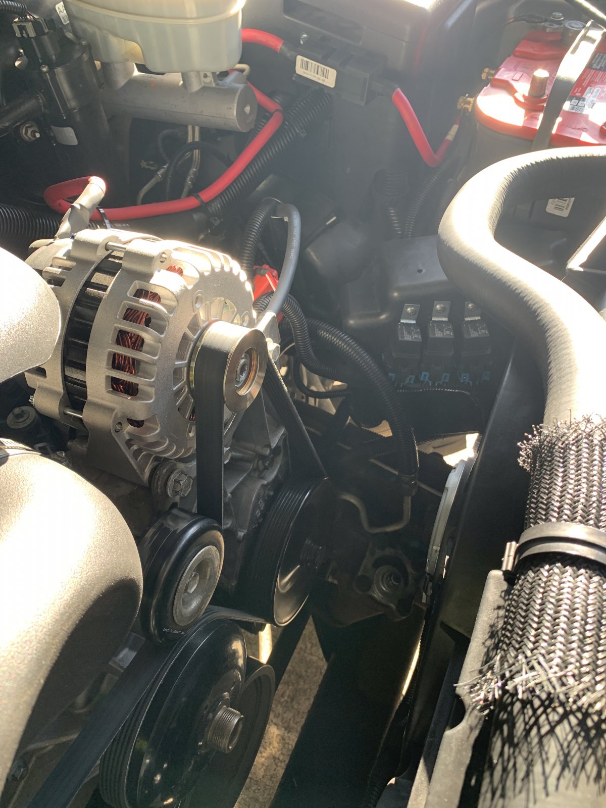

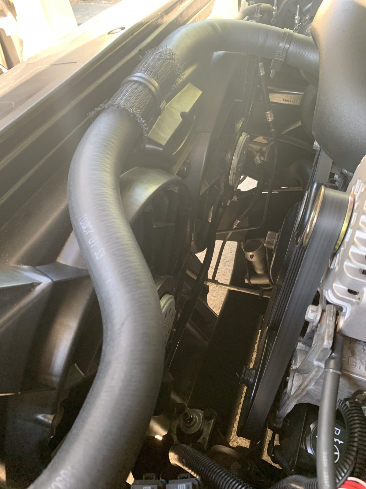

Those fan motors look like twin 700 watt? They move massive air! Im running one 500 on the 5 blade and a 700 on the 7 blade. I have the other 700 sitting here and am so tempted to try them both again, The first time i wasnt using an overdrive pulley and at an idle the current draw from the fans going to high glitched my radio. I now run the denso 220 amp alt with 2 inch overdrive and feel it is worth trying again. Your system is proof it works!

Yup took doin a little homework, and some investment put I love my Tahoe and it’s not going anywhere so it was all very much worth it to me.
